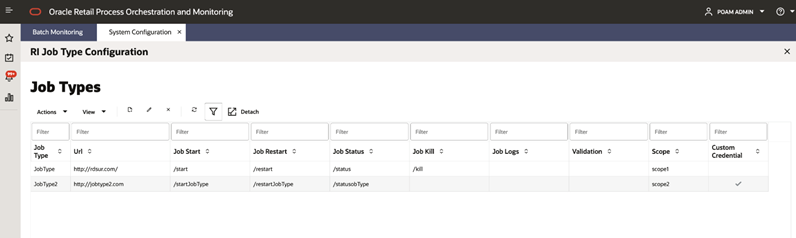

Job Types
Job Types window displays a table of configured job types. The user can edit or delete an existing row or create a new job type.
See the “Generic ReST Jobs” chapter of the POM Implementation Guide for additional details on setting up custom schedules with custom job types.
Figure 2-36 Job Types Table
Each row contains the fields:
Job Type - A short, alphanumeric identifier of the job type. This typically reflects the system or application where associated jobs are to be executed (for example, RDS).
URL - Base URL for endpoints at the destination system where batch is to be Invoked (for example, https://server/services/batch).
Job Start - Endpoint for invoking the execution of a job.
Job Restart - Endpoint for restarting the execution of a job after failure.
Job Status - Endpoint for POM to fetch the status of a started job.
Job Kill - Endpoint for terminating the execution of a running job.
Job Logs - Endpoint for fetching the log(s) for a job.
Validation - Endpoint for validating that the endpoints are reachable.
Scope - Authentication scope for accessing the above endpoints.
Custom Credential - Displays a tick mark if the credential is custom created by the user for that job type. Else, blank.
