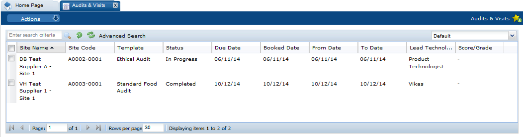

To work with audits and visits, select the Audits & Visits option from the Supplier drop-down list. The Audits & Visits tab opens.
Figure 6-1 Audit & Visits Page
This figure shows the Audits & Visits page.
The following columns are shown:
  • Site Name
  • Site Code
  • Template
  • Status
  • Due Date
  • Booked Date
  • From Date
  • To Date
  • Lead Technologist
  • Score/Grade
To edit an entry, select the row and then the Edit action. A tab opens in edit mode. For information on the fields shown for this tab, see Table 6-1.
To view details on an audit, double-click a row. A tab opens with the details.

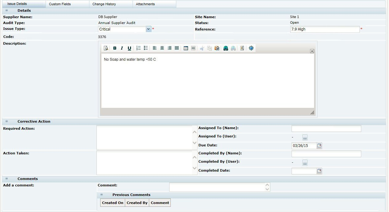

To see the list of issues from the audit/visit, select the Issues subtab.
Figure 6-3 Audit/Visit Issues Page
This figure shows the Audits/Visits Issues page.
The following subtabs are available. Select a subtab to see the information for the issue:
  • Issue Details
  • Custom Fields
  • Change History
  • Attachments: List of documents attached to the issue.
