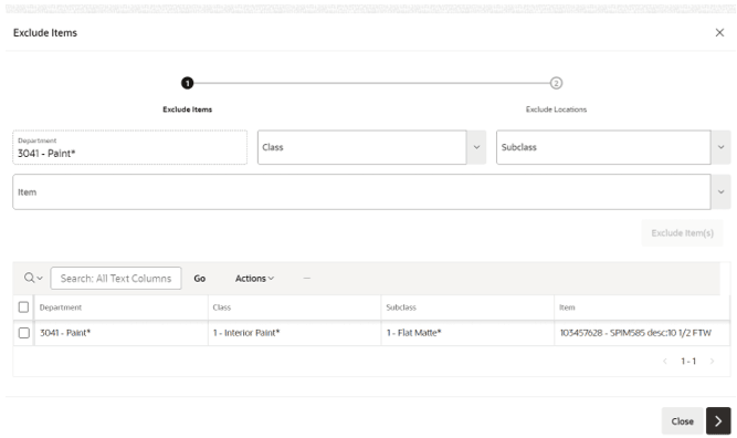

  1. Choose the items to exclude:
    1. Enter the information for the class, subclass, and/or item to exclude.
    2. Click Exclude Item(s) to add the item to the list.
      If required, it is possible to remove items before submitting directly on the table.
      This image shows the Exclude Items screen.

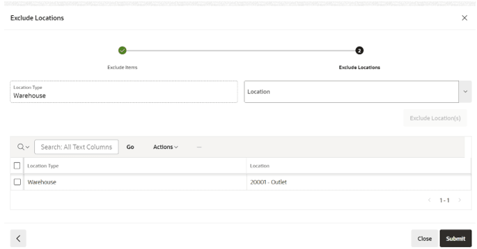

    3. Click the > icon, to add the locations to exclude.
  2. Enter the information for the location type and location to exclude:
    1. Click Exclude Location(s) to add the location to the list.
      If required, it is possible to remove locations before submitting directly on the table.
      This image shows the Exclude Locations screen.
    2. Click Submit to add the exclusions to the Exclusions.
