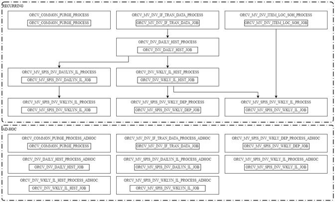

Batch scheduler details with all batches, dependencies and frequencies can be downloaded following the steps in the Supply Chain Hub Frameworks section.
Schedule Overview
Figure 15-1 Inventory and Sales Batch Schedule Overview

Materialized Views
This application requires some results to be materialized in tables using the Materialized View Framework described in the Supply Chain Hub Frameworks section and below is the list for this application.
ORCV_MV_SPIS_INV_DAILYN_IL
Contains the item-location stock on hand and sales by units’ values in a daily basis.
Pre-Dependencies: ORCV_INV_DAILY_HIST_JOB
Post-Dependencies: ORCV_MV_SPIS_INV_WKLYN_IL_JOB
Frequency: Ad-hoc, Nightly
Contains the item-location stock on hand and sales by unit’s values from the n weeks.
Pre-Dependencies: ORCV_MV_SPIS_INV_DAILYN_IL_JOB
Post-Dependencies: None
ORCV_MV_SPIS_INV_WKLY_DEP
Departments with most sales by units from the last week. It will contain 5 rows (the top 4 performers plus one row for all the others).
Pre-Dependencies: ORCV_INV_WKLY_IL_HIST_JOB
ORCV_MV_SPIS_INV_WKLY_IL
Contains item-location stock on hand and sales by unit’s values from the last weeks.
Pre-Dependencies: ORCV_INV_WKLY_IL_HIST_JOB, ORCV_MV_INV_ITEM_LOC_SOH_JOB
