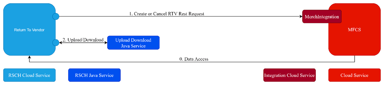

Integration by Module
Figure 14-3 Return to Vendor Integration by Module
Step Description
0 RSCH Data Access of MFCS data
1 Return to Vendor publishes Approved or Cancelled RTVs to MFCS MerchIntegrations Rest Service.
2 Return to Vendor calls Upload Download Java Service to transform files, depending on the request details, Upload Download Java Service might need to callback to Return to Vendor to get more details.
