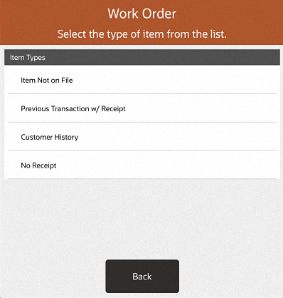

The system prompts for the source of information about the item that is referenced in the work order.
Figure 14-5 Work Order Type
Select one of the following options:
Current Transaction: The item is in the current sale transaction. This option is only available if there is at least one item in the current sale transaction. See Work Order Item - In the Current Sale Transaction.
Item Not on File: The item requiring work is not in the system. See Work Order Item - Item Not on File.
Previous Transaction with Receipt: The item is identified on the receipt from a previous transaction. See Work Order Item - Using Original Transaction Receipt.
Customer History: Find the item by searching the customer's previous purchase transaction history. See Work Order Item - Customer History.
No Receipt: The item has no receipt available or is not referenced on a receipt. See Work Order Item - No Receipt; Manual Item Entry.

Add Item
Select this option to add additional items to the work order.
Select Add Item.
The system prompts for the source of information about the new item to be referenced in the work order.
Refer to the work order process beginning with step 5 for more information.
Enter all information for this new item when prompted. The system adds the item to the current work order.
