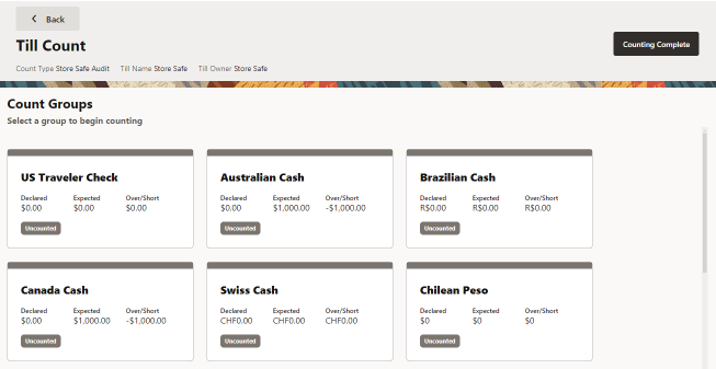

From the Till menu, select the Store Safe Maintenance option.
From the Store Safe Maintenance menu, select the Store Safe Audit option.
Figure 57-1 Store Safe Audit
At the Count Summary screen, select the tender type you want to count.
Depending upon the configuration of your system, the over/short amounts as shown above may not be displayed.

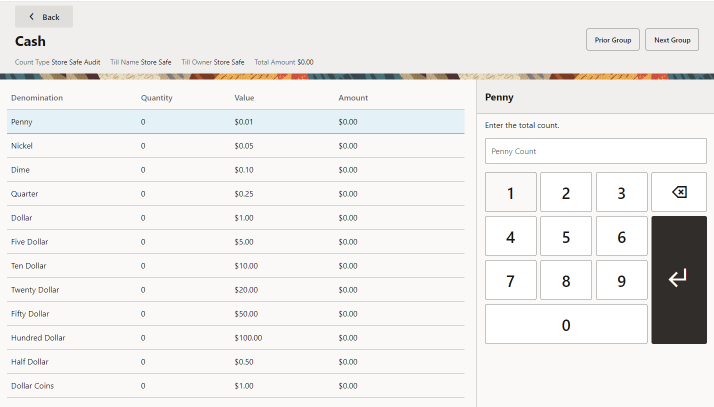

If Safe Bag functionality is activated the system displays a list of Safe Bags that are in the store safe at the prior store safe close.
Figure 57-2 Store Safe Audit Count
Enter each value as required. The tender type you select, and your system's configuration determine the type of count you must perform.
After you complete the count for the selected group, select the Next Group option from the Context Menu, and repeat this step for additional groups that you want to count.
After you count all groups that you want to audit, select the Back option to return to the Count Summary screen.
When you have counted all the tenders in the store safe, select Counting Complete to complete the audit.

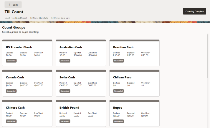

Preparing the Bank Deposit using a Safe Bag
From the Store Safe Maintenance menu select, the Bank Deposit option.
Figure 57-3 Store Safe Bank Deposit
Depending upon your store policy, you may be prompted to select the bank where the money should be deposited. If prompted, select a safe from the list and select OK.
If Safe Bag functionality is activated the system displays a list of safe bags that are in the store safe at the prior store safe close.

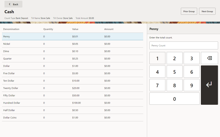

Figure 57-4 Store Safe Bank Deposit Count
Enter the count for the denominations as required.
Use the Prior Group and Next Group options to move between tenders.
When all counts are done, select Counting Complete.

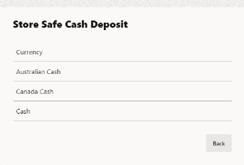

Store Safe Cash Deposit using a Safe Bag
Once the Store Safe has been reconciled, you cannot make cash deposits into it.
During the day, there may be times when you must deposit cash into the store safe. Use this procedure when a cash deposit is to be made into the store safe.
From the Store Safe Maintenance menu, select the Store Safe Cash Deposit option
If your store is configured for foreign cash currency tenders to be given as change, select the type of currency you are depositing.
Figure 57-5 Store Safe Cash Deposit

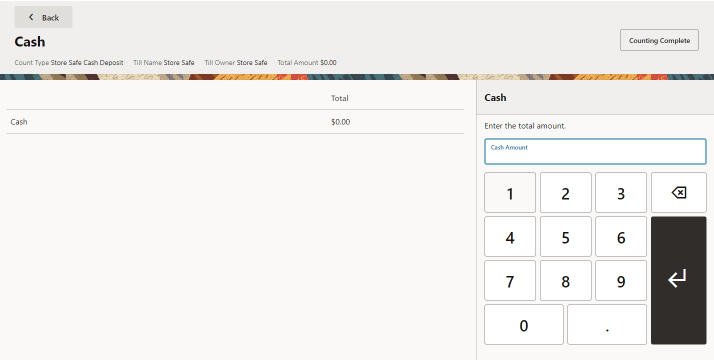

Figure 57-6 Cash Deposit Count
When all counting is done, select the Counting Complete option from the Context Menu.
Scan or manually enter the Safe Bag ID.
Enter the amount and select Return to confirm the amount.
POS prints a receipt for the deposit and returns to the Store Safe Maintenance menu.
