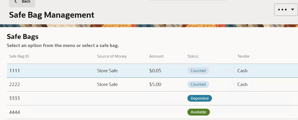

Safe Bag Management
The safe bag management screen (available on tablet/thin and desktop) is where safe bags are created and managed.
Figure 57-1 Safe Bag Management Screen

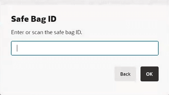

A store first needs to create/add safe bags for use in their store. They will select Create Bag and scan the safe bag - they can do this for all the safe bags they want to use. They will do this any time they also need to add more safe bags for use in their store.
Figure 57-2 Create Bag Option
Create Bag Option
Figure 57-3 Safe Bag ID
Safe Bag ID
If they scan a safe bag that is already in use in their store, they will be prompted the bag is already in use. Once a safe bag is created the user can add money into the safe bag to be used in other cash functions such as bank deposit or cash transfers.

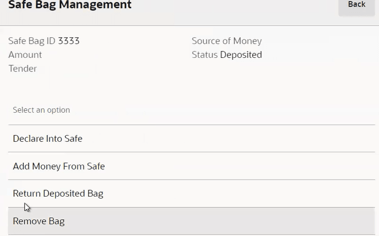

Figure 57-4 Safe Bag Management Options
They would select the function for Add Money From Safe. By putting money in safe bags using the Add Money From Safe function these bags can be used during the bank deposit or cash transfer process. During a cash transfer the process remains as it does today but at the start of the function the user is asked to scan the safe bag that the money is coming from. All the money that is in a safe bag is used in the function - for example if the safe bag has $200 in it (determined during the Add Money From Safe process) all of the funds will be used during the process, for example cash transfer. If a cash transfer is done all $200 will be transferred. There is no option to use only half the money. That applies any time money is used in a safe bag. Also, safe bags do not allow users to mix currency types. One currency per bag. For example, if US Cash is selected as the currency type during the Add Money From Safe process that is the only currency type that is allowed in that bag. Other currency types can be used in other safe bags - but one currency type per bag. When a safe bag is used in a cash transfer the safe bag is now empty and in "available" status that allows it to be used again.

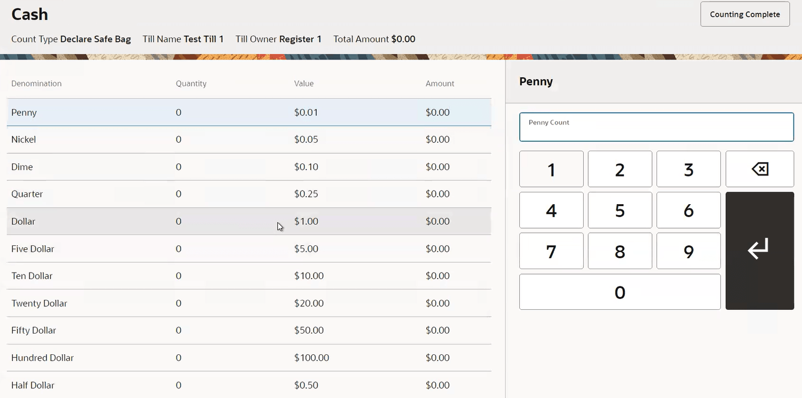

    Figure 57-5 Declare Safe Bag
    Declare Safe Bag
    All safe bags used during a cash pick up (whether it was counted at the cash drawer or not counted) must be declared and counted because until it is declared the cash drawer does not know how much money was taken - that cash is still a part of the drawer until it is declared. If the store was configured to count the money at the cash pickup and the money counted during the declaration process did not match, the standard Xstore discrepancy process would be done. Also, during the register close process any safe bags that are Undeclared must be counted first - Xstore would display an error that there are safe bags that need declared first. For example, if a store was in till accountability mode and the user was going to count the till, any safe bags that had been used in cash pickups must be counted because that money is still, technically, in the drawer until it is declared into the safe from the safe bag. Also, during a till audit - all safe bags must be declared that had been used for cash pickups from that till. The cash drawer does not know how much money was pulled during cash pickups until the safe bags are declared.
Remove Safe Bag is used when a safe bag is no longer going to be used in the store. For example, the plastic tube cracked or the zipper on a safe bag broke - the store can remove these bags from use using this function. Any safe bag that is removed can be created again if desired. For example, a safe bag with a broken zipper has been fixed - the store can use the Create Safe Bag function and put the safe bag back into use in the store.
The function Return Safe Bag is used when a safe bag that was used in a bank deposit physically comes back to the store. A good example is that during a bank deposit the safe bag was dropped into the store's bank (the brick and mortar bank down the street) and since the bag was dropped into the overnight drop box it may not come back to the store until a manager goes to the physical bank and picks it up. Until they come back with the safe bag it will remain in Deposited status. By using Return Safe Bag function the bag will now be put into Available status and can be used again in the store.
The safe bag management screen lists all safe bags in use and their status.
  • Create a safe bag - add safe bags to be used in the store.
  • Remove safe bag - bag doesn't come back from bank or has hole in it.
  • Declare into Safe - for counted and uncounted cash pickups. During this process the money in the safe bag is counted. Xstore will handle discrepancies in the standard way.
  • Add Money From Safe - normal till count - no partial moving of money.
  • Return Safe Bag - it's back from bank and ready for use.
Table 57-1 Safe Bag Status
Safe Bag ID Status Source of Funds Amount Currency Comments

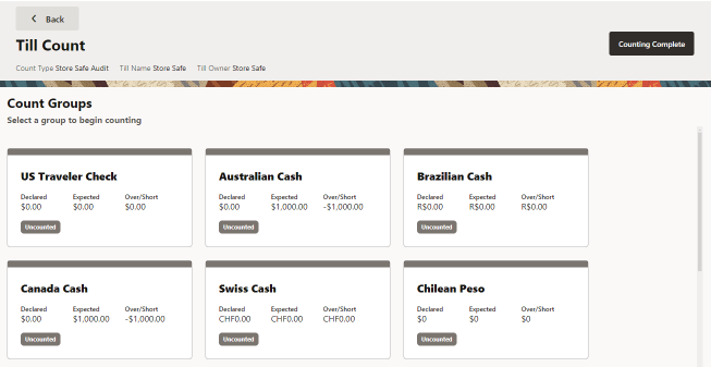

Store Safe Auditing with a Safe Bag
The store safe audit function is used to count the tenders in your store safe. This audit function provides the capability to select a tender type, record its total current value, and compare that value with the system-recorded amount for the same tender.
The system calculates and displays any difference (over/short) between the expected amount and the actual amount.
An audit does not change the expected amount in the store safe.
  1. From the Till menu, select the Store Safe Maintenance option.
  2. From the Store Safe Maintenance menu, select the Store Safe Audit option.
    Figure 57-6 Store Safe Audit
    Store Safe Audit
  3. At the Count Summary screen, select the tender type you want to count.
    Depending upon the configuration of your system, the over/short amounts as shown above may not be displayed.

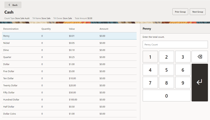

  4. If Safe Bag functionality is activated the system displays a list of Safe Bags that are in the store safe at the prior store safe close.
    Figure 57-7 Store Safe Audit Count
  5. Enter each value as required. The tender type you select, and your system's configuration determine the type of count you must perform.

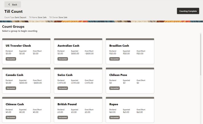

Preparing the Bank Deposit using a Safe Bag
  2. From the Store Safe Maintenance menu select, the Bank Deposit option.
    Figure 57-8 Store Safe Bank Deposit
  3. Depending upon your store policy, you may be prompted to select the bank where the money should be deposited. If prompted, select a safe from the list and select OK.
  4. If Safe Bag functionality is activated the system displays a list of safe bags that are in the store safe at the prior store safe close.
  5. At the Count Summary screen, select the tender type you want to count.

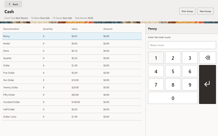

    Figure 57-9 Store Safe Bank Deposit Count
    Enter the count for the denominations as required.
  6. Use the Prior Group and Next Group options to move between tenders.
  7. When all counts are done, select Counting Complete.

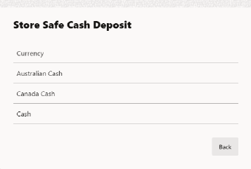

During the day, there may be times when you must deposit cash into the store safe. Use this procedure when a cash deposit is to be made into the store safe.
  2. From the Store Safe Maintenance menu, select the Store Safe Cash Deposit option
  3. If your store is configured for foreign cash currency tenders to be given as change, select the type of currency you are depositing.
    Figure 57-10 Store Safe Cash Deposit

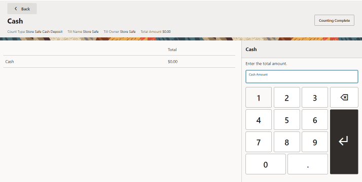

  4. At the Count Summary screen, select the tender type you want to count.
    Figure 57-11 Cash Deposit Count
    Cash Deposit Count
  5. When all counting is done, select the Counting Complete option from the Context Menu.
  6. Scan or manually enter the Safe Bag ID.
  7. Enter the amount and select Return to confirm the amount.
  8. POS prints a receipt for the deposit and returns to the Store Safe Maintenance menu.
