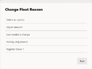

  4. The system prompts for the reason you are changing the float amount. Select a reason from the list.
    Figure 56-1 Change Float Reason List
  5. Depending upon the reason you selected, you may be prompted for additional information/comments. If prompted, enter the information as required and select OK.

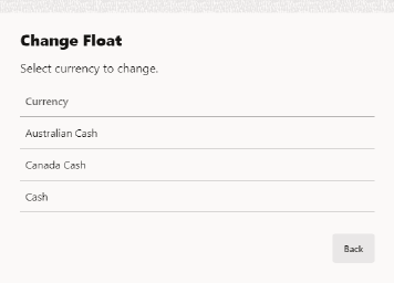

    If your store is configured for foreign cash currency tenders to be given as change, select the type of float tender from the list.
    Figure 56-2 Change Float - Currency List

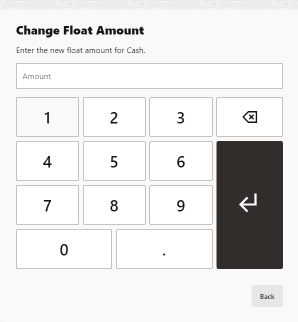

  7. The system prompts for the new float amount for the selected tills. Enter the new float amount for the tills in the list and select OK.
    Figure 56-4 New Float Amount Prompt

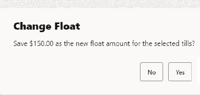

  8. The system prompts to confirm the new float amount for the selected tills. Select Yes to accept the new float amount. The system updates the float amount to the new value for the selected tills and returns to Global Navigation.
    Figure 56-5 Confirm New Float Amount Prompt

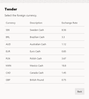

  4. Oracle Retail Xstore POS displays a list of foreign currencies. Select the currency whose exchange rate you are changing.
    Figure 56-6 Foreign Currency List

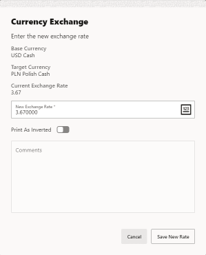

  5. The system displays the current information for the currency you selected. Enter the new exchange rate and a comment, then select Save New Rate.
    Figure 56-7 New Exchange Rate
    New Exchange Rate

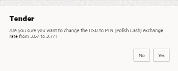

  6. Oracle Retail Xstore POS prompts whether to change the exchange rate. Select Yes to continue.
    Figure 56-8 Confirmation Prompt
    Confirmation Prompt

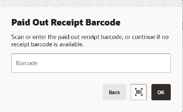

  4. The system prompts you to enter a paid out receipt barcode. If you are now placing funds back into the till from a previous paid out transaction and you have the receipt, scan or enter the barcode and select OK. Otherwise, select OK to bypass this prompt.
    Figure 56-9 Paid Out Receipt Barcode Prompt

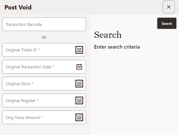

  4. At the Post Void prompt, scan or enter the transaction information and select Search to continue.
    Figure 56-14 Post Void Prompt
    Post Void Prompt

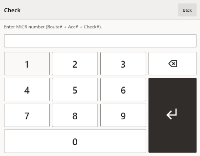

  5. If a check tender was selected in Step 3, enter information about the check:
    Figure 56-15 Check Tender
    Check Tender
    • Enter the check MICR number, then select the Return key.
    • Enter the Check number, then select the Return key.
    • Enter the state or province that issued the ID being used to verify the customer's identity, then select OK.
    • Enter the ID number, then select OK.

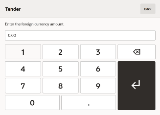

  6. Enter the amount of the incoming tender.
    Figure 56-16 Tender Amount
    Tender Amount
