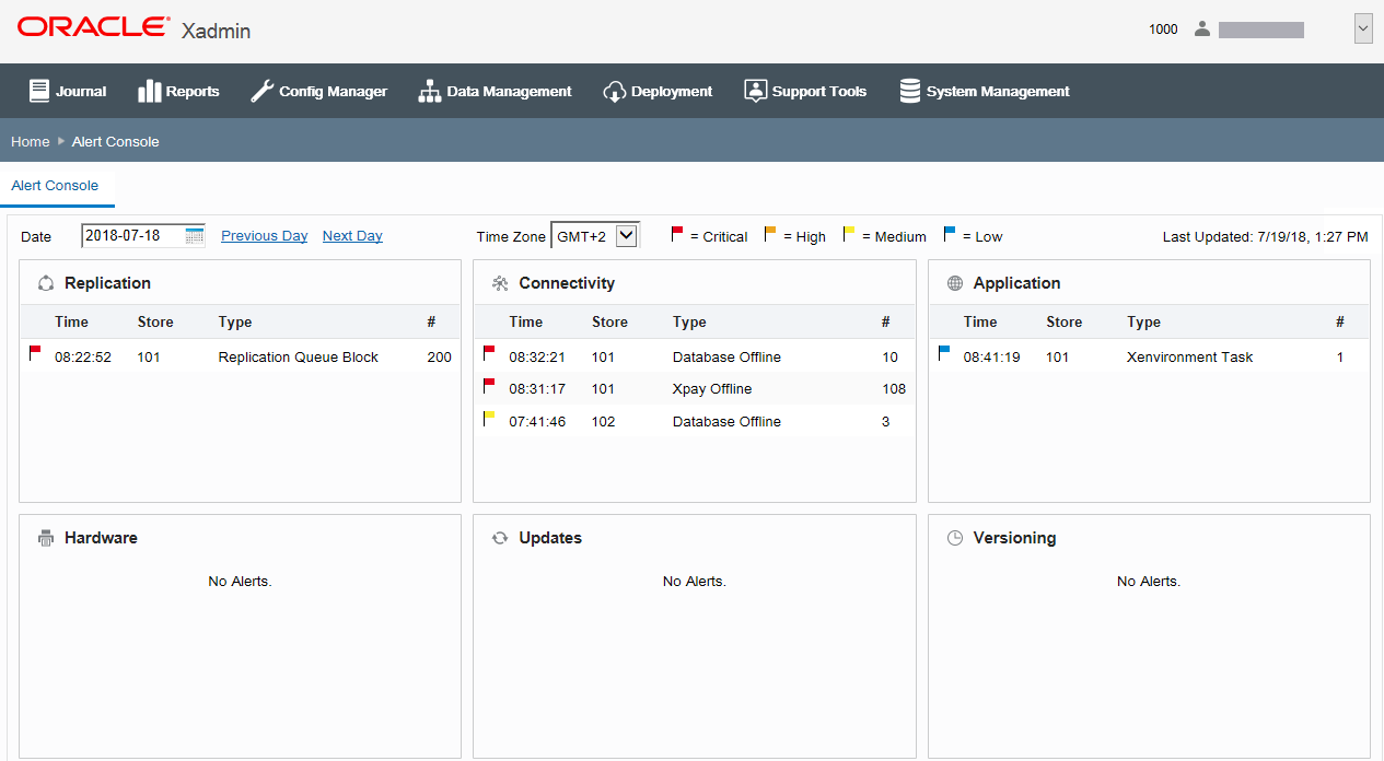

  2. The initial Alert Console page provides summary-level information at a glance about any issues at the stores in your organization requiring your attention.
    The system defaults to the current date and shows the date and time the Alerts Console was last updated.

    To review alerts from previous dates:
    • enter the date in the Date field, or select a date from the calendar,
    • or use the Previous Day and Next option.

If there are any alerts, the console window will show the following information:
  • The severity of the event: Critical, High, Medium, Low.
  • The time the event was logged.
  • The store where the event occurred.
  • The type of event.
  • The number (#) of times the event occurred.

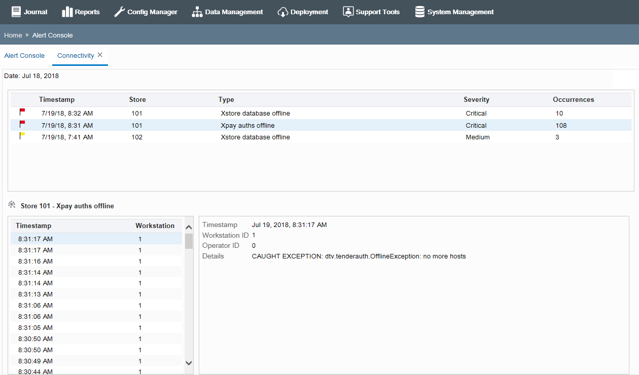

  • Data source offline: A ping failure or data access error occurred. As a result the data source will not be used. Information returned includes datasource name, scope (WAN/LAN), and cause. (DB Offline)
  • Payment system offline: A payment systems host (Xpay) could not be reached. Information returned includes the message, stack trace, and destination IP/Host. (Xpay Offline)
  • Order broker service offline: The order broker host (Oracle Retail Order Broker Cloud Service) could not be reached. Information returned includes the message, stack trace, and destination IP/Host. (Oracle Retail Order Broker Cloud Service Offline)
  • Order broker service error: An error occurred during the order update process. Information returned includes message and stack trace. (Oracle Retail Order Broker Cloud Service Error)
  • Service error: An error occurred while calling a web service. Information returned includes message, stack trace, and destination IP/Host. (Service Offline)
  • Event log reporting error: An error occurred with the end-point Oracle Retail Xenvironment uses to report event log errors to Xcenter/Oracle Retail Xstore Office. (Evtlog Error)
    Oracle Retail Xenvironment uses this end-point to communicate any problems directly to Xcenter.
  • Xstore register offline: A register (Xcenter client) has not sent a status update in "X" minutes. Information returned includes Store # and Reg #.

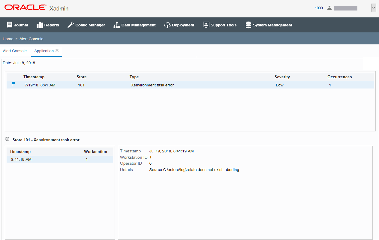

  • Xenvironment Task: Error message from Oracle Retail Xenvironment related to atoms and chains. (Xenv Task)

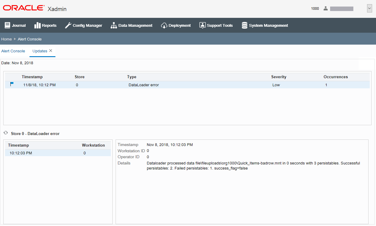

  • DataLoader error: A failure occurred while loading a download file. Information returned includes the message. (DataLoader)

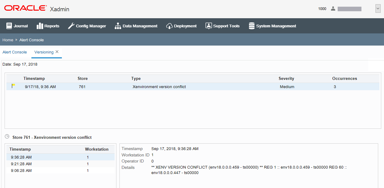

  • In store version conflict for Xstore: A single retail location has multiple versions of the Oracle Retail Xstore Point-of-Service application running at the same time. Information returned includes versions by register. (Xstore Conflict)
  • In store version conflict for Xenvironment: A single retail location has multiple versions of Oracle Retail Xenvironment running at the same time. Information returned includes versions by register. (Xenv Conflict)
  • In store version conflict for Oracle Retail Xstore Office configs: A single retail location has multiple versions of configs running at the same time. Information returned includes versions by register. (Config Conflict)
