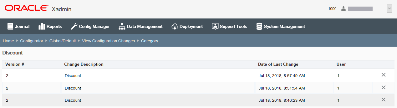

Click the Delete icon associated with the configuration change you want to remove.
Figure 5-63 Configuration Changes Page - Delete Option
When prompted to confirm you want to delete this change, click Yes to remove the configuration change from the configuration update.
