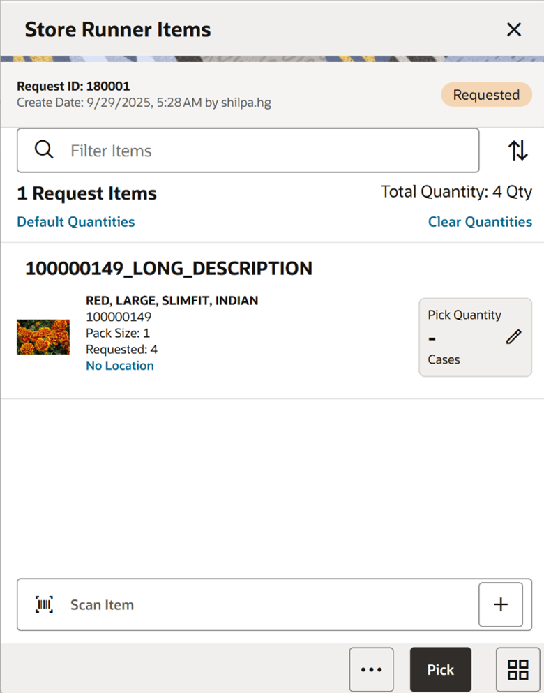

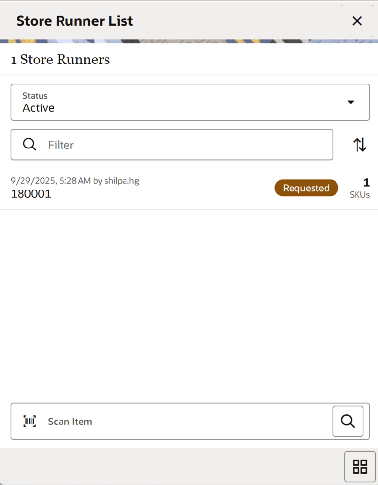

Store Runner
Moving of items from the back room to the sales floor based on the request from the sales staff using the scan list dialog.

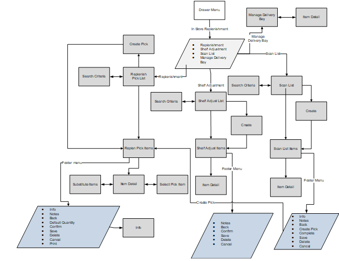

Screen Flow
Figure 10-2 In Store Replenishment Mobile Screen Flow
You can access the In Store Replenishment dialog from the Drawer menu on the mobile application.
The In Store Replenishment module in the mobile application contains Replenishment, Scan List, Manage Location Inventory and Store Runner features..

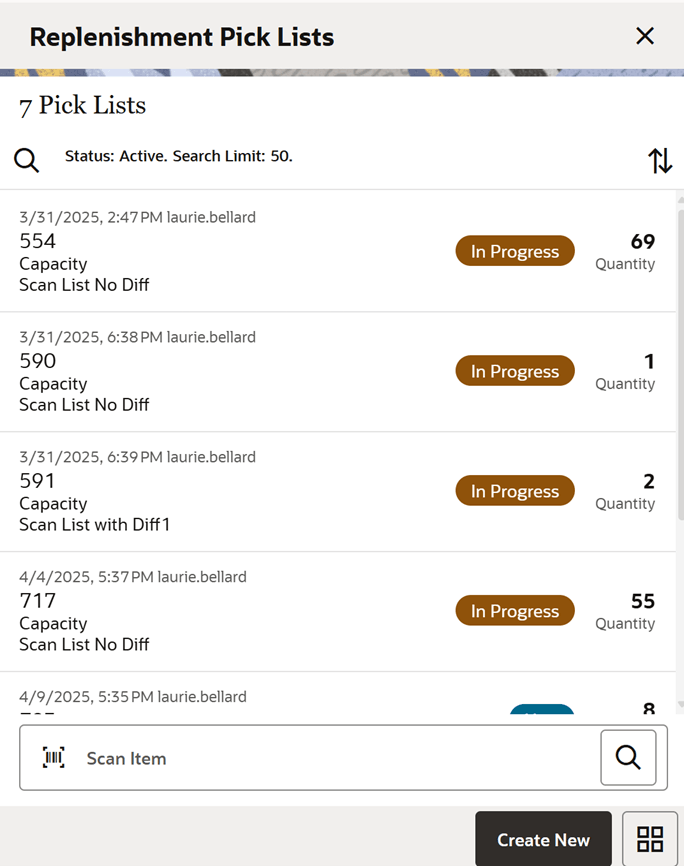

The Replenishment Pick List screen can be accessed from the In Store Replenishment menu. When you access this screen, the system will by default list the New and In Progress pick list.
The Replenishment Pick List screen allows you to create a new pick list by selecting the Create New button. You will be taken to the Create Replenishment Pick screen upon selecting the Create New option on this screen if you have proper permissions. All types of replenishment lists are displayed with the total quantity to pick. When you select a replenishment list the system takes you to the Replenishment Pick Items screen.
You can filter the list by selecting the pair of glass and providing the filter criteria.
The following fields are shown in the list for you to identify the pick list:
  • ID -The unique replenishment id created by the system.
  • Total number of quantities in the pick list.
  • Status of the pick.
  • Pick Type
    • Four types of in store replenishment methods can be defined here: Capacity, Display, Gap and Sale.
  • Updated User, Create Date and the Description of the replenishment pick.

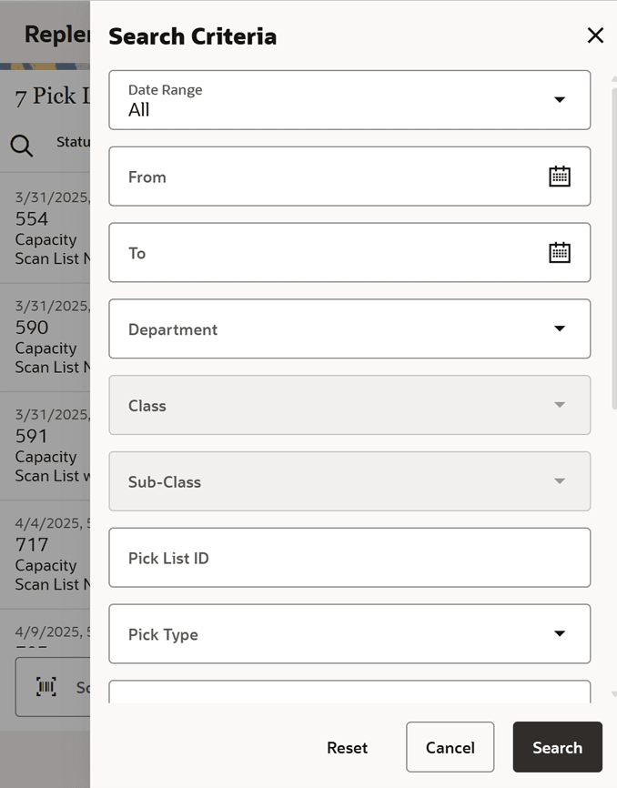

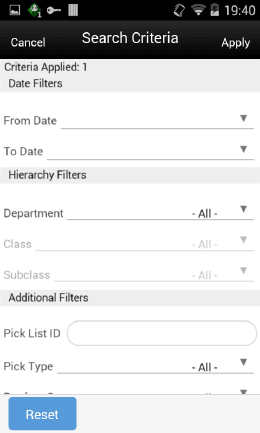

The Replenishment List Search Criteria screen can be accessed from selecting the magnifying glass from the Replenishment Pick Lists screen. This helps to limit the search on Replenishment Pick List screen through date, hierarchy, and various additional filters which includes search fields Pick List Id, Pick type, Product Group, Mode, Scan List, Item, Status and so on.
Once done with applying the search criteria, you will return to the Replenishment Lists screen with the results filtered based on the given criteria.

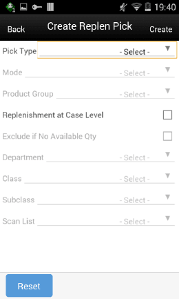

Figure 10-5 Create Replenishment Pick Screen
The Create Replenishment Pick screen is used to create a new shelf replenishment pick list based on various criteria specified by you. This screen is accessed by selecting the Create button from the Replenishment Pick List screen. You can create four different types of shelf replenishment lists: Capacity, Sales, Display, and Gap based replenishment lists. Based on the replenishment list type selected, some fields will display while others will not.

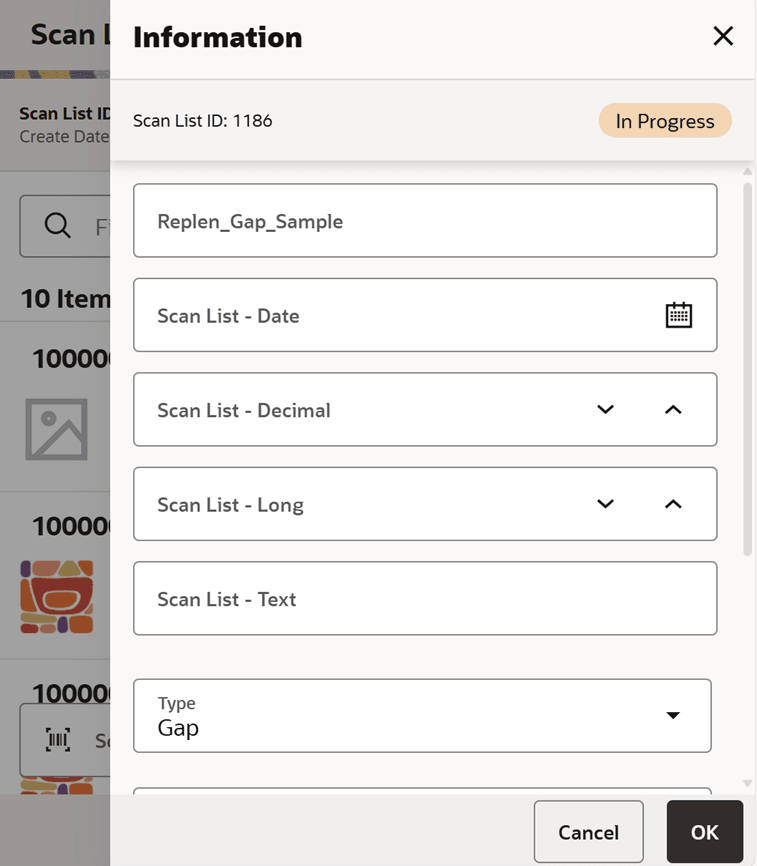

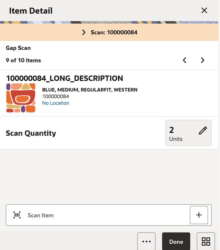

Gap Scanning (Empty Shelf Scanning)
The Gap scanning method replenishment is the easiest method of all the various types of shelf replenishment. With this method, you scan the goods that need replenishment, and a replenishment list is created from the units scanned.
The system uses this replenishment list to move the goods from the back room to the shop floor based on back room availability. The reason to have a separate process between scanning and generating is that one user can create a list and another user can execute the shelf replenishment allowing for distribution of workload.
Since this process does not have a dependency with either sales or capacity, it gives an advantage to the retailer to move goods without any complex setup.

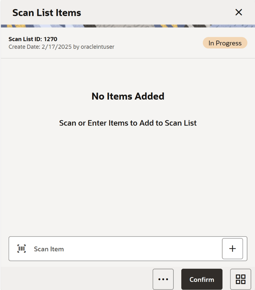

A product group is required to set up with all the items on a shelf. The following table is an example which shows six items with various colors and sizes. For the comparison between shop floor display and back room, all of the items need to be set up in the product group.
Next, a scan list needs to be created by scanning the items on display. For this example, you only have item 124 on the display shelf.

While creating the product group, you selected to sort by the color. Since the scanned item is black, the sorting is by color. The system will try to find a different color available in the back room. After the comparison between the two lists, the system tells you item 236 needs to be replenished.
The suggested red item to be replenished will depend on available back room inventory and the sort of the second differentiator. If Diff 2 had been defined differently, such as L = 10, M = 08, and S = 06, then item 234 would have been recommended instead for replenishment.

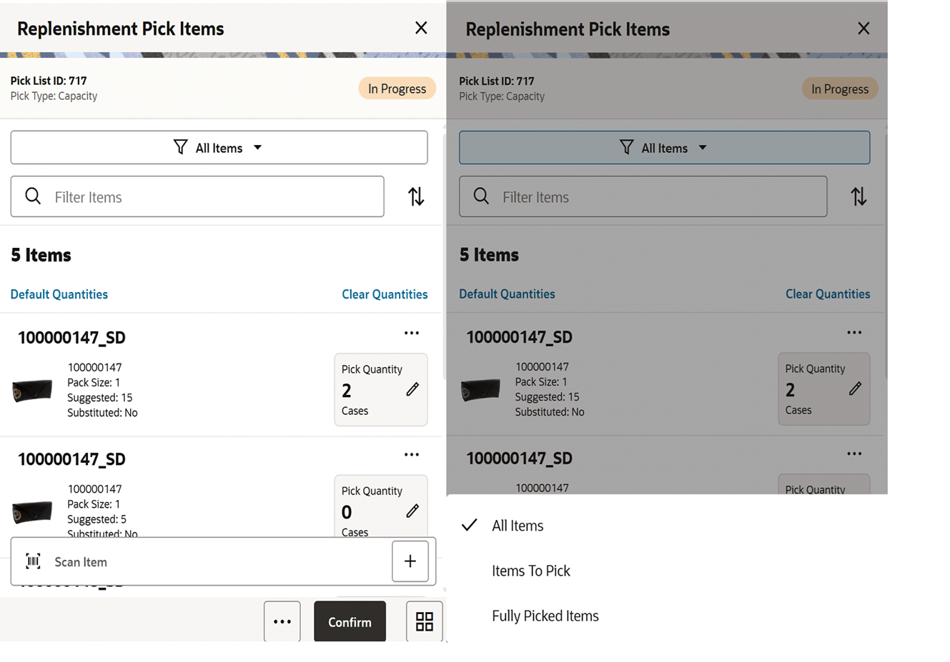

Figure 10-6 Replenishment Pick Items
This screen is accessed by selecting a replenishment list from the Replenishment Pick List screen or when creating a new pick. You need proper permissions to reach this screen. Selecting an item from the pick items will take you to the Item Detail screen.
You can filter the list with the pre-defined searches by selecting the filter option. The filter menu provides the following ways to filter.
  • All Items- Selecting this option will display all items irrespective of whether they were picked or not.
  • Items to Pick - Selecting this option, will list the partially picked or non-picked items(Actual pick qty = zero OR Actual pick qty < Suggested Pick Qty OR Actual pick qty = NULL) in the Replen Pick Items screen.
  • Fully Picked Items - Selecting this option, will list the fully picked items (Actual pick qty = Suggested Pick Qty) in the Replen Pick Items screen.
These searches will also include Substitute Items. The substitute Items will always be grouped together with the original item.
If the search did not return any records, an empty list will be displayed in the Replen Pick List screen.
The Default Quantities option on this screen allows you to default the suggested pick quantity to the actual pick quantity.
The Clear Quantities option will clear any quantities populated in the current session (before saving)
You can confirm the pick by selecting the Confirm button on the bottom or from the footer menu.

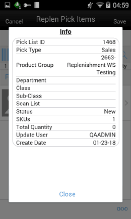

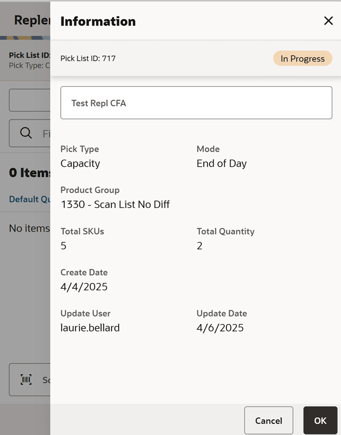

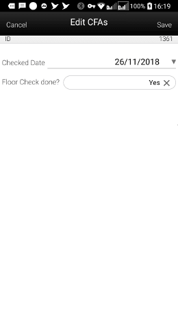

Replenishment Info
Figure 10-7 Replenishment Pick Items Info Screen
The Replenishment Info screen is accessed by selecting the info option from the Replenishment Pick Items screen.
This screen provides the information about the pick which includes the Pick List Id, Pick type, Product Group, hierarchy info, scan list and so on.
This screen also displays the list of CFAs (flexible attributes) that have been set up for Replenishment Pick List in the system and allows you to capture values for them. The fields displayed here are based on what is setup for the Replenishment Pick List. The CFAs that are set up as 'Required' must have a value entered for it before confirming the scan list. The value can be one of the following: Date, Text, Decimal, Long depending on the 'data type' set up for the CFAs, while creating them in the mobile application. Appropriate security permission is needed, and the pick list record must be in editable state for entering CFA values.

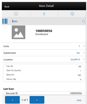

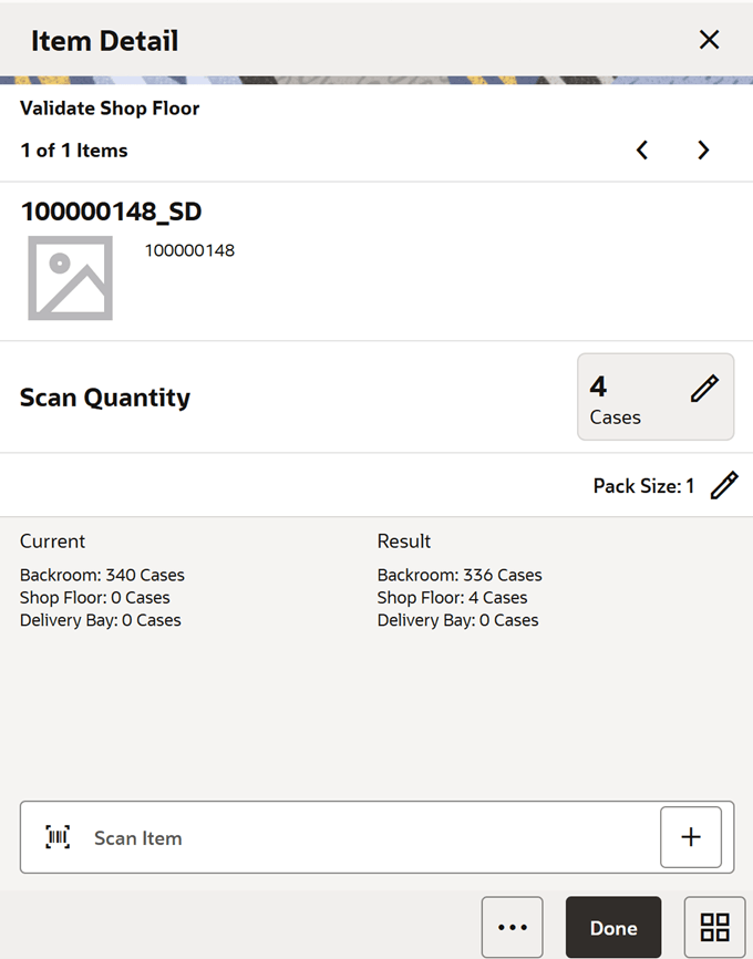

Replenishment Pick Item Detail
Figure 10-8 Replenishment Pick Item Detail Screen

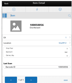

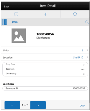

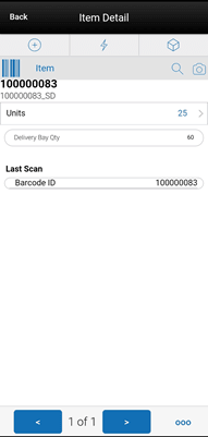

This item detail screen is accessed by selecting an item or when scanning an item from the Replenishment Pick Items screen.
User may also scan the same item or a different item from this screen. The information will be retained for the replenishment pick list you are currently working in, until you leave the replenishment pick list. Select Save from the Replenishment Pick Items screen to permanently save the item information. There is no Save on the Item Detail screen.
If you have used a pre-defined search in the Replenishment Pick Items, the Item Detail screen should be limited to only the items returned by the search.
Scanning or entering an item on this screen will refresh this screen for the item scanned/ entered.
The substituted field displays whether an item has substitute item(s) associated with it and if selected it also allows you to navigate to the substitute items screen to add substitute items.
If you have scanned an item, the system displays the last scanned barcode.

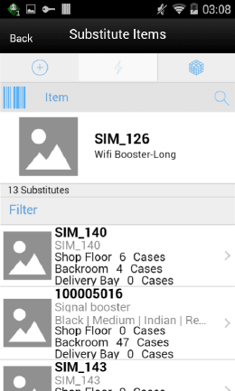

Substitute Items
Figure 10-9 Substitute Items Screen

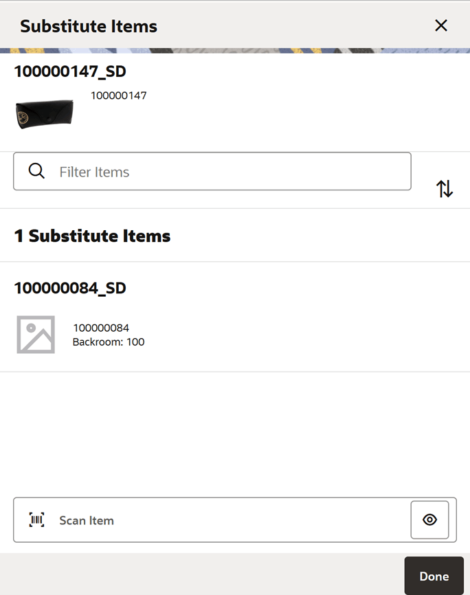

The Substitute Items screen is used to find a substitute item when the requested item has no inventory. The Substitute Items screen can be accessed from the Replenishment Pick Item Detail screen by selecting the Substituted pencil icon. Using item substitution helps maintain a better fill rate within different areas of the store. The substitutions can be recommended by corporate, or they can be ad hoc picked depending on system settings. Depending on security permissions, you can be restricted to just the corporate items or be free to select anything you want.

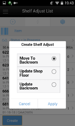

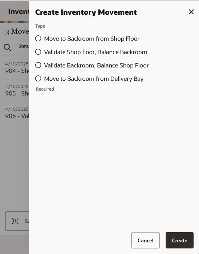

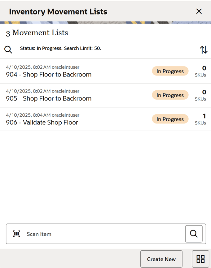

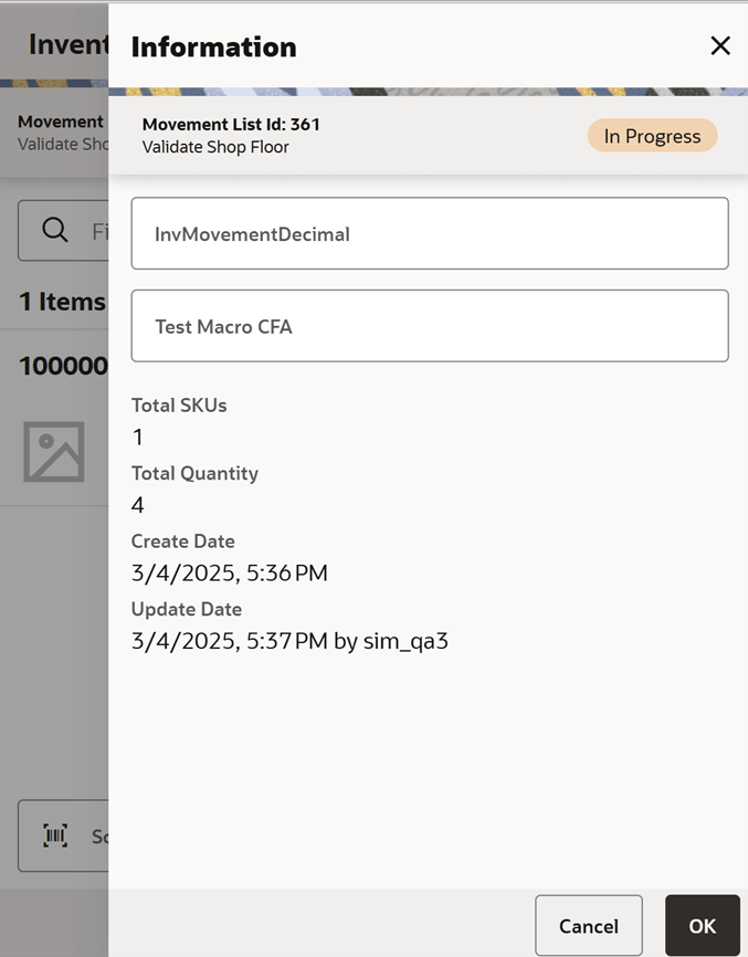

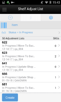

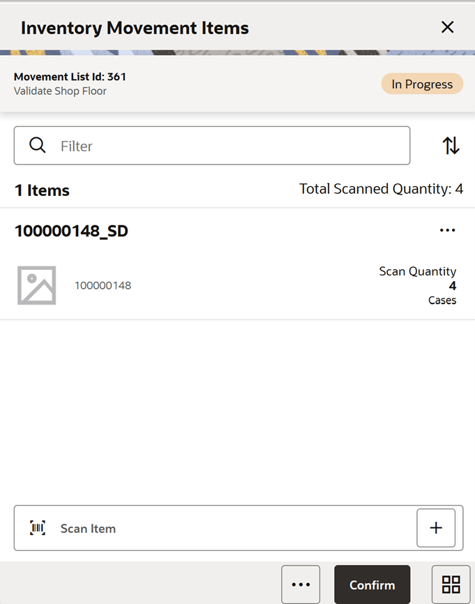

Inventory Movement Lists
Figure 10-10 Inventory Movement Lists Screen
The Inventory Movement Lists screen will list the Inventory Movement lists that are In Progress.
You can access this screen by selecting the Manage Location Inventory menu from the In Store Replenishment menu which is available on the drawer menu.
The Manage Location Inventory dialog supports the following type of movements and those are listed here on this screen.
  1. Move to Backroom from Shop Floor
  2. Validate Shop floor, Balance Backroom
  3. Validate Backroom, Balance Shop Floor

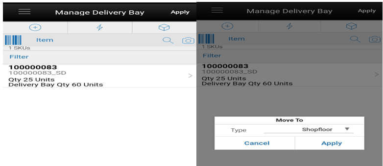

  4. Move to Shop Floor from Delivery Bay
  5. Move to Backroom from Delivery Bay
On the list you can find the Inventory movement ID, total number of items, current status, type, and the date for each movement.
The Create New button on this screen takes you to the Create Inventory Movement screen to create a new inventory movement list.
You can filter the list using the search criteria screen by selecting the magnifying glass.
On this screen, you can scan the item or search the item using the standard item lookup feature to filter the movement lists that contains the searched item.
Figure 10-11 Create Inventory Movement Screen
The Create Inventory Movement screen appears when you select the Create New option from the Inventory Movement Lists screen.
On this screen, you can select the movement type and select Create a new list. Upon selecting Create, the system creates a new list and takes you to the Inventory Movement Items screen to add items.
You can create any of the following types of movement lists.
The Inventory Movement type options shown here are based on the permissions you have.
    1. This option is displayed only when the Display Shop Floor/Backroom Quantity is turned on.
    2. The list is created, the quantities scanned will be moved from the shop floor to the Backroom.
  2. Validate Shop Floor, Balance Backroom
    2. When the list is created, the quantities scanned will update the current available quantity on the Shop floor and balance the backroom quantity.
      • Example: Item 1 having Backroom quantity=100, Shop Floor Quantity=3, SOH=103. Now the user creates a list with this type and scans quantity of 10. After the updates, the Backroom quantity will be 93, Shop Floor Quantity=10 and SOH will remain 103.
    2. When the list is created, the quantities scanned will update the current available SOH in the Backroom and balance the Shop Floor Quantity.
      • Example: Item 1 having Backroom quantity=100, Shop Floor Quantity=3, SOH=103. Now the user creates a list with this type and scans quantity of 90. After the updates, the Backroom quantity will be 90, Shop Floor Quantity=13 and SOH will remain 103.
  4. Move to Shop Floor From Delivery Bay
    1. This option is displayed only when the Allow Delivery Bay quantity to move to shop floor store parameter is set to Yes.
    2. Displayed only when Replenishment - Delivery Bay Inventory store parameter is set to Yes.
    3. Displayed only when you have 'Manage Delivery Bay' permission.
    4. When this list is created, the quantities scanned will be moved from the delivery bay to Shop floor. The quantity scanned will be subtracted from the Delivery Bay and added to the Shop Floor.
    5. If this option is selected, the system will look for the capacity defined and if defined it will move the inventory to that extent and move the rest of the quantity to the backroom. If delivery bay quantity is less than the defined quantity, the system will move all the quantities.
  5. Move to Backroom From Delivery Bay
    1. Displayed only when Replenishment - Delivery Bay Inventory store parameter is set to Yes.
    2. Displayed only when you have 'Manage Delivery Bay' permission.
    3. The list is created, the quantities scanned will be moved from the delivery bay to the Backroom. The quantity scanned will be subtracted from the delivery bay and added to the Backroom inventory.
Figure 10-12 Inventory Movement Items Screen
This screen is accessed by selecting an inventory movement list from the Inventory Movement Lists screen or when creating a new movement list. You need proper permissions to reach this screen. Selecting an item from here will take you to the Item Detail screen.
You can access the footer menu by selecting the ellipsis button and perform various functions like viewing the information of the list, Notes, Confirm, Save and Exit, Cancel and Delete.
The list displays the item id and description and the scan quantity.
You can delete an item from the list by selecting the Delete option from the item level menu.
On the scan bar you can scan an item or use the standard item lookup feature to add an item to the list.
Upon confirming the list, the system performs the inventory movement based on the type you have selected and sets the list status to completed.
Inventory Movement Info
Figure 10-13 Inventory Movement Info Screen
The Inventory Movement Info screen is accessed by selecting info option from the Inventory Movement Items screen.
This screen provides the information about the movement which includes the Movement List Id, status, type, SKUs, total quantity, create date, update date and update user.
This screen also displays the list of CFAs (flexible attributes) that have been set up for Inventory Movement in the system and allows you to capture values for them. The fields displayed here are based on what is setup for the Inventory Movement. The CFAs that are set up as 'Required' must have a value entered for it before confirming the scan list. The value can be one of the following: Date, Text, Decimal, Long depending on the 'data type' set up for the CFAs, while creating them in the mobile application. Appropriate security permission is needed, and the pick list record must be in editable state for entering CFA values.
Inventory Movement Item Detail
Figure 10-14 Inventory Movement Item Detail Screen
You are directed to the Item Detail screen upon selecting an item or when you scan or enter an item on the Inventory Movement Items screen.
User may also scan the same item or a different item from this screen. The information will be retained for the movement you are currently working in, until you leave. Select Save and Exit from the Inventory Movement items screen to permanently save the item information. There is no Save on the Item Detail screen.
Editable fields are displayed at the top with pencil icons and non-editable information fields are grouped at the bottom of the pane.
On the item detail screen, you will be able to see the current inventory position and the results after the inventory movement.
Scanning or entering an item on this screen will refresh this screen for the item scanned/ entered. At the bottom of the screen the details of the last scanned barcode will be displayed.
The screen will be in edit mode when it is in the New status.
You need permission to edit the scan quantity using the edit pencil icon.

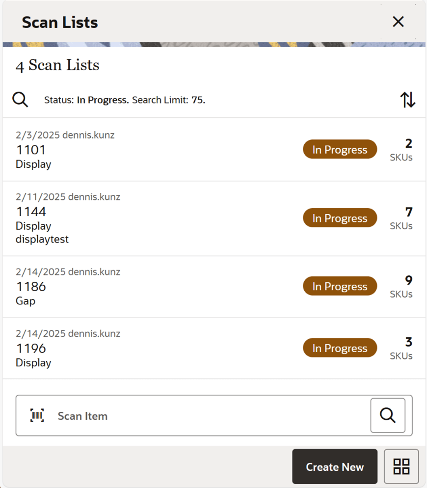

You can access the Scan List by selecting the Scan List option from the In Store Replenishment menu available on the drawer menu or from the Quick Actions.
You must have proper permissions to access this screen.
The list displays all types of Scan List viz Display, Gap, Other and Store Runner types.
You can create a new scan list by selecting the Create New button and the system will take you to the Scan List Items screen for adding the items.
When you select the Create New option, the system automatically assigns the scan list type based on the Default Scan List Type store parameter and takes you to the Scan List Items screen with the empty list.
If you do not have data permission to the default type set, you will not be able to create a new scan list.
If you are selecting the scan list record from the list, the system will take you to the Scan List Items screen with the items listed.
You can filter the scan list records using the search criteria screen by selecting the magnifying glass and applying the search criteria. The search criteria screen allows you to enter various fields and filter the scan lists records.
The screen provides the header level information of each scan list such as Id, status of the scan list, type, and the total SKUs.

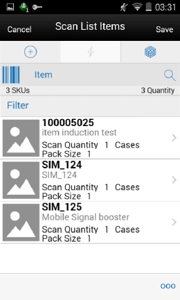

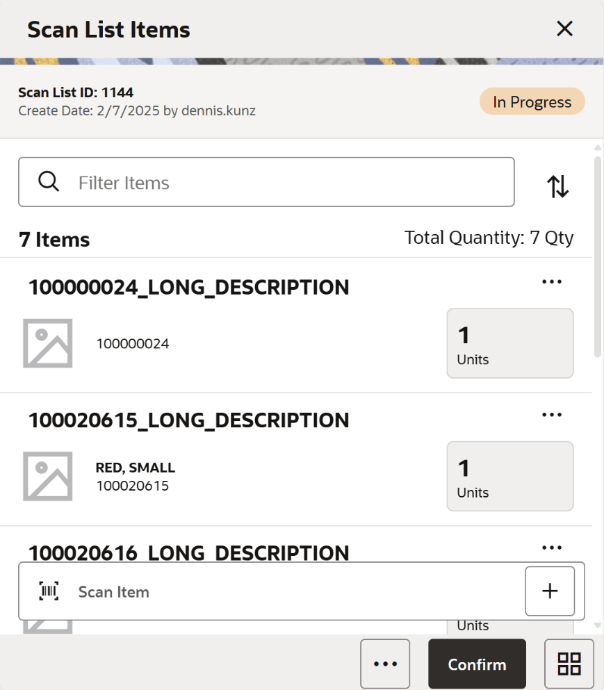

Scan List Items
Figure 10-16 Scan List Items Screen
Figure 10-17 Scan List Items Screen
You can access the Scan List Items screen by selecting a scan list from the Scan List screen or when creating a new scan list by selecting the Create New button on the Scan List screen. You will also land on this screen when selecting a scan list record from the Open transactions screen.
When creating a new scan list, this screen will show empty and allow you to scan the items to add it to the scan list. When you enter this screen, the system automatically assigns the type based on the Default Scan list type store parameter and if you want to change, you can use the information screen.
This screen displays the list of items that are in the scan list.
At each item level, the system displays the Image depending on the user preference, Item Id, Description, Scan quantity, UOM and Pack Size.
Selecting a line item navigates to the item details of that item. Scanning or entering an item in the scan bar will navigate the user per the User Preference, Scan Navigate. The user will either go to the Item Detail for the item or stay on the Scan List Items screen. Quantity may or may not be incremented/decremented for the item on the list upon scan. This is dependent on the Scan Mode and the barcode embedded quantity.
By selecting the delete from the item level overflow menu(ellipsis) when in edit mode you can flag the item to be deleted. You must have Edit permission to remove items.
When you confirm the scan list, the system will save the changes and status will move to completed. If the type selected is Gap or Display, the system will take you to the create replenishment pick screen to create a pick.
From the footer menu you can access the Info, Notes, Delete, Save and Exit and Print.
UINs and Extended Attributes are not captured in Item Scan List.

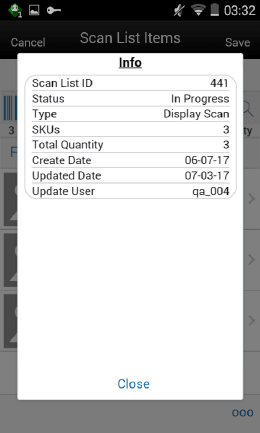

Scan List Info
Figure 10-18 Scan List Items Info Screen
Scan List Items Info screen
The Scan List Info screen can be accessed by selecting the Info option from the footer menu on the Scan List Items screen.
This screen provides the information about the scan list which includes the Scan List Id, status of the scan list, type of the scan list, SKUs, total quantity, create date, last update date and user.
On this screen, you can change the type of the scan list and provide a description to the scan list optionally.
  • Display Scan:
    This list is intended for you to scan the shop floor display items. The list of scanned items will be compared when generating a pick list.
  • Gap Scan:
    For Gap Scanning, you will scan gaps on the shelf. When the list is complete, you can save it and have it executed.
  • Other:
    This list is intended for Retailer’s custom use.
  • Store Runner:
    This list is intended for the Store Runner use. The list created under this type is listed on the Store Runner List for the user to process the inventory request from shop floor.
This screen also displays the list of CFAs (flexible attributes) that have been set up for Scan List in the system and allows you to capture values for them. The fields displayed here are based on what is setup for the Scan List. The CFAs that are set up as 'Required' must have a value entered for it before confirming the scan list. The value can be one of the following: Date, Text, Decimal, Long depending on the 'data type' set up for the CFAs, while creating them in the mobile application. Appropriate security permission is needed, and the scan list record must be in editable state for entering CFA values.
Scan List Item Detail
Figure 10-19 Scan List Item Detail
The scan list item detail screen can be accessed from the scan list items screen when selecting an item or when entering/scanning a new item to the list.
You may also scan the same item or a different item from this screen. The information will be retained for the item scan list you are currently working in, until you leave the transaction. At the top of the screen the details of the last scanned barcode will be displayed.
Select Save and Exit from the Scan List Items screen to permanently save the item information. There is no Save on the Item Detail screen.
For this screen to be in edit mode, you must have proper permissions.
This screen will be in view only mode if the status of the scan list is completed.
You can use the arrow buttons on the top to navigate items.
You can access the footer menu by selecting the ellipsis button on the bottom and add item to the item basket or remove the item from the item basket and print the ticket.
You can select the Delete option from the footer menu to delete the item from the scan list.
You can use the pencil icon and edit the scan quantity of the item.
When you select Done, the system takes you to the Scan List Items to Save or confirm.

Store Runner List
Figure 10-20 Store Runner List
Store Runner List
The Store Runner dialog helps you to exercise the stock request done by the sales person or staff on the shop floor to the backroom to meet customer demand or to replenish. Typically a request is sent to the backroom and a store runner staff is sent to the backroom to bring the items to the shop floor.
The requesting process is handled in the Scan List by creating the scan list of type Store Runner.
In this dialog the user can exercise the request by sending the inventory or rejecting the request.
You can access the Store Runner List by selecting the Store Runner option from the In Store Replenishment menu available on the drawer menu or from the Quick Actions.
When you access this screen, the system will by default list all the active Store Runners and you can select the one from the list to pick or reject the request.
You can filter the store runner list records using the status drop down. You can select All, Active or Closed to refine the list.
On this screen you can also filter the list using the standard text filter and also use the sort option to sort the records.
If you scan an item on the scan bar, the system searches the store runners containing the scanned item and will list those.
You can find the header level information such as request id, date, user, status and the number of SKUS.
If you are selecting the scan list record from the list, the system will take you to the Store Runner Items screen with the items listed.
Store Runner Items
Figure 10-21 Store Runner Items
Store Runner Items
You can access the Store Runner Items screen by selecting a Store Runner from the Store Runner List.
This screen will list all the items that are in the selected store runner.
On this screen you can pick the shop floor requested items by scanning the item or entering the picked quantity against the requested item using the quantity editor.
On the header you can use the filter option to refine the list or use the default quantities to default the pick values with the requested quantity. Selecting clear quantities will reset the values.
You can also find the header level information such as request id, date, user status, number of request items and the total quantity.
There is no item detail in this dialog.
After scanning or entering the quantities, you can select the Pick option to send the inventory to the shop floor.
When you select Pick, the inventory is moved to the shop floor either from the backroom or from the delivery bay. The system will first move the inventory from the backroom, and if not available in the backroom and if delivery bay is enabled and stock available, the system will move the inventory from the delivery bay.
If you want to reject the complete request, you can select the Reject option from the footer menu.
Other options from the footer menu you can access are Notes, Print, Cancel and Pick.
