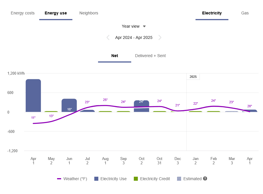

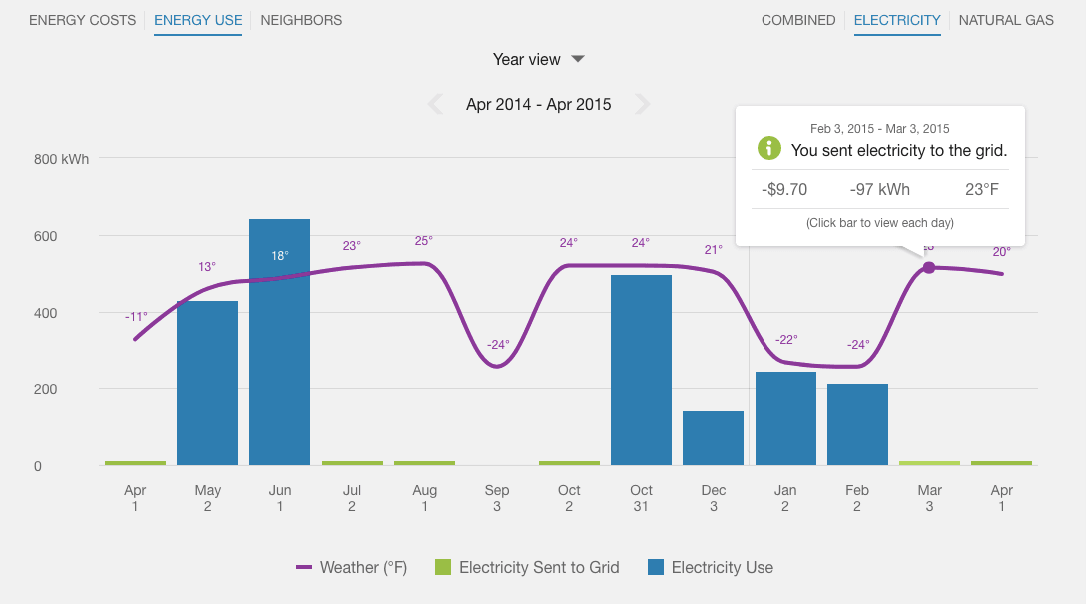

Solar Data and Net Energy Display
If a customer has solar power and generates more energy than they consume, the Energy Use view will show the customer's energy use as being sent to the grid. The example below shows short green bars for negative values. Additionally, a tooltip denotes the negative use value.
Screenshot of net energy metering (solar power) in the Year view of the Energy Use view of the Data Browser.
This default experience can be configured to display in different ways. Utilities must coordinate with their Contact Your Delivery Team to determine which display to use.

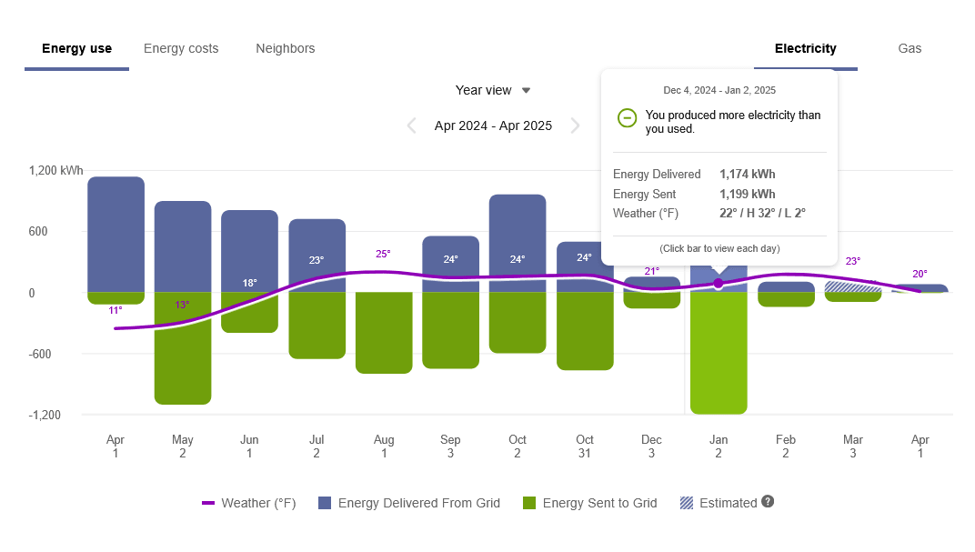

Solar Data, Net Usage, and Delivered + Sent Toggle
If a customer has solar power, the Energy Use view can display a toggle between Net and Delivered + Sent tabs when electricity is selected from the fuel menu. The toggle appears beneath the time menu. Customers can use the tabs of the toggle to gain insight into their electric energy usage and solar production separately, as well as their net usage. This information is available in all time resolutions (year, bill, and day views) if there is sufficient data.
Net Tab: The Net tab displays the customer’s final amount of energy consumption or energy generation for a given interval of time. It is determined by subtracting the customer’s solar power generation amount from their energy consumption amount. If the customer has a net usage amount, it is displayed as electricity use. If the customer has a net generation amount, it is displayed as an electricity credit.

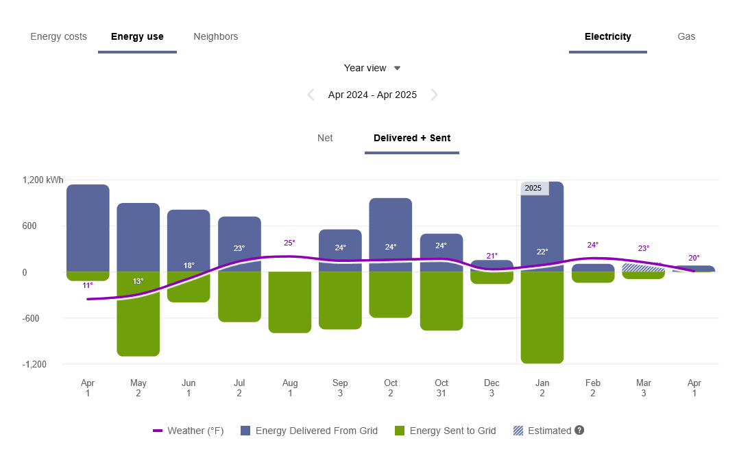

Sent + Delivered Tab: This tab displays the customer’s energy consumption and production data in the same time interval on the horizontal axis of the graph. “Sent” refers to energy sent to the grid through solar technology. “Delivered” refers to energy delivered from the grid to the customer’s premise.
Screenshot of the Delivered and Sent tab within the Energy Use view of the Data Browser.

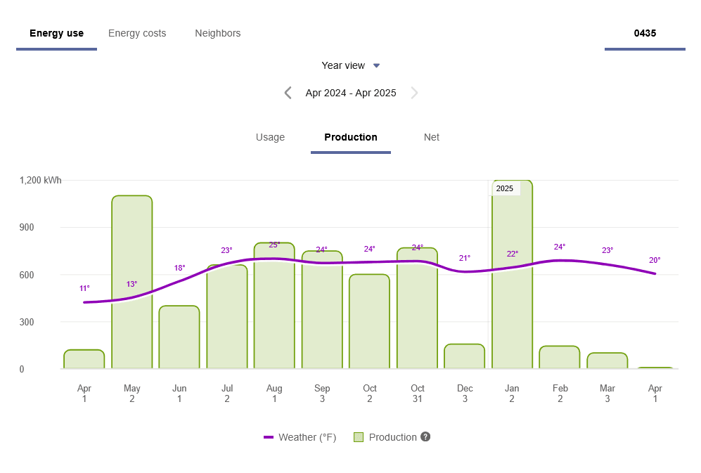

Scenario 1: One Service Agreement, Two Service Points
In this scenario, customers have one service agreement with two service points: a main service point for billing, and another service point for tracking gross solar generation. When a relevant electricity account is selected, the Energy Use view displays a submenu that allows the customer to see Usage and Production tabs in addition to the default Net tab. (If the customer has a net billing rate, there will be a Purchased and Sold tab instead of a Net tab.)
A screenshot of the Production tab in the submenu of the Energy Use view.
  • The Usage tab shows the customer’s total energy usage.
  • The Production tab shows the total energy generated by the customer’s solar panels.
  • The Net tab shows the net energy balance---the difference between the amount of energy produced and consumed.
  • If configured, the Purchased and Sold tab replaces the Net tab and shows a combination of information: the amount of energy bought from the utility and used, alongside the amount of energy generated by solar power and sold to the utility.

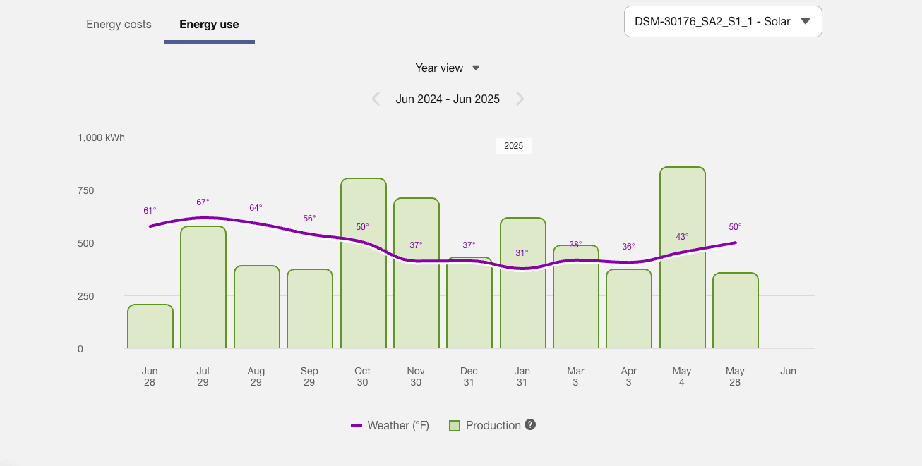

Scenario 2: Two Service Agreements, Two Service Points
In this scenario, customers have two separate service agreements: one service agreement with one service point for billing, and another service agreement with a service point for solar generation. The solar generation service agreement can be selected from a drop-down menu. The Energy Use view then displays gross solar production data for that service agreement.
A screenshot of the Energy Use View of the Data Browser when a solar production meter is selected and displays solar production data.
If the customer switches service agreements and selects the main billing service agreement, the data refreshes and the standard view of net energy data is displayed.
Alternatively, depending on the setup and configuration, the data shows a combined view of electricity delivered by the utility and used, alongside the amount of electricity generated by solar power and sent to the utility.
