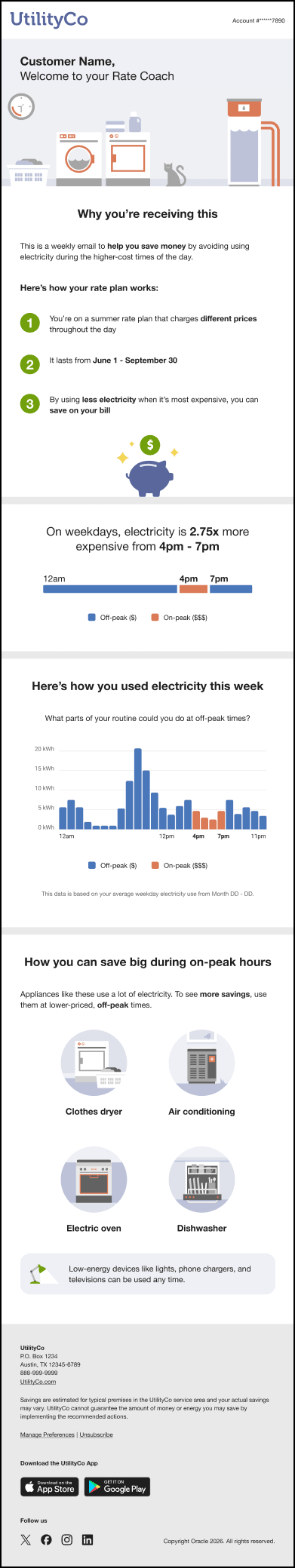

The Introduction email is the first weekly email customers receive as part of the program. This email is designed to welcome customers to the program, provide peak hour energy use insights, and offer tips on how to reduce energy use during peak hours.
The Introduction email contains the following modules, in the order listed:
- Email Header and Subject Lines Module
- Introduction Module
- Transition Module - Welcome State
- TOU 101 Module
- Hourly Usage Module
- Big Appliances Module
- Easy Open Module (optional)
- Email Footer Module

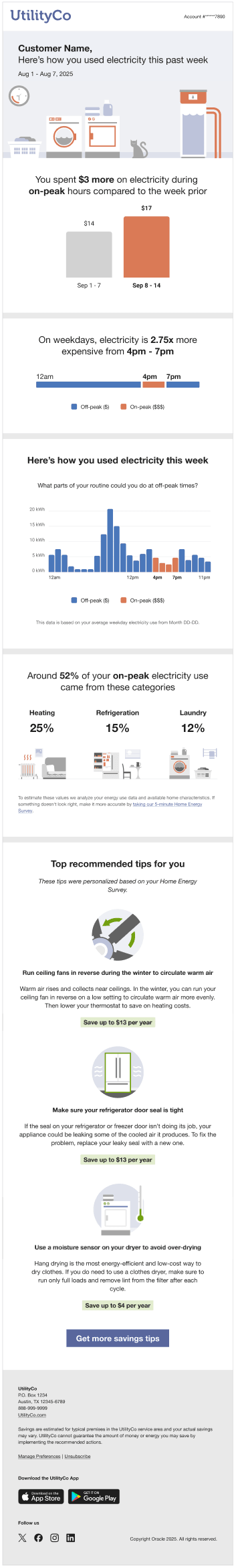

Weekly Emails
The Weekly email is delivered to customers at the end of each week. It provides peak hour energy use insights as well as a comparison between peak hour electricity spending during the current week and the previous week. The email also includes a breakdown of up to three appliances that were used during peak hours.
Customers begin receiving the Weekly email after they receive their Introduction email, and do not receive the Weekly email in weeks when they receive the Post-Bill Report Email.
The Weekly email contains these modules, in the order listed:
- Email Header Module and Subject Lines
- Transition Module (Included during seasonal transition periods only.)
- Weekly Comparison Module
- TOU 101 Module
- Peak Period Disaggregation Module
- Tips Module

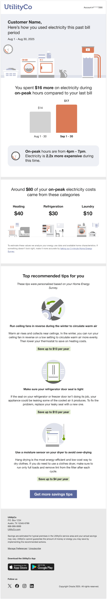

Post-Bill Report Emails
The Post-Bill Report is delivered to customers at the end of each month. The report helps customers understand which appliances they are using during peak hours, and how that usage contributes to their energy charges under a TOU rate plan. It includes a comparison of peak usage or costs between the customer's most recent bill and previous bill, a peak period disaggregation module, and a tip.
By default, the Post-Bill Report emails contain these modules, in the order listed:
- Email Header and Subject Lines Modules
- Post-Bill Report Bill Comparison Module
- Tips Module
- Load Shifting Collective Benefit Module
