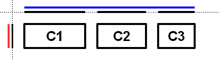

The following diagram shows the same three components, but with the parallel group along the horizontal axis and the sequential group along the vertical axis.
Sequential group along the vertical axis in three components
As c1 is the largest of the three components, the parallel group is sized to c1. As c2 and c3 are smaller than c1 they are aligned based on the alignment specified for the component (if specified) or the default alignment of the parallel group. In the diagram c2 and c3 were created with an alignment of LEADING. If the component orientation were right-to-left then c2 and c3 would be positioned on the opposite side.

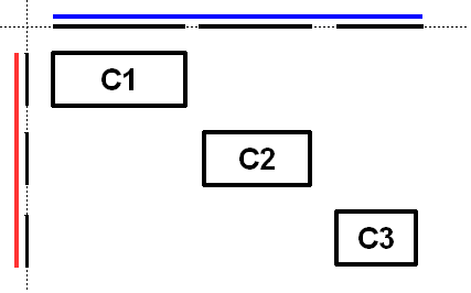

The following diagram shows a sequential group along both the horizontal and vertical axis.
Sequential group along both the horizontal and vertical axis in three components
