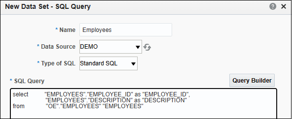

To create a dataset from data stored as a CLOB:
  1. On the toolbar, click New Dataset and then select SQL Query. The New Dataset - SQL Query dialog launches.
  2. Enter a name for the dataset.
  3. If you are not using the default data source for this dataset, select the Data Source from the list.
  4. Enter the SQL query or use the Query Builder to construct your query to retrieve the CLOB data column.
    For example, you could create a query in which the CLOB data is stored in a column named "DESCRIPTION".
  5. After entering the query, click OK to save. Publisher validates the query.
