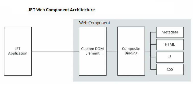

Web Component Architecture
The following image shows a high-level view of the JET Web Component architecture. In this example, an Oracle JET app is consuming the Web Component, but you can add Web Components to other JavaScript or Oracle apps where supported.
Web Components contain:
A custom DOM element: Named element that functions as a HTML element.
<my-web-component attribute1="*value1" attribute2="value2" ...> </my-web-component> -
Web Component binding definition: Knockout expression for setting Web Component attributes.
<my-web-component attribute1="value1" attribute2="[[value2]]" attribute3="{{*value3}}"> </my-web-component>attribute1's value can be a primitive JavaScript type (boolean, number, string) or a JSON object,attribute2's value uses one way data binding, andattribute3's value uses a two way binding. One way bindings on Web Components specify that the expression will not update the app's ViewModel if the value changes. In two way bindings, the expression will update and the value written back to the app's ViewModel.In the following code sample, the Web Component is declared with three attributes:
type,data, andaxis-labels.<my-chart type=bubble data="[[salesData]]" axis-labels={{showAxisLabels}} ... </my-chart>Because the
salesDataexpression is declared using one way binding ([[salesData]]), it will not be written back to if thedataproperty is updated by the Web Component's ViewModel. Thedataproperty will contain the current value, but thesalesDataexpression will not be updated. Alternatively, if theaxisLabelsproperty is updated by the ViewModel, both theaxisLabelproperty and the{{showAxisLabels}}expression will contain the updated value. -
Metadata: Data provided in JSON format which defines the Web Component's required properties:
name,version, andjetVersion. Metadata may also define optional properties, includingdescription,displayName,dependencies,icon,methods,events, andslots.Web Components support both runtime and design time metadata. Design time metadata isn't required at runtime and is useful for design time tools and property editors. Design time tools can define tools-specific metadata extensions to the Web Component's metadata. For any tool-specific metadata extensions, refer to the documentation for that specific tool. For additional information about metadata properties, see Composite in the API documentation.
The following sample shows some of the available metadata fields with descriptions of their content and whether they are not used at run time. Required metadata are highlighted in bold.
{ "name": "*The component tag name*", "version": "*The component version. Note that changes to the metadata even for minor updates like updating the jetVersion should result in at least a minor Web Component version change, e.g. 1.0.0 -> 1.0.1.*", "jetVersion": "*Thesemantic versionof the supported JET version(s). Web Component authors should not specify a semantic version range that includes unreleased JET major versions as major releases may contain non backwards compatible changes. Authors should instead recertify Web Components with each major release and update the component metadata or release a new version that is compatible with the new release changes.*", "description": "*A high-level description for the component. Not used at run time.*", "displayName": "*A user friendly, translatable name of the component. Not used at run time.*", "properties": { "*property1*": { "description": "*A description for the property. Not used at run time.*", "displayName": "*A user friendly, translatable name of the property. Not used at run time.*", "readOnly": "*Boolean that determines whether a property can be updated outside of the ViewModel. False by default.*", "type": "*The type of the property, followingGoogle's Closure Compilersyntax.*", "value": "*Object containing an optional default value for a property.*", "writeback": "*Boolean that determines whether an expression bound to this property should be written back to. False by default.*", "enumValues": "*An optional array of valid enum values for a string property. An error is thrown if a property value does not match one of the provided enumValues.*", "properties": "*A nested properties object for complex properties. Subproperties exposed using nested properties objects in the metadata can be set using dot notation in the attribute. See theSubpropertiessection for more details on working with subproperties.*" }, "*property2*": { ... *contents omitted* } }, "methods": { "*method1*": { "description": "*A description for the method. Not used at run time.*", "displayName": "*A user friendly, translatable name of the method. Not used at run time.*", "internalName": "*An optional ViewModel method name that is different from, but maps to this method.*", "params": "*An array of objects describing the method parameter . Not used at run time.*", "return": "*The return type of the method, following Closure Compiler syntax. Not used at run time.*" }, "*method2*": { ... *contents omitted* } }, "events": { "*event1*": { "bubbles": "*Boolean that indicates whether the event bubbles up through the DOM or not. Defaults to false. Not used at run time.*", "cancelable": "*Boolean that Indicates whether the event is cancelable or not. Defaults to false. Not used at run time.*", "description": "*A description for the event. Not used at run time.*", "displayName": "*A user friendly, translatable name of the method. Not used at runtime.*", "detail": { "*field name*": "*Describes the properties available on the event's detail property which contains data passed when initializing the event. Not used at run time.*" } }, "*event2*": { ... *contents omitted* } }, "slots": { "*slot1*": { "description": "*A description for the slot. Not used at run time.*", "displayName": "*A user friendly, translatable name of the method. Not used at runtime.*" } } } -
HTML markup: (Required) Contains the View definition which describes how to render the Web Component. The Web Component's View has access to several
$variables along with any public variables defined in the Web Component's ViewModel. Some of the variables that can be used in the Web Component's View are:Variables Description $propertiesA map of the Web Component's current property values $slotCountsA map of slot names containing a number of associated child nodes assigned to that slot $uniqueA unique string value provided for every component instance that can be used for unique ID generation $uniqueIdThe ID of the Web Component, if specified. Otherwise, it is the same as unique $propsDeprecated since 5.0.0, use $propertiesinstead$slotNodeCountsDeprecated since 5.0.0, use $slotCountsinstead -
JavaScript: Optional script for defining the ViewModel and custom events.
The ViewModel is also where you define callbacks for various stages of the Web Component's lifecycle. Web Components support the following optional lifecycle methods:
activated (context),connected (context),bindingsApplied (context),propertyChanged (context), anddisconnected (element). For more information on lifecycle methods, see Composite - Lifecycle. -
CSS: Optional styling for the Web Component.

Create Web Components
Oracle JET supports a variety of custom Web Component component types. You can create standalone Web Components or you can create sets of Web Components that you intend to be used together and you can then assemble those in a JET Pack, or pack component type. You can enhance JET Packs by creating resource components when you have re-usable libraries of assets that are themselves not specifically UI components. And, if you need to reference third-party code in a standalone component, you can create reference components to define pointers to that code.
Create Standalone Web Components
Use the Oracle JET command-line interface (CLI) to create an Oracle JET Web Component template implemented as JavaScript or TypeScript that you can populate with content. If you’re not using the tooling, you can add the Web Component files and folders manually to your Oracle JET app.
The following image shows a simple Web Component named demo-card that displays contact cards with the contact’s name and image if available. When the user selects the card, the content flips to show additional detail about the contact.
The procedure below lists the high level steps to create a Web Component using this demo-card component as an example. Portions of the code are omitted for the sake of brevity, but you can find the complete example at Web Component - Basic. You can also download the demo files by clicking the download button (

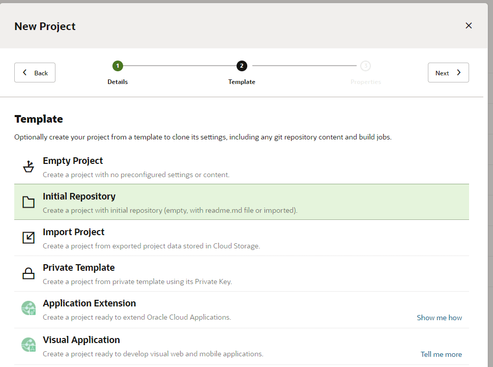

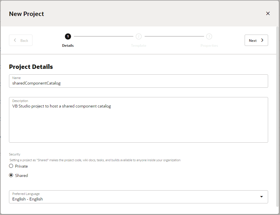

- Create a new project in Oracle Visual Builder Studio.
- Select the Initial Repository template for the new project.

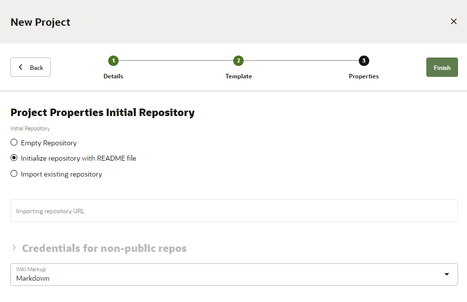

- Leave the defaults settings unchanged or, optionally, select the settings for importing your component source code and click Finish.

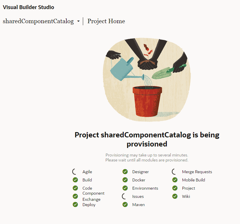

- In the project provisioning screen, verify that Component Exchange is one of the services being created.
