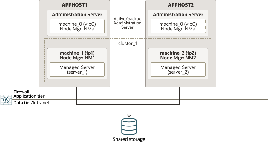

Administration Server High Availability Topology
An Administration Server can be active on one host at any one time. To set up high availability, you configure the Administration Server on a virtual host so that if the machine that it runs on fails, you can fail it over to another host in the domain.
Administration Server is configured to use a virtual IP to overlap the backup hosts. You configure Administration Server to listen on this virtual IP. The benefit of a virtual host and virtual IP is that you don't need to add a third machine; if failover occurs, you can map the virtual host to a surviving host in the domain by moving the virtual IP.
The two hosts share a virtual hostname and a virtual IP. However, only the active host can use this virtual IP at any one time. If the active host fails, the backup host becomes active and you must move (manually) the virtual IP to the new active host. The new active host then services all requests through the virtual IP. (You configure a high availability deployment to listen on this virtual IP.)
Figure 9-1 shows a highly available Administration Server.
In this topology, the Administration Server runs on a virtual host, APPHOST0. APPHOST0 overlaps to APPHOST1 or APPHOST2 by means of a virtual IP.
At first, APPHOST0 maps to APPHOST1. However, if the Administration Server fails due to an APPHOST1 failure, APPHOST0 fails over to APPHOST2 by moving the virtual IP.
Figure 9-1 Administration Server High Availability Topology
Description of "Figure 9-1 Administration Server High Availability Topology"
Parent topic: Administration Server High Availability
