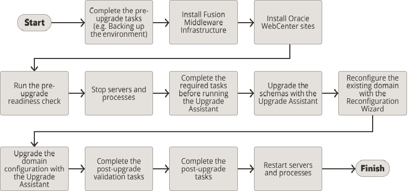

Review the flowchart and roadmap for an overview of the upgrade process for WebCenter Sites.
Figure 5-1 Upgrade Process Flowchart for WebCenter Sites
Description of Figure 5-1 follows
Description of "Figure 5-1 Upgrade Process Flowchart for WebCenter Sites "
Table 5-1 provides a roadmap for tasks that you must perform to upgrade WebCenter Sites from a previous 12c release.
