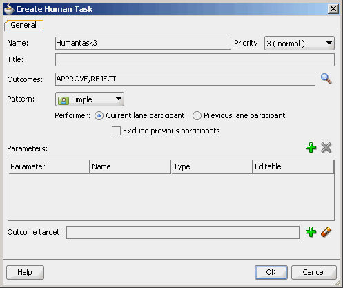

You can create a simple Human Task using Oracle BPM Studio. The simplified interface that Oracle BPM Studio provides hides the complexity of the Human Task editor by exposing the most important fields to configure a Human Task used in a business process.
After you create the Human Task using the Create Human Task dialog box, you can edit it using the Human Task editor if needed.
Figure 28-1 shows the Create Human Task dialog box.
The Create Human Task dialog box enables you to define the following properties:
Title
Defines the name of the Human Task that is displayed to end-users in the Oracle Process Workspace and Oracle BPM Worklist applications.
Priority
Specifies a priority for the Human Task. Valid values are between 1 (highest priority) and 5 (lowest priority). The default value is 3.
Outcomes
Specifies the outcome possible outcome arguments of the Human Task. Oracle BPM Worklist displays the possible outcomes you select as the available tasks to perform at run time.
Parameters
Define the Human Task payload. The Human Task data association is based on the parameters of the Human Task. The data association maps the data objects as input arguments.
Outcome Target
Specifies a String data object to store the outcome argument of the Human Task. You can only select one data object. The value of this outcome is one of the values defined in the Outcomes property.

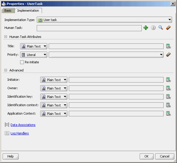

You can edit a Human Task using the User Task Properties dialog box or the Human Task editor. Generally you use the Human Task editor for complex human tasks.
Figure 28-2 shows the User Task Properties dialog box.
Figure 28-2 User Task Properties dialog box
Description of "Figure 28-2 User Task Properties dialog box"
The User Task Properties dialog box enables you to define properties using plain text, simple expressions and XPATH expressions:
Title
Priority
Re-Initiate
Restarts the approval process from the beginning.
Initiator
Specifies the user who initiates a task. The initiator can view their created tasks from Oracle BPM Worklist and perform specific tasks, such as withdrawing or suspending a task.
Owner
Specifies the User ID of the task owner.
Identification Key
Defines a user-defined ID for the task. For example, if the task is meant for approving a purchase order, the purchase order ID can be set as the identification key of the task. Tasks can be searched from Oracle BPM Worklist using the identification key. This attribute has no default value.
Identity Context
This field is required if you are using multiple realms. You cannot have assignees from multiple realms working on the same task.
Application Context
Specifies the name of the application that contains the application roles used in the task. This indicates the context in which the application role operates.

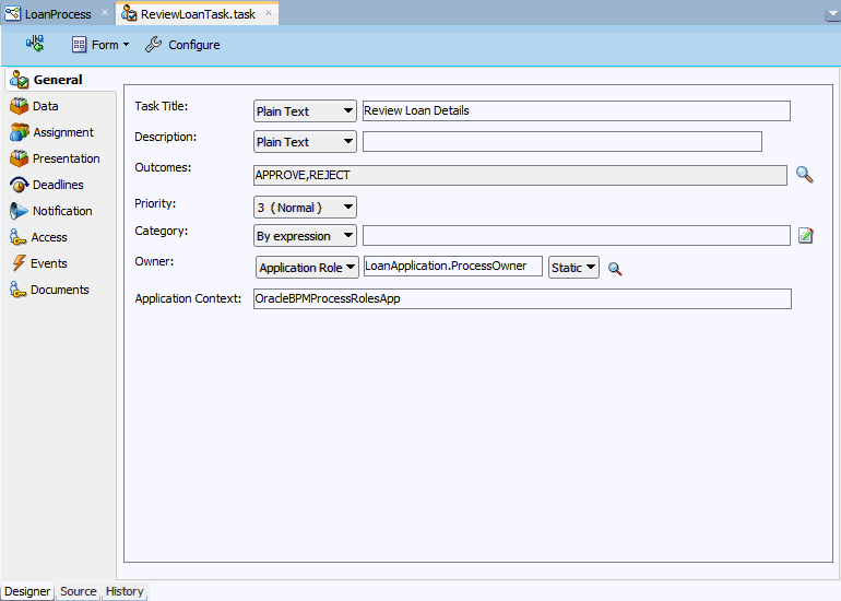

Configuring complex human tasks usually requires you to use the Human Task Editor to edit them. This allows you to edit properties that are not displayed when you use the simplified interface that Oracle BPM provides.
Figure 28-3 shows the Human Task editor.
Configuring a Human Task Using the Human Task Editor
Learn how to configure those properties that are only available when using human tasks from Oracle BPM Suite.
The rest of the properties are shared with Oracle SOA Suite. For more information on how to configure these properties, see Creating Human Tasks in Developing SOA Applications with Oracle SOA Suite.
The Human Task editor enables you to configure the following sets of properties:
General
Enables you to define basic information such as the title, description, priority and owner.
Note that you can localize the title of a Human Task by selecting the Translation option from the list next to the title field and then clicking Build and Internationalized title. For more information on how to define the resource bundle, see Specifying Multilingual Settings and Style Sheets.
For more information on how to configure these properties, see How to Specify the Title, Description, Outcome, Priority, Category, Owner, and Application Context.

Double-click the Human Task you want to configure.
The Human Task Editor appears.
Click the Documents tab.
Select Use Document Package.
A section to configure metadata properties appears. The table already contains the mandatory standard metadata: Security Group and Document Type.
Optionally add new standard or custom metadata properties:
Click the Add button.
Click the Name column to select a standard property from the list or to enter a custom name.
Click the Value column to assign a value to the property. Select By Name to provide the text to assign the value to the property, or By Expression to provide an expression.
Click the Display column to select a display mode:
Editable: the user can provide a value in the task form when uploading the attachment.
Hidden: the value does not appear in the task form
Read-Only: the value appears in the task form but the user cannot modify it
Custom metadata does not appear in the task form, so you must map the value to a task payload or provide a static value.

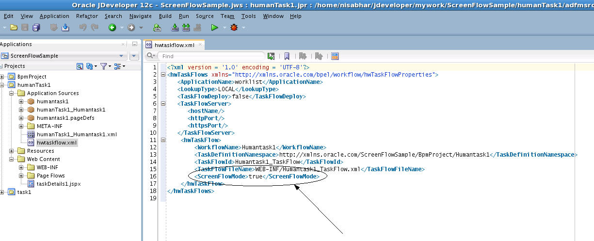

Creating a Screenflow
Screenflows are created in HumanTask projects to create a task that automatically flows from screen to screen.
