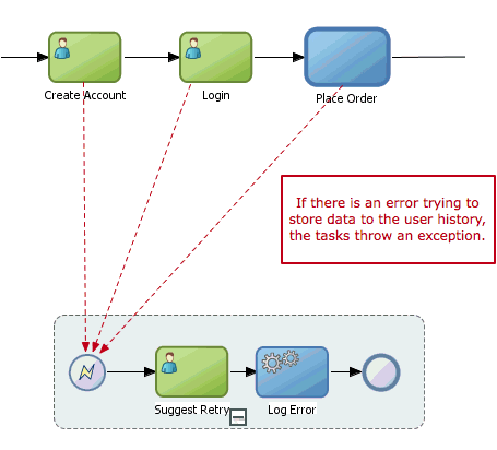

Figure 18-2 shows a process that handles an error using a an event subprocess.
Figure 18-2 Event Subprocess with a Start Error Event
Description of "Figure 18-2 Event Subprocess with a Start Error Event"

Handling Exceptions in Subprocesses
Event subprocesses enable you to define a cleaner process with less effort because the catch error event is located within the event subprocess.
You can handle exceptions that occur in a subprocess in the same way you handle the exceptions in any other BPMN activity.
