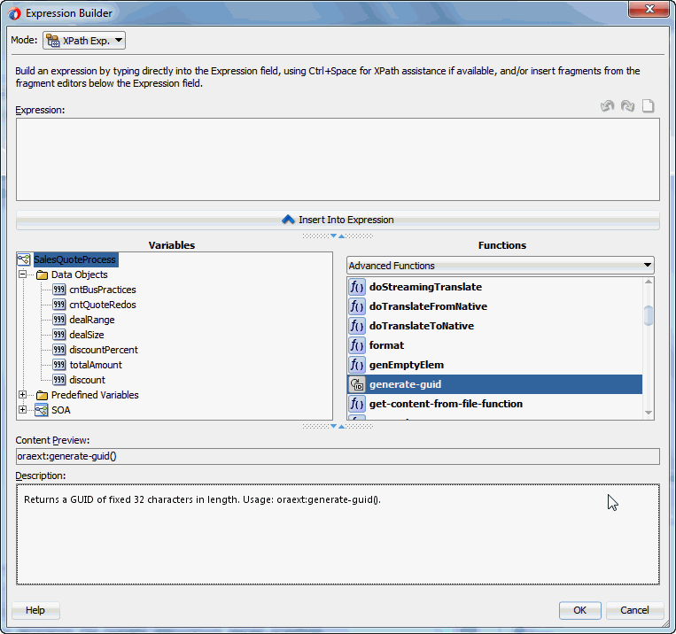

Oracle BPM provides you with two different types of expression editors that adjust to requirements of different users. Learn how to write expressions and conditions for the BPMN elements that require them. Also check the expression language used by each of these expression builders and the operations you can use in the expressions you write.
Introduction to Expressions in Oracle BPM
Some BPM elements require you to write a condition or an expression that defines their behavior. For example, you might want to control the flow of your process using a conditional sequence flow that ensures that all expenses above 500 dollars are approved by a manager.
Oracle BPM provides you two ways of writing these expressions and conditions:
Using the Simple Expression Builder
Using the XPATH expression builder
The Simple Expression Builder uses dot notation and its syntax is very similar to Java. The XPATH Expression Builder uses standard XPATH language.
After writing an expression in simple expression language you can convert it to XPath and vice versa. When you convert an expression from one language to another, the expression editor removes any operators and parenthesis that do not affect the meaning of the expression.

The configuration dialogs of the BPM elements that support expressions contain an embedded expression editor and a button to launch the expression builder. The latter is more suitable when you are working with long expressions. Both expression builders enable you to browse the available variables. The XPATH expression builder also enables you to browse the available functions.

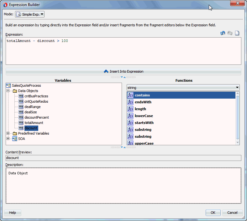

Writing Expressions and Conditions Using the Simple Expression Builder
The Simple Expression Builder contains a text area for you to type the expression and a list of variables that you can use.
The Simple Expression Builder supports the following features:
Syntax Highlighting
The Simple Expression Builder highlights the syntax in your expressions to make them easier to read and understand. It uses different colors for the different data type values.
Automatic Code Completion
If you wait a few seconds after you type the dot to invoke a method, then the Simple Expression Builder shows a list with the available functions that you can invoke over that data object. If you want the Simple Expression Builder to complete the expression for you, then you can press
Ctrl + Space. -
On-the-fly Error Checking
The Simple Expression Builder checks the expressions as you write. It underlines with a red waved line those expressions that do not compile. To find out the cause of the error place the cursor over the red wavy line and wait for a tooltip with the error description to appear.
Figure 24-1 show the Simple Expression Builder dialog box.
How to Use a Data Object in an Expression
You can use a data objects in your expressions to perform calculations based on them.
To use a data object in an expression:
How to Use a Function in an Expression
To use a function in an expression, you can select the expression from the expression list in the simple expression builder, or you can type the function name in the Expression text area. If you write part of the name and press Crtl+Space, then the expression builder completes the name of the function.
To use a function in an expression using the simple expression builder:

Writing Expressions Using the XPath Expression Builder
Oracle BPM enables you to write expressions using SOA XPath Expression Builder. This expression builder supports standard XPath language.
The XPath Expression Builder displays a list of the available variables that you can use in your expression. It also displays a list with the functions you can use in your expressions. When you select a function you can preview its syntax and description before adding it to your expression.
For more information about the functions supported for XPath see "Appendix B XPath Extension Functions" in Developing SOA Applications with Oracle SOA Suite.
Additionally Oracle BPM supports a group of BPM Extension Functions.
Figure 24-2 shows XPath Expression Builder.
