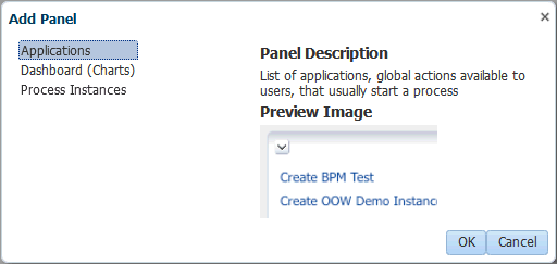

How to Add an Applications Panel to a Customized Page in Process Workspace
To add an Applications panel to a customized page:

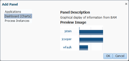

How to Add a Dashboards Panel to a Customized Page in Process Workspace
From the Add Panel dialog box, you can also select Dashboards (Charts), as shown in Figure 5-2.
Figure 5-2 Adding a Dashboards (Charts) Panel
Description of "Figure 5-2 Adding a Dashboards (Charts) Panel"
This dialog box enables you to include either charts or a chart selector in your new page. Choosing either one provides you with the corresponding preview image.
To add a Dashboards panel to a customized page:

From the Add Panel dialog box, select Dashboards (Charts), then click Ok.
The Dashboards panel appears on the page. See Using Standard Dashboards for an explanation of the standard dashboards.

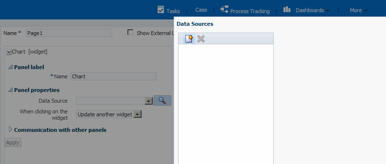

You can also specify a custom data source. To do this:
In the Dashboards panel, in the Panel Properties section, to the right of the Data Source field, click the Search icon.
The Data Sources dialog box appears as shown in Figure 5-3.
In the navigator pane on the left, click New.
A Data Source dialog box appears for you to create a new data source.
Specify the fields as described in Specifying Graph Content.
When you are finished specifying the data source, click Ok.

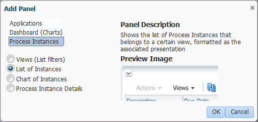

How to Add a Process Instance Panel to a Customized Page
From the Add Panel dialog box, you can select Process Instances, as shown in Figure 5-4.
Figure 5-4 Adding a Process Instances Panel
Description of "Figure 5-4 Adding a Process Instances Panel"
Selecting this option enables you to include one of the following types of process instance panels in your new page: views (list filters), list of instances, chart instances, and process instance details. Choosing any one of these displays the corresponding preview image.
To add a Process Instance panel:

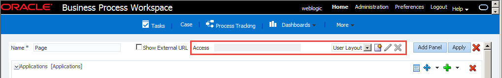

How to Grant and Manage Access to Customized Pages in Process Workspace
An administrator can specify the roles that can access a custom page that the administrator has created. Non-administrative users cannot grant access to custom pages.
To delete access properties for a custom page
In the custom page you are adding, next to the Access field, click Delete Access Properties.
If the layout is a custom one, then you are prompted to confirm the deletion.
To maintain the custom page for the current user when a custom layout is deleted, the user must first save the page to the default layout. Only then should the user create the custom layout, modify the page, and save it to the new layout. If the user does not first save the page to the default layout, then the page is deleted for all members of the roles defined in the custom layout, including the current user.
If the user had immediately created the custom layout and set it on the page before saving the page, then any custom pages previously associated with this custom layout remain, but are now associated with the default layout.
If the custom page uses the default layout, then the custom page is deleted. Users previously authorized to see this custom page will no longer see it.
