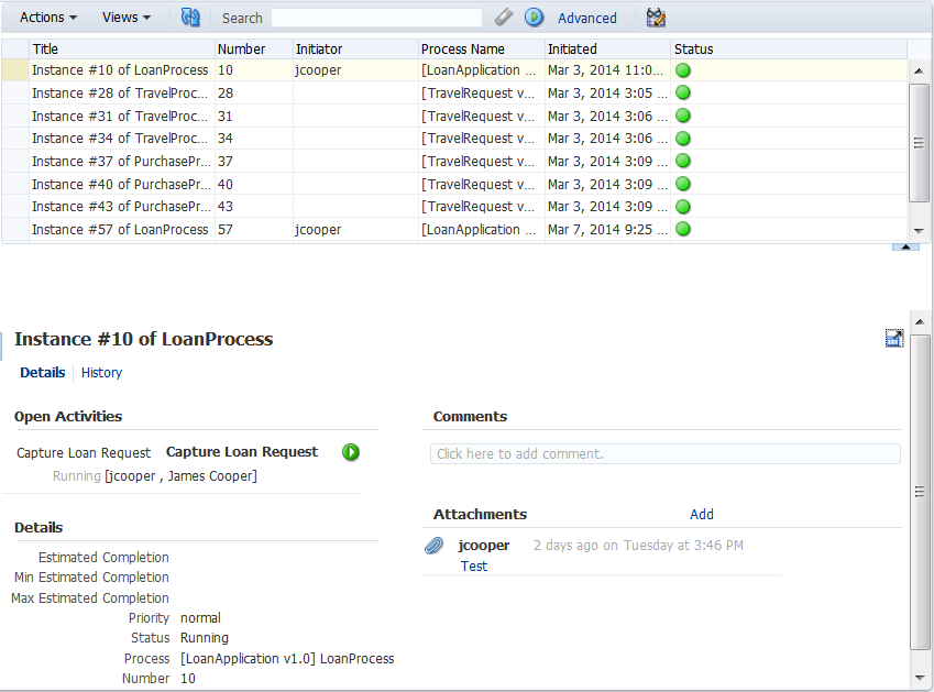

Process Tracking: This page enables process participants to view running process instances.

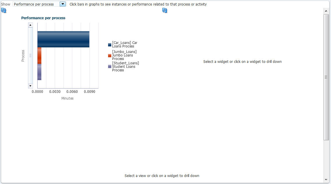

Standard Dashboards: This page provides out-of-the-box dashboards for monitoring process performance, task performance, and workload.
Custom Dashboards: This page enables process participants to define and use custom dashboards based on the measurement data generated by process instances.

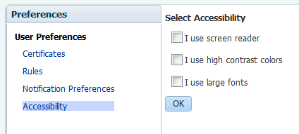

Setting Accessibility Preferences in Process Workspace
After logging in to Process Workspace, you can configure accessibility options from any page. This changes the user preferences, which are retained through all sessions until you change them again.
To set accessibility options:

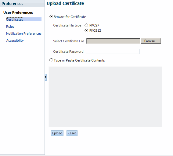

Providing a Digital Certificate in Process Workspace
A digital certificate establishes the participant's credentials. It is issued by a certification authority (CA). It contains your name, a serial number, expiration dates, a copy of the certificate holder's public key (used for encrypting messages and digital signatures), and the digital signature of the certificate-issuing authority so that a recipient can verify that the certificate is real. For more information, see Using the Evidence Store Service and Digital Signatures.
To provide a digital certificate:
In the upper right corner of Process Workspace, click Preferences.
In the Preferences pane, click Certificates.
Upload the certificate you want to use to sign your decision, as shown in Figure 1-2.
When signing a task outcome using your certificate, you must upload the entire chain of certificates through Process Workspace as a
.P7B(PKCS7 format) file, not just the one certificate issued to you by the certificate issuer. The entire chain can be exported through Internet Explorer. Mozilla Firefox does not let you export the chain as a.P7Bfile. Therefore, you can perform the following steps:-
Export the chain from Mozilla Firefox as a
.P12file (PKCS12 format that also contains your private key). -
Import the
.P12file in Internet Explorer. -
Export it again from Internet Explorer as a
.P7Bfile. -
Upload it through Process Workspace.
Note the following important points when providing your certificate to the system. Otherwise, you cannot use your certificate to sign your decisions on tasks.
The PKCS7 file format is a binary certificate format. Select this option if you have a standalone certificate file stored on your disk.
The PKCS12 file format is a keystore format. Select this option if you have your certificate stored inside a keystore.
An important point to note if you have the certificate stored inside a keystore. The Process Workspace only needs the public key for signature verification. It does not need the private key. Typically, a PKCS12 format may contain the user's private key (if you exported it from the browser). You can prevent access to the private key by following one of the options below:-
Create a PKCS12 keystore with only the public key and the certification chain, but exclude the private key. Upload this keystore to Process Workspace.
Protect the private key with a separate password that is not entered into the Process Workspace preferences. The private key is normally contained in the PKCS12 within a separately encrypted PKCS8 structure. While the PKCS8 is often encrypted using the same password as the enclosing PKCS12, that is not mandatory. If the PKCS8 private key is encrypted using a different password, then provide the PKCS12 password at upload time.
If you want to copy and paste the contents of the certificate, select Type or Paste Certificate Contents and paste the BASE64-encoded text into the field. Do not paste a certificate in any other format into this field. Likewise, if you choose to upload a certificate, do not upload a BASE64-encoded certificate. Only PKCS12- and PKCS7- formatted files are supported for uploads.

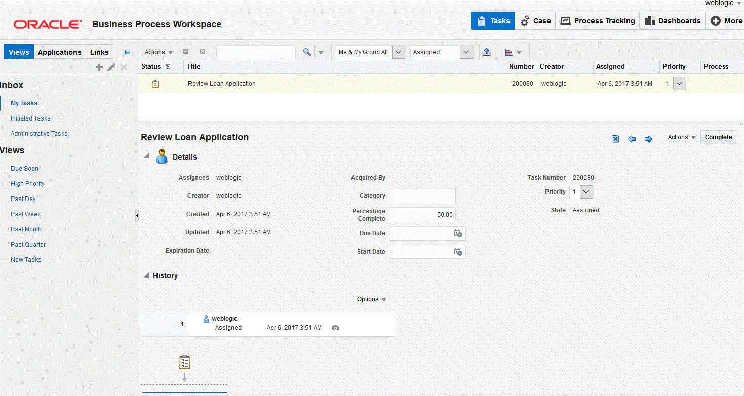

Navigating Process Workspace
You can easily navigate Process Workspace. This chapter describes the various toolbars, buttons, and panels.
Figure 1-3 shows an example of Process Workspace Home page as it appears by default when you log in.
Figure 1-3 Example of Process Workspace Home
Description of "Figure 1-3 Example of Process Workspace Home"

The Process Tracking page enables you to interact with business processes based on the roles assigned to you. |
Dashboards |
Dashboards provide analytical information to monitor process execution as well as user workloads. They provide summary information and enable you to navigate to instance-specific information. |

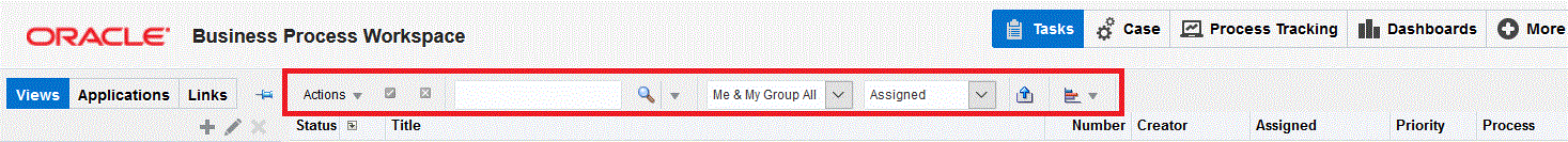

About the Process Workspace Tasks Page
The Tasks page displays tasks for the user based on the user's permissions and assigned groups and roles.
After a user logs in, the Home page displays the My Tasks page by default.
You can configure Process Workspace to display another page or change the order in which the links in the navigation bar appear when a user logs in. This is explained in How to Show or Hide the Default Tab Pages in Process Workspace. Each user can also configure their own default custom view.
The Tasks page enables you to do the following:
Perform authorized actions on tasks in the worklist, acquire and check out shared tasks, define personal to-do tasks, and define subtasks.

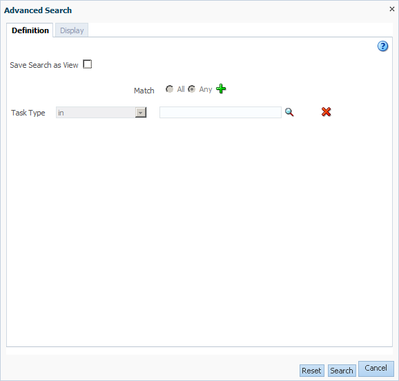

Filter tasks in a worklist view based on various criteria.
Export the tasks to Excel
Work with standard work queues, such as high priority tasks, tasks that are due soon, and so on.

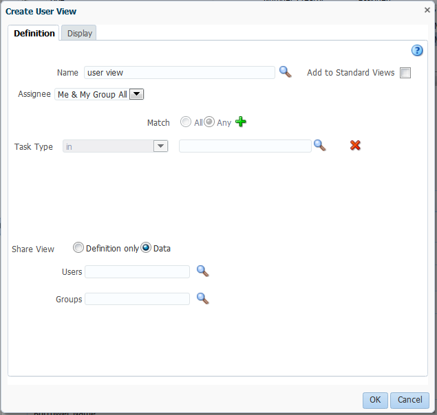

Work queues enable users to create a custom view to group a subset of tasks in the worklist—for example, high priority tasks, tasks due in 24 hours, expense approval tasks, and more.
Define custom work queues.

Navigating the Process Workspace Tasks Page
Figure 1-3 shows a sample Process Workspace tasks page as it appears by default when a user first logs in.

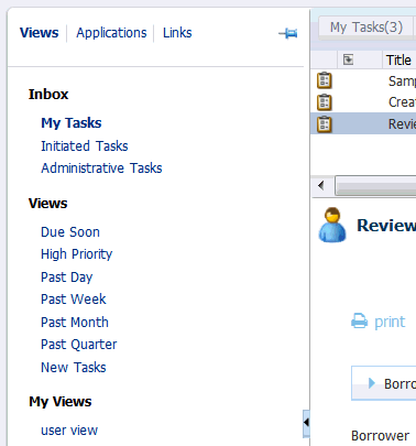

This page lists all the tasks and work items assigned to you, depending on your role.
At the far left is a list with My Tasks selected. Expand this list to select:
A particular view showing the number of open tasks for each view.
Selecting a particular view refreshes the task count to the latest number.
A list of applications deployed to Process Workspace.
Any links or applications you may have specified.
To keep this list visible while you work on tasks, click Pin. To hide it, click Unpin.
Table 1-7 lists and describes the items in the list of views, applications, and links.

In addition to the Views, Applications, and Links, the My Tasks page includes other components listed and described in Table 1-8.
Table 1-8 Components of the Tasks Page
| Component | Description |
Display Filters |
Specify search criteria from the Search, Assignee, or Status fields. The category filters available depend on which view is selected.
You can also perform an advanced search using several other criteria. For more information about searches, see Searching for Tasks in Process Workspace. |
Actions List |
Select a group action (Claim) or a custom action (for example, Approve or Reject) that was defined for the human task. Claim appears for tasks assigned to a group or multiple users; one user must claim the task before it can be worked. Other possible actions for a task, such as system actions, are displayed on the Task Details page for a specific task. You can also create To-Do tasks and subtasks here. When you select an action from Actions, a comment window appears. You must enter a comment and click OK to update the task and refresh the task list table. Click Cancel to cancel the action. |
Export to Excel |
You can export tasks in a selected view. |
Task Status |
A bar chart shows the status of tasks in the current view. |

Using the Process Workspace Task Details Page
Figure 1-4 shows an example of a Task Details page. This page is invoked by selecting a task from the inbox on the Process Workspace Tasks page. You can also view it in a pop-up browser window by double-clicking the task.
The Task Details page may appear differently depending on the tool used during design time to develop the task form it displays.
The task details page has the following components:
Basic information including the title of the task—for example, task 1—task number, creator, assignees, state, created date, the person who acquired the task, priority, expiration date, and other flex fields.
Previous Task/Next Task icons—For moving from one task to the previous or next task in the task list.
Action buttons—For custom actions defined for this human task during design time—for example, Resolved and Unresolved for a help desk request, or Approve and Reject for a loan request. After you complete your role in a task, for example, by making an approval, the task list refreshes accordingly and moves you to the next task in the task list.
For the administrator, the task initiator, or the manager, Withdraw may also appear.
The available task actions depend on the user role and the task. The task actions do not depend on the which view you have selected.
Other Actions—System task actions, beyond the custom actions defined for the task—as described in Performing System Actions in Process Workspace.
Content—The payload. The fields displayed are specific to how the human task was created during design time.
History Details—These are described in Task History.
Comments and Attachments:
Comments entered by various users who have participated in the workflow. A newly added comment and the commenter's user name are appended to the existing comments. A trail of comments is maintained throughout the life cycle of the task. To add a comment, you must have permission to update the task.
For information about how to add a comment, see Adding Comments and Attachments to Tasks in Process Workspace.
Attachments are documents or reference URLs associated with a task. These are typically associated with the workflow as defined in the human task during design time, or attached and modified by any of the participants using the task list. To add or delete an attachment, you must have permission to update the task. When adding file attachments, you can use an absolute path name or browse for a file.

How to Filter Tasks
Figure 1-6 shows the filter fields.
Figure 1-6 Filters: Assignee, Status, and Search
Description of "Figure 1-6 Filters: Assignee, Status, and Search"
Filters are used to display a subset of tasks and can be applied to your inbox view or other views. Filters are based on the following criteria:
Search: In the Search field, enter a keyword to search task titles, comments, identification keys, and the flex string fields of tasks that qualify for the specified filter criterion. Use the Search drop-down list to perform a regular or advanced search.

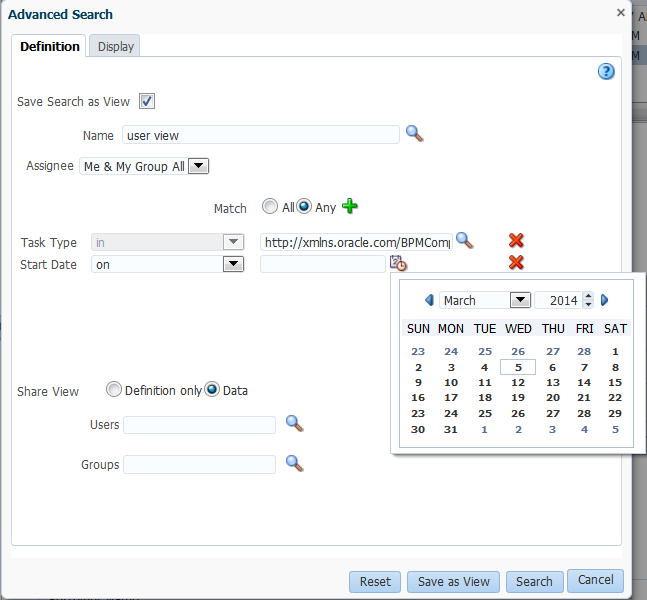

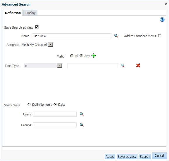

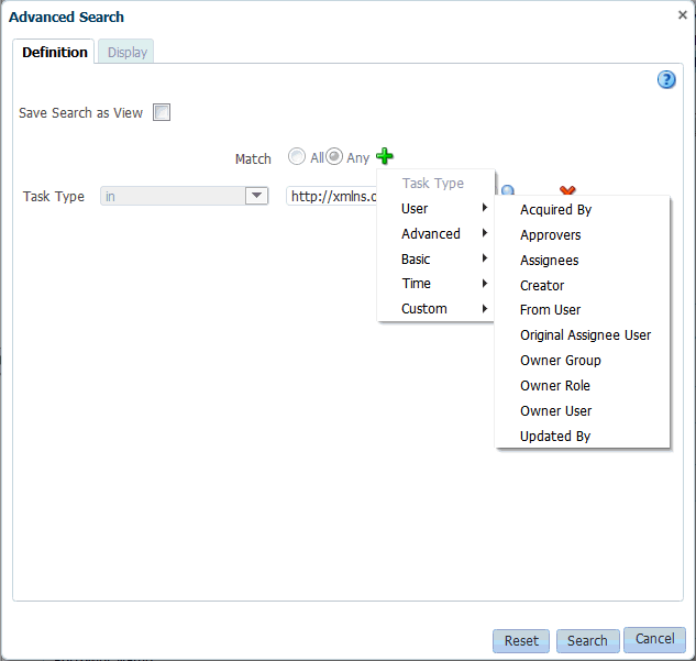

To filter tasks based on an advanced search
Mapped attribute labels can be used in an advanced search if you select task types for which mapped attribute have been defined.
See How to Specify Mapped Attributes for more information.
From the Search drop-down list, click Advanced.

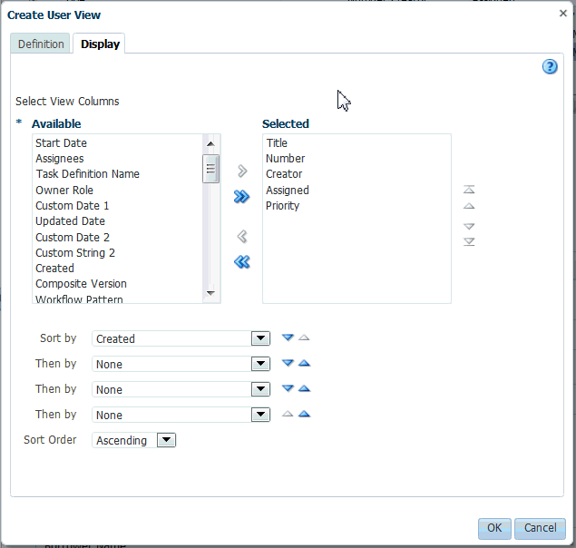

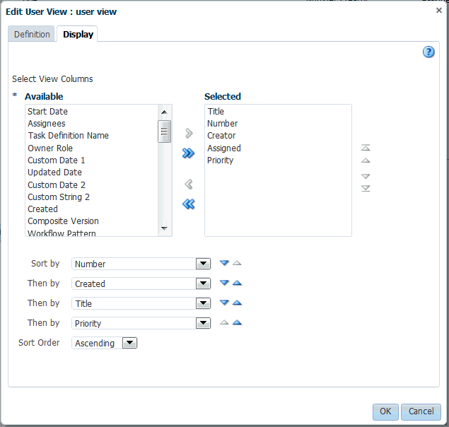

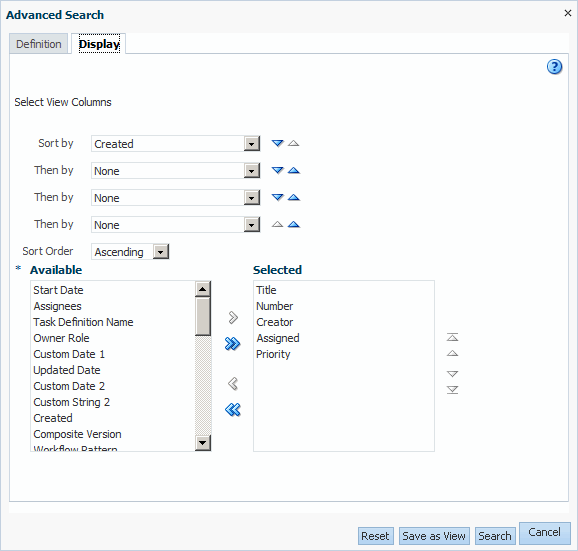

(Optional) Select Save As View, provide a view name, and use the Display page to provide other information, as shown in Figure 1-7 and Figure 1-8. If you do not select Save As View, the Display page is not available and the Definition page is as seen in Figure 1-9.
Selecting Save As View creates a customized view. The saved view appears under My Views.
Figure 1-7 Advanced Search: Definition Page
Description of "Figure 1-7 Advanced Search: Definition Page"Figure 1-9 Advanced Search Definition Tab - Display Tab Not Available
Description of "Figure 1-9 Advanced Search Definition Tab - Display Tab Not Available"Table 1-11 describes the advanced search view columns available in the Display page.
The titles: User Conditions, Advanced Condition, Time Conditions, Basic Conditions and Custom Conditions correspond to the menu categories for adding conditions (see Figure 1-12).
The saved view appears in the Views panel under My Views, as shown in Figure 1-10.

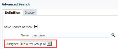

Select an assignee, as shown in Figure 1-11.
Figure 1-11 Selecting an Assignee for an Advanced Search
Description of "Figure 1-11 Selecting an Assignee for an Advanced Search" -
Select Any or All for matching multiple filters.
Add conditions (filters), as shown in Figure 1-12.
Figure 1-12 Adding Filters for an Advanced Search on Tasks
Description of "Figure 1-12 Adding Filters for an Advanced Search on Tasks"Table 1-11 describes the available conditions.
Table 1-11 Advanced Search: User Conditions
Condition Description Acquired By

Add parameter values as exemplified in Figure 1-13.
Browse for a task type or leave the field blank for all types. Mapped attribute labels can be selected in the query and display columns dialog boxes if the selected task types have mapped attribute mappings defined. Use the search option to search by task type, process name or category as shown in Figure 1-14.
Specify whether to share either this view's definition or its data, and the users or groups to share it with.
Click Search.
The task list appears with the tasks filtered according to your criteria.
How to Create and Customize Worklist Views
The Views menu, shown in Figure 1-15, displays your inbox, standard views, and any custom views you have created. Use it to create, share, and customize views.
To create a worklist view:
To customize an Inbox view
If you select to display the Task Display URL column, you must have an associated taskflow for the deployed task. The taskflow registration is performed during deployment. At that time, the Task Display URL column value is set. If the taskflow is not associated during deployment, the Task Display URL column does not display generic URL details for a task.
In the Views, Applications, and Links pane, select Views, then select the view you want to customize.
Click Edit View.
The Edit User View dialog box appears as shown in Figure 1-18.
Figure 1-18 Customizing Fields in a Worklist View
Description of "Figure 1-18 Customizing Fields in a Worklist View" -
Use the Edit User View dialog box to customize the view.
When you select and move items from the Available Columns list to the Selected Columns list (or vice-versa), the items remain selected. Therefore, if you select items to move back, the previously selected items are also moved. Ensure that you deselect items after moving them between the lists if you intend to move additional columns.
When you have finished making your settings, click OK.

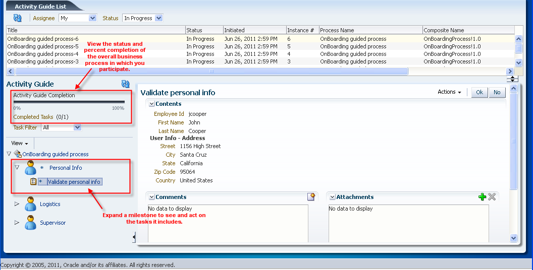

About the Process Workspace Activity Guides Page
Activity guides organize your tasks into milestones. Each milestone is a specific set of tasks for you to complete, either on your own or in collaboration with others.
For each milestone, the activity guide tells you which tasks to complete and in which order. You complete a milestone by completing all the tasks it contains for you. Depending on the nature of the task, you can save an unfinished task and resume it later.
Figure 1-19 shows an example of an activity guide.
Using an activity guide, you can:
Expand a milestone to see and act on the tasks it includes.
View the status and percent completion of the overall business process in which you participate.
For more information about navigating the Activity Guides page, see Navigating Activity Guides.
About the Process Workspace Process Tracking Page
Use the Process Tracking page to interact with business processes based on the roles assigned to you.
Using the Process Tracking tab, you can do the following:
View the list of process instances pending in your inbox.
Execute tasks, that is, carry out a human task on a particular instance.
Search for instances by different criteria.
Save the searches as a view.
View the details of an instance, including the audit trail.
Create a new instance, if you have permission to do so.
Attach a file to an instance.
Add notes to an instance.
Navigating the Process Workspace Process Tracking Page
Figure 1-20 Process Workspace Process Tracking Page
Description of "Figure 1-20 Process Workspace Process Tracking Page"
The Process Tracking page has these sections:
The Applications panel, which shows the list of applications available to you. Here you can perform basic Process Workspace actions, such as creating a new instance performing a given activity, or sorting applications.
Hovering over the name of an application in the Applications panel displays a tool tip with the application's full name and revision number.
The applications available in Process Workspace depend on the process design and the roles assigned to the user currently logged in. The list of available applications also depends on the BPM processes that are deployed and running. If no processes are running, or if you are not a participant able to execute an application in any of the processes currently running, then the applications panel is empty.
In the applications panel, you can sort either of the following:
Only the default versions of applications
All active versions of applications
You can sort either by name or by process version. You can filter the same applications by entering in the Search field either full or partial names or full or partial versions.
The Views panel, on the lower left half, displays the views available to you in an expandable tree
The Pending Components panel shows all suspended processes. If a new version of a process is deployed, and the previously deployed process has instances not yet migrated to the new version, then the previously deployed process is suspended. To resume it, either migrate or suspend any non-migrated instances. For information about resuming suspended processes, see How to Resume the Suspended Process Flow in Developing Business Processes with Oracle Business Process Management Studio.
The Work Items panel, on the upper right half, shows the task items corresponding to the view you have selected in the Views panel. In this panel, you can choose the columns that are presented in a given view. A particular column arrangement is known as a presentation. Clicking Add/Remove columns displays the Presentation dialog box in which you can define columns.
The following columns are available:
Actions
Activity
Activity Due Date
Copy
Creation Time
Deadline
Description
Has Attachments
Has Notes
Initiated
Initiator
Initiator Name
Instance #
Parent Copy
Participant
poID
Priority
Process Name
Process Due Date
Received
Status
Task Participant (that is, the participant that is currently executing an instance.)
Title
The Work Item Detail panel, on the lower right half, shows detailed information about a work item that you have selected in the Work Items panel. It has these sections:
Details: Shows the priority, process name, when the instance is due to complete, status, creation time, and the assignee if any.
Open Activities: Shows the status of any gateways with threads that are still running.
Audit Trail: Shows audit details in either a list view, a tree view, or graphical view. You can select the type of activity or sub-process you want to audit: human activities, service activities business rule activities, subprocesses, events, gateways, script activities, other activities, or all of the above.
If the process includes an input or output payload, then you can display the audit details for that message in a pop-up. Clicking on a particular activity displays the task history.
For more information about viewing audit details, see Viewing History.
Comments: Enables you to add Comments to the process instance.
Attachments: Enables you to add attachments to the process instance.
For more information about adding comments and attachments to a process instance, see Associating Comments and Attachments with a Process Instance.
About Process Workspace Dashboards
Two types of dashboards are available in Oracle Business Process Management Workspace (Process Workspace):
Process Monitor dashboards
Standard dashboards
Process monitor dashboards allow you to monitor and optimize process execution by identifying bottlenecks and other performance problems.
Standard dashboards present the standard metrics gathered during the execution of a process as graphs. They provide summary information and enable you to navigate to instance-specific information.
Figure 1-21 shows the Standard Dashboards page.
Figure 1-21 Process Workspace Standard Dashboards Page
Description of "Figure 1-21 Process Workspace Standard Dashboards Page"
For additional information about dashboards, see Using Dashboards in Process Workspace.
