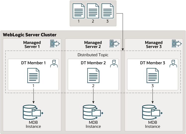

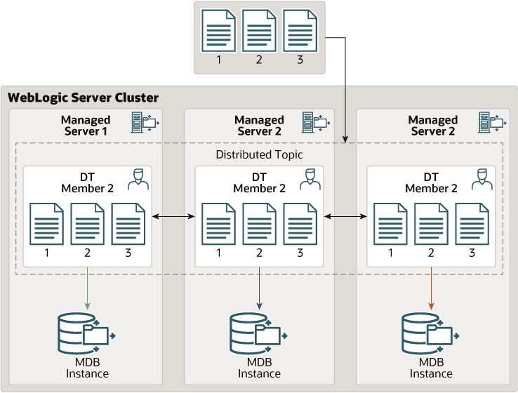

Figure A-1 Scenario 1: Replicated DT, One Copy Per Server, Local Deployment, Local Only Consumption
Description of "Figure A-1 Scenario 1: Replicated DT, One Copy Per Server, Local Deployment, Local Only Consumption"
In this scenario:
Copies of messages are forwarded to other servers in the cluster by the RDT.
One MDB pool is created on each server in the local cluster.
Each MDB pool listens to one of the distributed topic member on the same server.
This approach can yield higher performance than "RDT, One Copy Per Server, Local Deployment, EveryMember," because all messaging is local (it avoids transferring messages over network calls) and still ensures that all distributed topic members are serviced by MDB consumers. However for some use cases, the EveryMember alternative may work better, based on the trade-offs discussed in Handling Uneven Message Loads and/or Message Processing Delays.
This scenario does not work correctly for durable subscriptions when there are multiple members on the same server, when there are no members on any of the local servers that host the MDB application, or when JMS service migration (auto or manual) is involved.

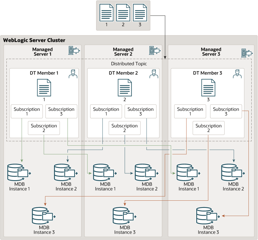

Figure A-2 Scenario 2: Replicated DT, One Copy Per Server, Local Deployment, Every Member Consumption
Description of "Figure A-2 Scenario 2: Replicated DT, One Copy Per Server, Local Deployment, Every Member Consumption"
In this scenario:
Copies of messages are forwarded to other servers in the cluster by the RDT, but these copies are filtered out (ignored) by the MDB subscriptions.
An MDB pool is created for each distributed topic member on each server in the local cluster.
Each MDB pool listens to one of the distributed topic members in the cluster.
Each Oracle WebLogic Server instance that hosts the MDB application listens to all members of the distributed topic.
Each server's subscribers on the same member of the DT have their own independent subscriptions. In other words, subscribers from different servers to the same member do not share any subscriptions.
This configuration yields high flexibility and is good for an application where an RDT is required, but it cannot be guaranteed that there will be exactly one member per server, for example due to migration.
This configuration does not give the best performance in comparison to Scenario 1: Replicated DT, One Copy Per Server, Local Deployment, Local Only Consumption, especially for a static environment where no migration is involved and there is one and only one member of the distributed topic on each managed server. Applications where no migration is involved and where there is one and only one member of the distributed topic on each managed server can use Scenario 1.

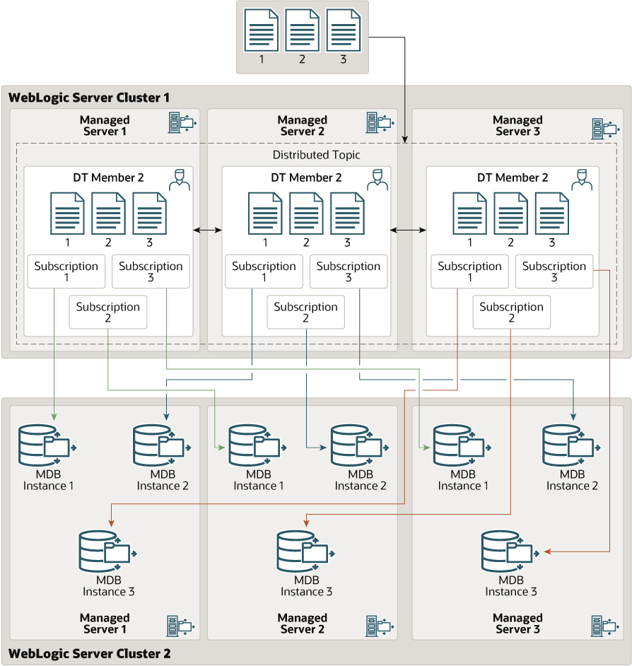

Figure A-3 Scenario 3: Replicated DT, One Copy Per Server, Remote Deployment
Description of "Figure A-3 Scenario 3: Replicated DT, One Copy Per Server, Remote Deployment"
In this scenario:
An MDB pool for each distributed topic member is created on each server in the remote cluster.
Each Oracle WebLogic Server instance that hosts the MDB application listens to all members of the distributed topic (one local pool for each remote member).
Each server's subscribers on the same member of the DT have their own independent subscription. In other words, subscribers from different servers to the same member do not share any subscriptions.
Note that this is the behavior for durable cases. For non-durable cases, each Oracle WebLogic Server instance creates a single MDB pool which connects to one of the members (any member) as an optimization.

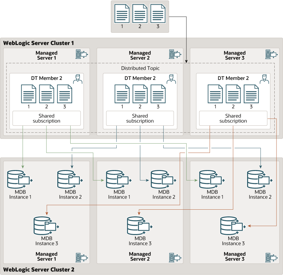

Figure A-6 Scenario 6: Replicated DT, One Copy Per Application, Remote Deployment
Description of "Figure A-6 Scenario 6: Replicated DT, One Copy Per Application, Remote Deployment"
In this scenario:
One MDB pool is created on each server in the local cluster for each member in the remote cluster.
A message is given to only one MDB pool.
All subscribers on the same member share the same subscription.

Scenario 8: Partitioned DT, One Copy Per Server, Local Deployment, Every Member Consumption
Figure A-7 shows the following configuration:
Partitioned distributed topic
topicMessagesDistributionMode=One-Copy-Per-Server. -
The MDB and the topic are deployed in the same (local) cluster.
distributedDestinationConnection=EveryMember.
Figure A-7 Scenario 8: Partitioned DT, One Copy Per Server, Local Deployment, Every Member Consumption
Description of "Figure A-7 Scenario 8: Partitioned DT, One Copy Per Server, Local Deployment, Every Member Consumption"
In this scenario:
Messages are distributed individually to the distributed topic members. Messages are not duplicated or copied to other members in the cluster.
Each server's subscribers on the same member of the DT have their own independent subscription. In other words, subscribers from a particular server to the same member do not share any subscriptions with subscribers from another server.
Parent topic: Partitioned Distributed Topic Scenarios

Scenario 10: Partitioned DT, One Copy Per Application, Local Deployment, Local Only Consumption
Figure A-8 shows the following configuration:
topicMessagesDistributionMode=One-Copy-Per-Application. -
distributedDestinationConnection=LocalOnly.
Figure A-8 Scenario 10: Partitioned DT, One Copy Per Application, Local Deployment, LocalOnly Consumption
Description of "Figure A-8 Scenario 10: Partitioned DT, One Copy Per Application, Local Deployment, LocalOnly Consumption"
In this scenario:
One MDB pool is created on each server in the local cluster for each local member (Figure A-9 shows a configuration where each Oracle WebLogic Server hosts only one member. When there are multiple members on the same local Oracle WebLogic Server, multiple MDB pools are created on each Oracle WebLogic Server instance).
This scenario is the recommended configuration for One-Copy-Per-Application and Local PT for high performance. However for some use cases, the EveryMember alternative may work better, based on the trade-offs discussed in Handling Uneven Message Loads and/or Message Processing Delays.
Scenario 11: Partitioned DT, One Copy Per Application, Local Deployment, Every Member Consumption
Figure A-10 shows the following configuration:
Figure A-9 Scenario 11: Partitioned DT, One Copy Per Application, Local Deployment, Every Member Consumption
Description of "Figure A-9 Scenario 11: Partitioned DT, One Copy Per Application, Local Deployment, Every Member Consumption"
For a partitioned distributed topic, one copy per application, local deployment, it is better to use LocalOnly consumption for most use cases, as shown in Scenario 10: Partitioned DT, One Copy Per Application, Local Deployment, Local Only Consumption. However the trade-offs discussed in Handling Uneven Message Loads and/or Message Processing Delays, apply here.
Scenario 12: Partitioned DT, One Copy Per Application, Remote Deployment
The MDB and the topic are deployed in different (remote) cluster.
distributedDestinationConnectionignored for remote deployments.
Figure A-10 Scenario 12: Partitioned DT, One Copy Per Application, Remote Deployment
Description of "Figure A-10 Scenario 12: Partitioned DT, One Copy Per Application, Remote Deployment"
In this scenario:
Subscriptions are created on all the distributed topic members automatically and dynamically.
All subscribers from the same MDB application on the same member share the same subscription.
