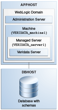

1.2 Understanding Oracle GoldenGate Veridata Installation Topology
Oracle GoldenGate Veridata Agent and Oracle GoldenGate Veridata Server are installed into an existing Oracle home containing Oracle Fusion Middleware Infrastructure.
Figure 1-1 Oracle GoldenGate Veridata Standalone Installation Topology
Description of "Figure 1-1 Oracle GoldenGate Veridata Standalone Installation Topology"
This topology represents a standard WebLogic Server domain that contains an Administration Server and a Managed Server on which the Infrastructure and Veridata Server are deployed. The domain is configured on a single host and requires a supported database where the Veridata Repository Database schema and required Fusion Middleware schema are installed.
All elements in this standard installation topology illustration are described in Table 1-1.
Table 1-1 Description of the Elements in the Standard Installation Topology
| Element | Description and Links to Additional Documentation |
APPHOST |
Standard term used in Oracle documentation referring to the computer that is hosting the application tier. |
DBHOST |
Standard term used in Oracle documentation referring to the computer that is hosting the database. |
WebLogic Domain |
A logically related group of Java components (in this case, the administration Server, Managed Servers, and other related software components). For more information, see Understanding Key Concepts in the Oracle Fusion Middleware Understanding Oracle Fusion Middleware Guide. |
Administration Server |
The central control entity of a domain which maintains the domain's configuration objects and distributes configuration changes to Managed Servers. For more information, see What Is the Administration Server in the Oracle Fusion Middleware Understanding Oracle Fusion Middleware Guide. |
Machine |
Logical representation of the computer that hosts one or more WebLogic Server instances (servers). Machines are also the logical glue between WebLogic Managed Servers and the Node Manager; in order to start or stop a Managed Server with Node Manager, the Managed Server must be associated with a machine. |
Managed Server |
Host for your applications, application components, Web services, and their associated resources. For more information, see Overview of Managed Servers and Managed Server Clusters in the Oracle Fusion Middleware Understanding Oracle Fusion Middleware Guide. |
Infrastructure |
Collection of services that include the following:
Oracle GoldenGate Veridata Server |
The Veridata Server coordinates the execution of Oracle GoldenGate Veridata tasks and processes information from multiple Veridata Agents. |
