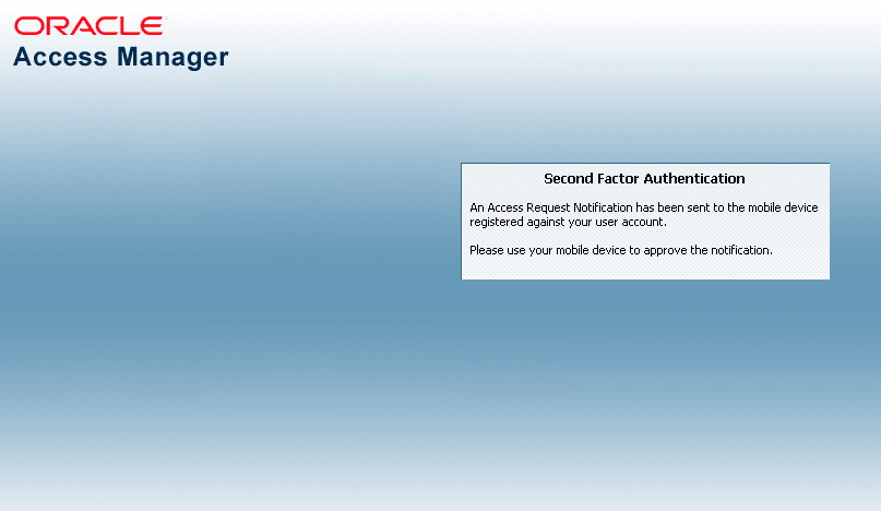

When the user selects Access Request Notification from the Second Factor Authentication Preferred Method Page, Access Manager sends an Access Request Notification to either the Apple Push Notification Server or the Google Notification Server depending upon the user's configured device. The notification server then pushes a notification to the mobile device and the user will approve or deny it. Based on a successful response, the user will be directed to the protected resource. On failure, an error message will be displayed and the user will be returned to the same OTP page.
Figure 35-4 shows the Access Request Notification message that is displayed during this process.
Figure 35-4 Access Request Notification Wait Screen
Description of "Figure 35-4 Access Request Notification Wait Screen"

35.4.8.9 Testing SFA through Push Notification
Test the push notification flow by accessing the protected resource and use the step-up authentication scheme to select the type of SFA required.
The user must see the name of the mobile device they are using.
Selecting the Access Request Notification option causes the OAM server to generate a push notification and deliver it to the GCM servers. That must show up on the users mobile device, where the user is asked to allow or deny the access.
By default, the OAM server checks for a user response every eight seconds. The browser briefly flashes as it waits until either the timeout period has passed and the browser displays an error message, or a user response is detected and the browser is redirected appropriately.
