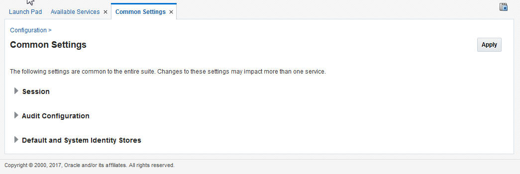

Common Settings
Common Settings apply to all services within the suite.
Figure 3-3 shows the named sections on the Common Settings page, which can be expanded to reveal related elements and values.
Figure 3-3 Common Settings Page (Collapsed View)
Description of Figure 3-3 follows
Description of "Figure 3-3 Common Settings Page (Collapsed View)"
Oracle Access Management Administrators can control and specify parameters used by the entire suite, not just a single service, as introduced in Table 3-3.

  1. At the top of the Console, click Configuration.
  2. In the Configuration Launch Pad, select Common Settings from the View menu in the Settings section.
  3. Session:
    1. On the Common Settings page, expand the Session section.
    2. Click the arrow keys beside each list to increase or decrease session lifecycle settings as needed:
      • Session Lifetime (minutes)
      • Idle Timeout (minutes)
      • Maximum Number of Sessions per User
    3. Click Apply to submit your changes.
    4. See Also: Maintaining Access Manager Sessions.

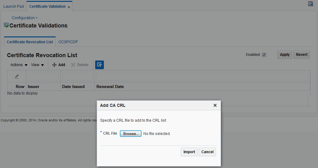

  1. In the Configuration Launch Pad section of the Oracle Access Management Console, click Certificate Validation.
    The Certificate Revocation List tab is displayed.
  2. Confirm that the Enabled box is checked.
  3. Add or remove a CRL.
    • Add: Click the Add (green plus sign) button, browse for the CRL file, select it, and click Import.
    • Remove: Click the name of the list in the table, click the Delete (x) button, and confirm when asked.
    Figure 3-4 is a screenshot of the pop-up window used to add a CA CRL to the CRL List using the Administrative Console.
    Figure 3-4 Certificate Revocation List Dialog Box
    Description of Figure 3-4 follows
    Description of "Figure 3-4 Certificate Revocation List Dialog Box"
  4. Click Apply to save the configuration.
  5. Proceed to "Enabling OCSP Certificate Validation".

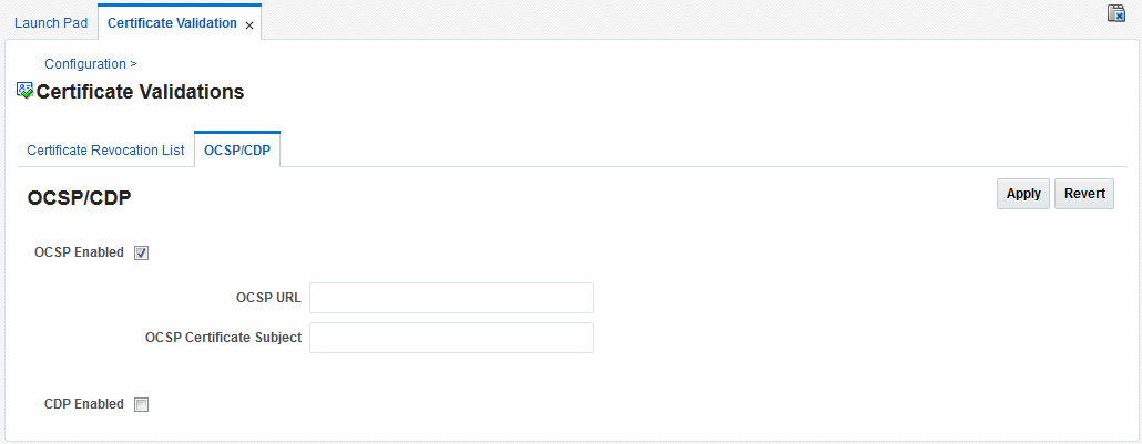

  2. Click the OCSP/CDP tab.
    1. Enable OCSP.
    2. Enter the URL of the OCSP Service.
    3. Enter the Subject DN of the OCSP Service.
    4. Save this configuration.
    Figure 3-5 illustrates how to add an OCSP URL using the Administration Console. See "WLST configureOAMOSCSPCertValidation" for details on how to do this using the WLST command.
  3. Proceed to "Enabling CRL Distribution Point Extensions".

  1. Under the Configuration section of the Oracle Access Management Console, click Certificate Validation.
    The Certificate Revocation List page is displayed. Confirm that the Enabled box is checked.
  2. Open the OCSP/CDP tab.
    1. Enable CDP.
    2. Save this configuration.
    Figure 3-5 illustrates this.

To enable OCSP validation to be done using one configured responder URL, set the certpathvalidationcrlenabled and certpathvalidationocspenabled properties to true and set values for the certpathvalidationocspcertsubject and certpathvalidationocspurl properties. If these properties are not set, OCSP validation will be done using the responder URL defined within the user certificate's AIA Extension. If no URL is defined, OCSP validation will fail.
WLST updateHTTPProxyConfig
The Oracle Access Manager OCSP checker can perform authentication against OCSP responders that are outside an enterprise's intranet through HTTP Proxy.
Use the updateHTTPProxyConfig WLST command to configure the OAM OCSP checker to use HTTP proxy.
