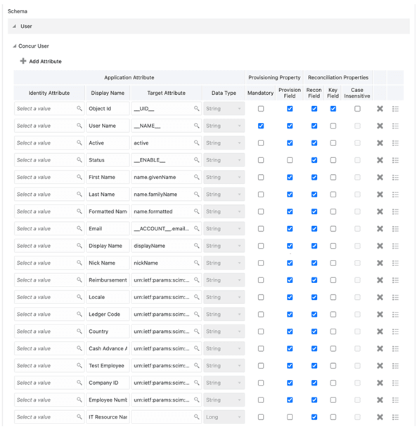

3.3 Attribute Mappings for the Target Application
The Schema page for a target application displays the default schema (provided by the connector) that maps Oracle Identity Governance attributes to target system attributes. The connector uses these mappings during reconciliation and provisioning operations.
The following table lists the user-specific attribute mappings between the process form fields in Oracle Identity Governance and Oracle Primavera target application attributes. The table also lists whether a specific attribute is used during provisioning or reconciliation and whether it is a matching key field for fetching records during reconciliation.
If required, you can edit the default attribute mappings by adding new attributes or deleting existing attributes as described in Creating a Target Application Oracle Fusion Middleware Performing Self Service Tasks with Oracle Identity Governance.
Table 3-3 Default Attribute for SAP Concur Target Application

Figure 3-1 shows the default user account attribute mappings.
Figure 3-1 Default Attribute Mappings for Concur User Account
Description of Figure 3-1 follows
Description of "Figure 3-1 Default Attribute Mappings for Concur User Account"

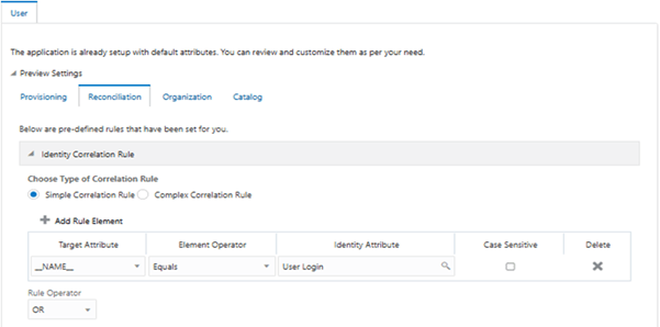

3.4 Correlation Rules for the Target Application
Learn about the predefined rules, responses, and situations for Target applications. The connector uses these rules and responses for performing reconciliation.
When you create a target application, the connector uses correlation rules to determine the identity to which Oracle Identity Governance must assign a resource.
Predefined Identity Correlation Rule SAP Concur Connector
By default, the SAP Concur connector provides a simple correlation rule when you create a target application. The connector uses this correlation rule to compare the entries in Oracle Identity Governance repository and the target system repository, determine the difference between the two repositories, and apply the latest changes to Oracle Identity Governance.
The following table lists the default simple correlation rule for a SAP Concur connector. If required, you can edit the default correlation rule or add new rules. You can create simple correlation rules also. For more information about adding or editing simple or complex correlation rules, see Updating Identity Correlation Rules in Oracle Fusion Middleware Performing Self Service Tasks with Oracle Identity Governance
Table 3-6 Predefined Identity Correlation Rule for an SAP Concur Connector
Target Attribute Element Operator Identity Attribute Case Sensitive?
__NAME__
Equals
User Login
No
In this identity rule:
  • __NAME__ is a single-valued attribute on the target system that identifies the user account
  • User Login is the field on the OIG User form
The following figure shows the Simple Correlation Rule for SAP Concur Target Application
Figure 3-4 shows the simple correlation rule for the Concur connector.
Figure 3-4 Predefined Identity Correlation Rules
Description of Figure 3-4 follows
Description of "Figure 3-4 Predefined Identity Correlation Rules"
