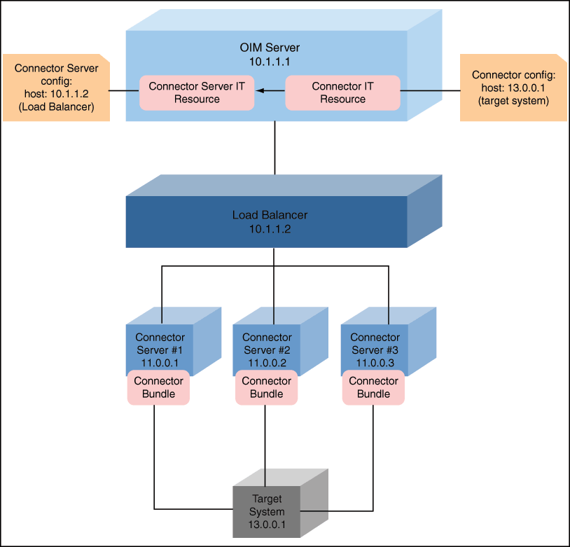

If there are multiple connector servers, then you must ensure the high availability of the connector server for the remote execution of the Identity connector and failover management.
Figure 9-1 depicts the typical configuration for a cluster of connector servers. The flow in the figure is based on the assumption that the required connector bundle is deployed across all the connector servers.
Figure 9-1 Connector Server Load Balancer
Description of Figure 9-1 follows
Description of "Figure 9-1 Connector Server Load Balancer"
9.1.2 Configuring the Load Balancer for a Connector Server
Configuring the load balancer for a connector server involves pointing a connector server IT resource to the host deployed with the load balancer.
To configure the load balancer for a connector server:
  1. Install connector server on nodes including the connector bundle. This involves copying and running the server binaries on all nodes.
  2. Setup your load balancer so that every request on port 8759 (default for connector server, which is configurable) is being load balanced across the nodes created in Step 1.
  3. Create a connector server IT resource, and point it to your host deployed with load balancer.
  4. Configure your connector IT resource with the following details:
    • host: target address
    • connector server name: use the name created in Step 3.
      You must make sure to double-check that the incoming port of load balancer is same as the one given in connector server IT resource. In addition, you must check that the ports set up for cluster nodes match the one used for configuring your load balancer.
