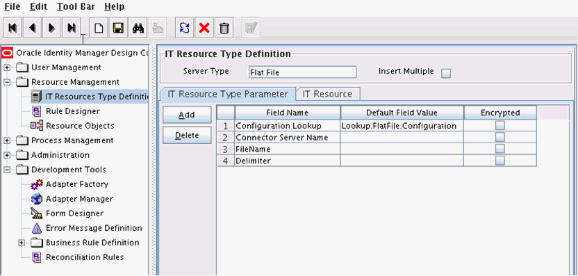

6.2.2.1 Creating the IT Resource Type Definition
An IT resource type definition is the representation of a resource's connection information. The configuration parameters in the IT resource type definition should be matched with the configuration parameters of the connector bundle. The values of the parameters in the IT resource will be set in the bundle configuration.
You may include parameters the bundle configuration is not using. They produce no negative effects on the bundle operations.
To create the IT resource type definition:

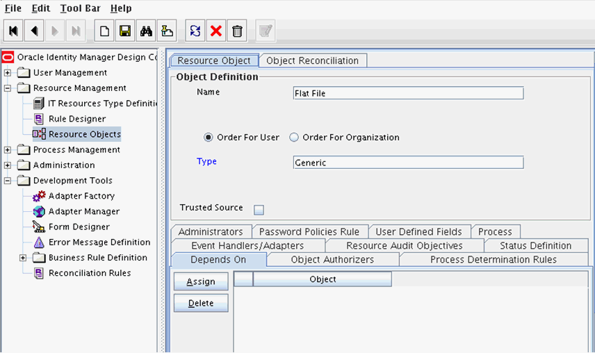

6.2.2.2 Creating the Resource Object
The resource object is the Oracle Identity Manager representation of a resource. The connector bundle is tied to the resource object.
To create the resource object:

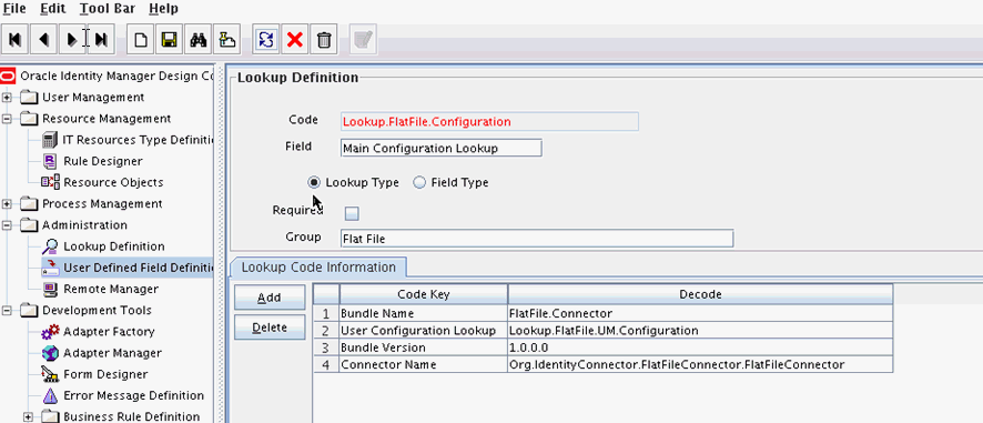

6.2.2.3.1 Creating the Main Configuration Lookup
The Configuration Lookup (as defined in Creating the IT Resource Type Definition) holds connector bundle configurations that are not counted as connection information. If a configuration parameter is not found in the IT Resource Type Definition, Oracle Identity Manager will look in the Configuration Lookup. The main Configuration Lookup contains bundle properties and bundle configurations. Bundle Property parameters are mandatory as they are needed for identifying the correct bundle. Bundle configurations that are not defined as part of the IT resource type definition (discussed in Creating the IT Resource Type Definition) can be declared here.
The values for Code Key should match exactly as illustrated. The values for Decode are specific to the connector bundle.
To create the main configuration lookup:

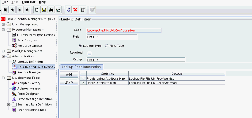

6.2.2.3.2 Creating Object Type Configuration Lookup
Object type configuration lookup contains the parameters specific to the particular object type. Object type is an entity over which an identity connector operates. It is mapped to ICF ObjectClass. In Creating the Main Configuration Lookup, User Configuration Lookup has been referenced so that User is the object type, in this case mapped to ObjectClass.ACCOUNT. (Roles and UserJobData are two other object types.) The object type name has to match with ObjectClass name supported by the identity connector bundle. The User object type is mapped to predefined ObjectClass.ACCOUNT, the Group object type is mapped to predefined ObjectClass.GROUP. If the identity connector supports multiple objects, then this step must be repeated for each.
Because these use cases cover only the basic functionality, the configuration is kept to the mandatory attribute.
To create the object type configuration lookup:

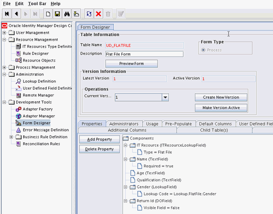

6.2.3.1 Creating a Process Form
A process form is used as the representation of object attributes on Oracle Identity Manager.
This section describes process forms and how to create a process form. It contains the following topics:
6.2.3.1.1 About Process Forms
A process form is used as the representation of object attributes on Oracle Identity Manager. This facilitates user input to set object attributes before passed to the connector bundle for an operation.
Attributes defined in the process form are not conventions. The form is a way to challenge the attributes that need to be passed to the identity connector. In general, define an attribute for each supported attribute in the identity connector.
It is good practice to have a one to one mapping on the identity connector attributes.
There should be a field for querying the IT resource that should be associated with the respective IT Resource Type Definition. Variable type of each field should map to the type of the object attribute.

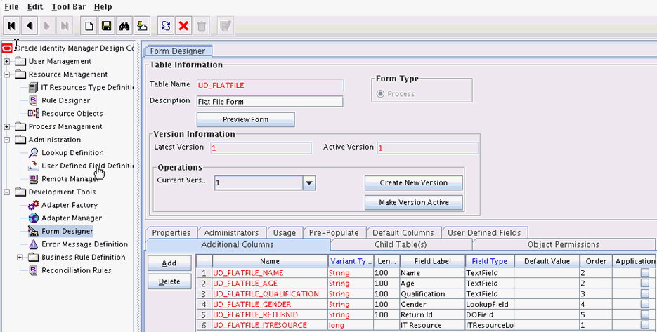

6.2.3.1.3 Attributes in the Connector Schema
Table 6-1 lists the attributes defined in the connector schema.
Table 6-1 Form Designer Fields
| Name | Variant | Field Label | Field Type |
UD_FLATFILE_NAME |
String |
Name |
TextField |
UD_FLATFILE_AGE |
String |
Age |
TextField |
UD_FLATFILE_QUALIFICATION |
String |
Qualification |
TextField |
UD_FLATFILE_GENDER |
String |
Gender |
LookupField |
UD_FLATFILE_RETURNIDQ |
String |
Return Id |
DOField |
UD_FLATFILE_ITRESOURCE |
Long |
IT Resource |
ITResourceLookup |
The flat file column names are FirstName, ChangeNo, EmailID, Server, LastName, and AccountID.

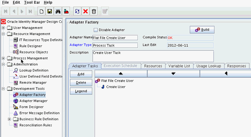

6.2.3.2 Creating Adapters
An adapter has to be created for all operations supported by the connector bundle, including Create, Update, and Delete.

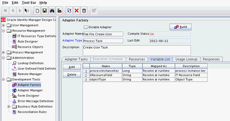

To create the adapter:
Log in to the Oracle Identity Manager Design Console.
Click Adapter Factory under Development Tools.
Create a new adapter and add Flat File Create User as the Adapter Name.
Add Process Task as the Adapter Type.
Save the adapter.
Click the Variable List tab and add the following variables, as shown in Figure 6-7.
objectType with Type String and Mapped as Resolve at runtime.
processInstanceKey with Type long and Mapped as Resolve at runtime.
itResourceFieldName with Type String and Mapped as Resolve at runtime.
Figure 6-7 Adapter Factory Variable List in Design Console
Description of "Figure 6-7 Adapter Factory Variable List in Design Console" -
Add a Java functional task to the adapter by following this sub procedure, as shown in Figure 6-8.
Click the Adapter Tasks tab.
Select the adapter and click Add.
Select Java from the task options.
Select icf-oim-intg.jar from the API source.
Select oracle.iam.connetors.icfcommon.prov.ICProvisioninManager as the API Source.
Select createObject as the method for the task.
Save the configurations.
Map the variables (previously added to the Variables List) against the appropriate method inputs and outputs.
Map the configuration parameters against the appropriate method inputs and outputs.
Database Reference maps to Database Reference (Adapter References) and Return Variable maps to Return Variable (Adapter Variables).
Figure 6-8 Adapter Factory in Design Console
Description of "Figure 6-8 Adapter Factory in Design Console" -
Save and build the adapter.

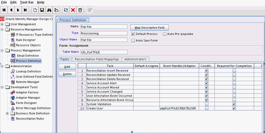

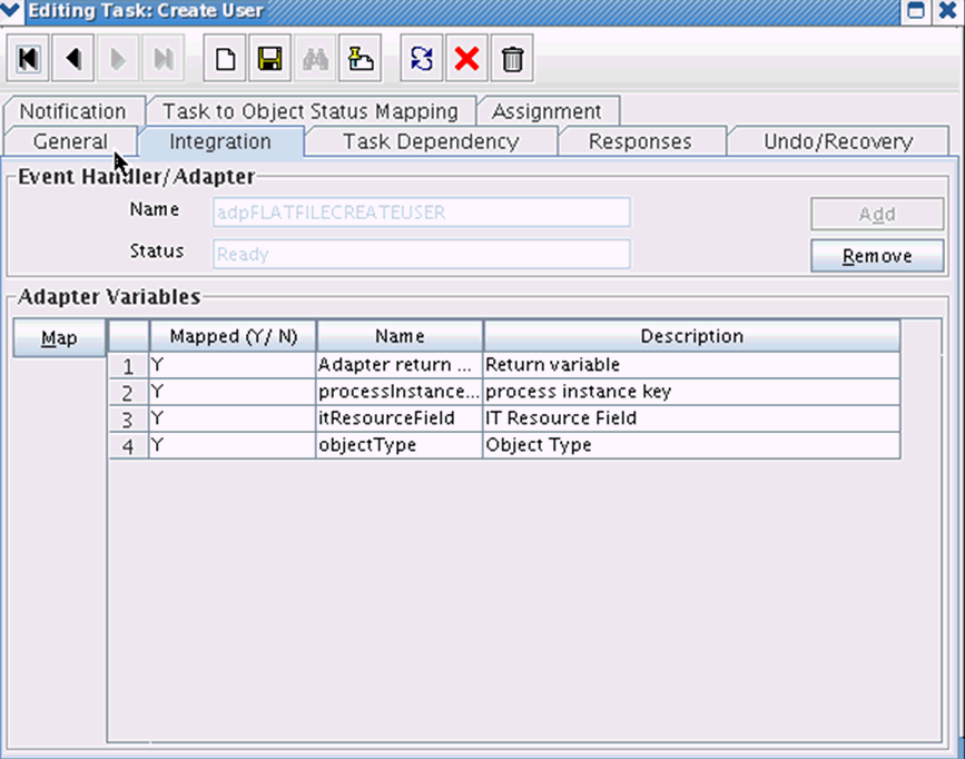

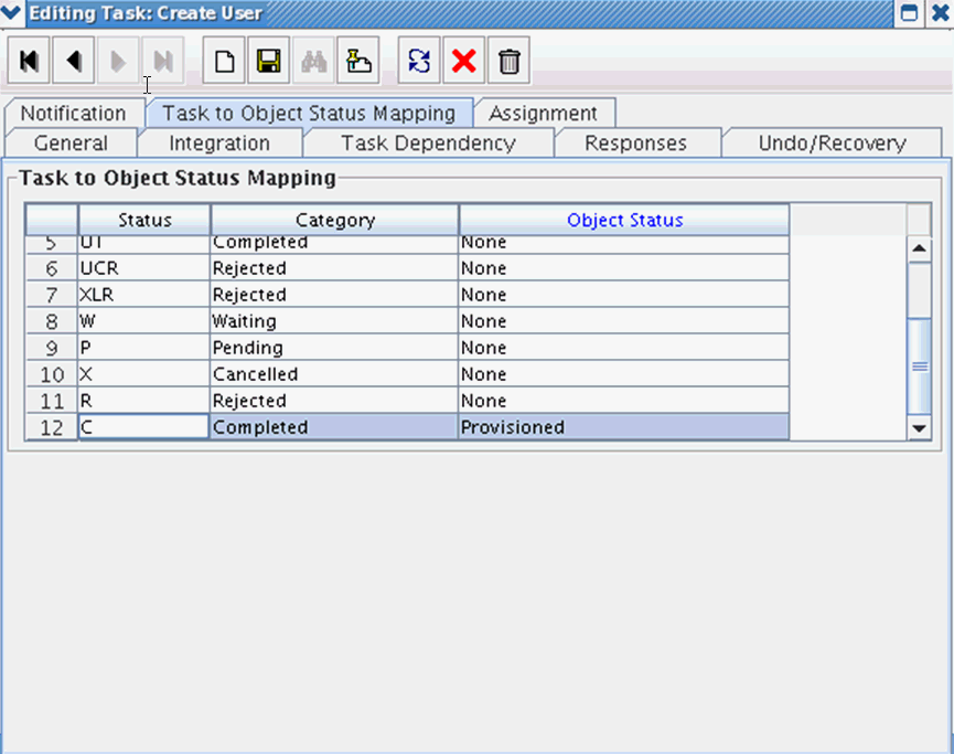

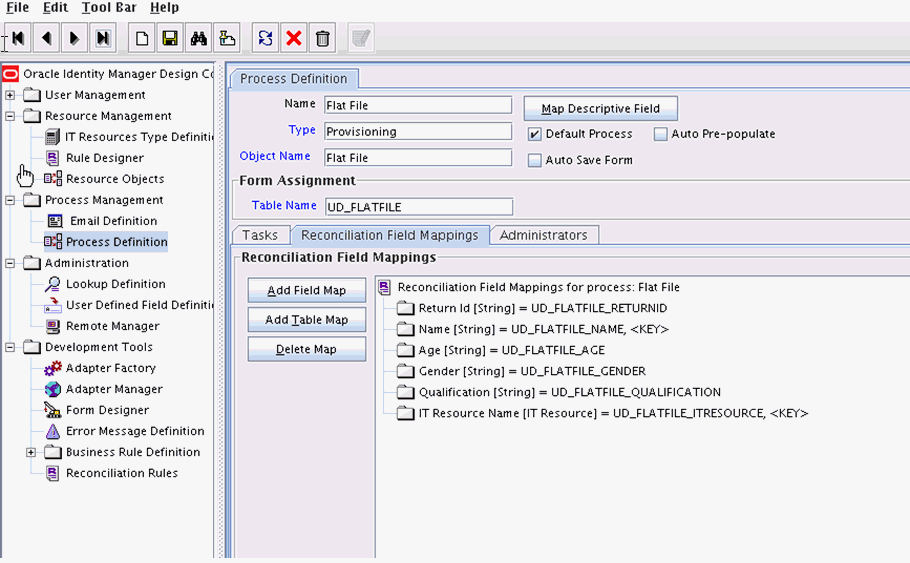

6.2.3.3 Creating a Process Definition
Process Definition defines the behavior of the connector bundle for a particular operation. Every operation has a corresponding task associated with it.
The following procedure will configure the process definition and integration of the process task for the Create operation:

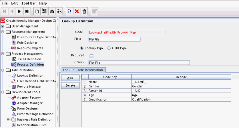

6.2.3.4 Creating a Provisioning Attribute Mapping Lookup
Provisioning Attribute Mapping Lookup contains mappings of Oracle Identity Manager fields to identity connector bundle attributes.
This section describes how to create the Provisioning Attribute Mapping Lookup. It contains the following topics:
6.2.3.4.1 About Provisioning Attribute Mapping Lookup
Provisioning Attribute Mapping Lookup contains mappings of Oracle Identity Manager fields to identity connector bundle attributes. In the Provisioning Attribute Mapping Lookup:
Code keys are Field Labels of the process form.
Decodes are identity connector bundle attributes.
Child form attributes can be configured as embedded objects in inputs.
The identity connector's provisioning operation returns the UID in response. This can be set in a form field by coding it against the identity connector bundle attribute.
6.2.3.4.2 Creating a Provisioning Attribute Mapping Lookup
Following is the procedure to create a Provisioning Attribute Mapping Lookup.

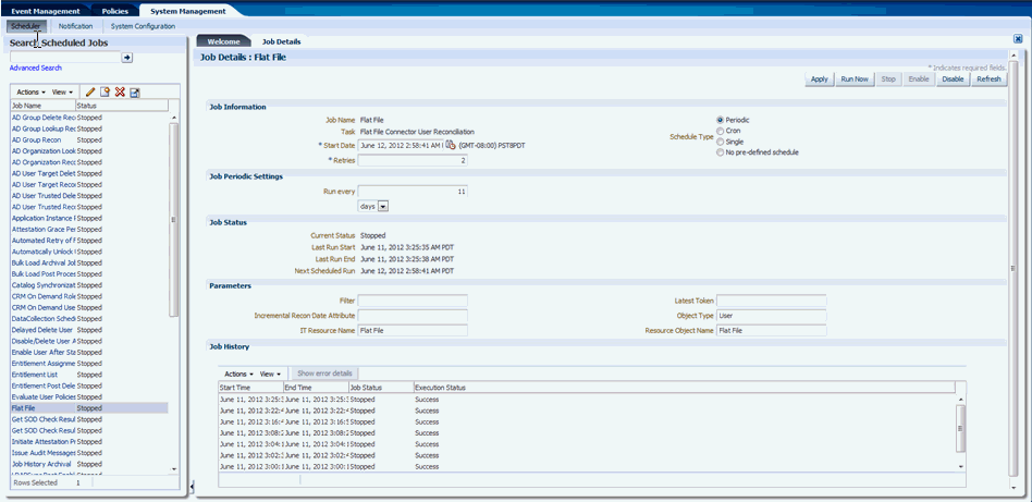

6.2.4.1 Creating a Reconciliation Scheduled Task
By default, reconciliation uses a Search operation on the connector bundle. This operation is invoked with a schedule task configured using Oracle Identity Manager. This procedure is comprised of the following subprocedures:

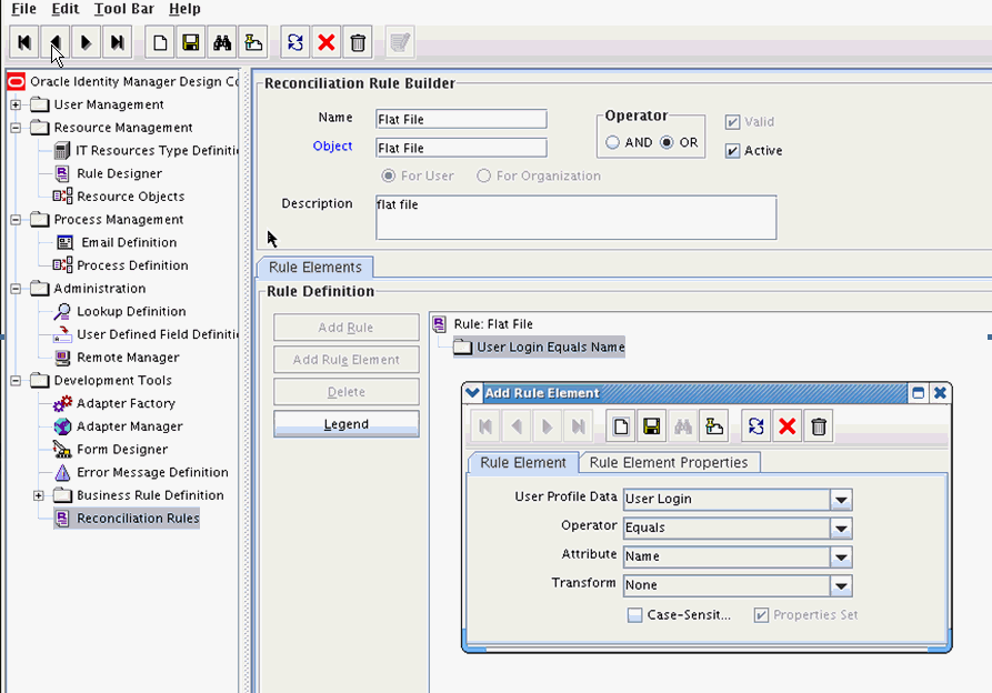

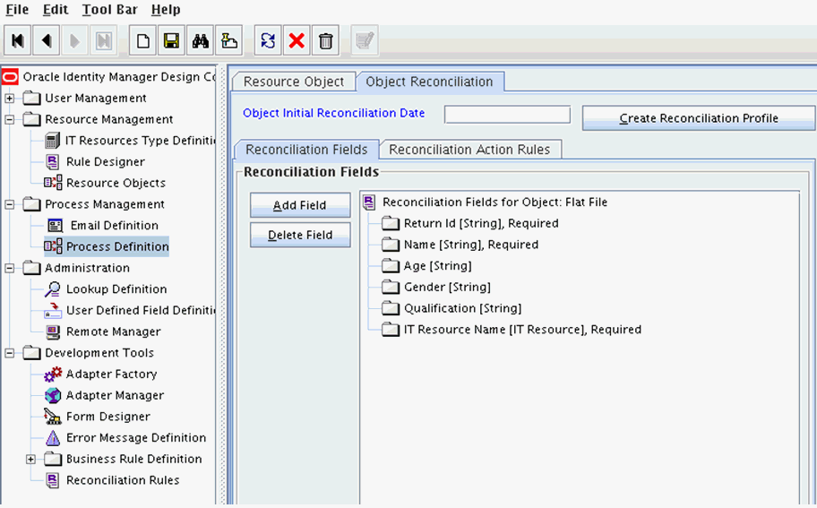

6.2.4.2 Creating a Reconciliation Profile
A reconciliation profile defines the structure of the object attributes while reconciliation. The reconciliation profile should contain all the attributes that have reconciliation support.
To create a reconciliation profile:

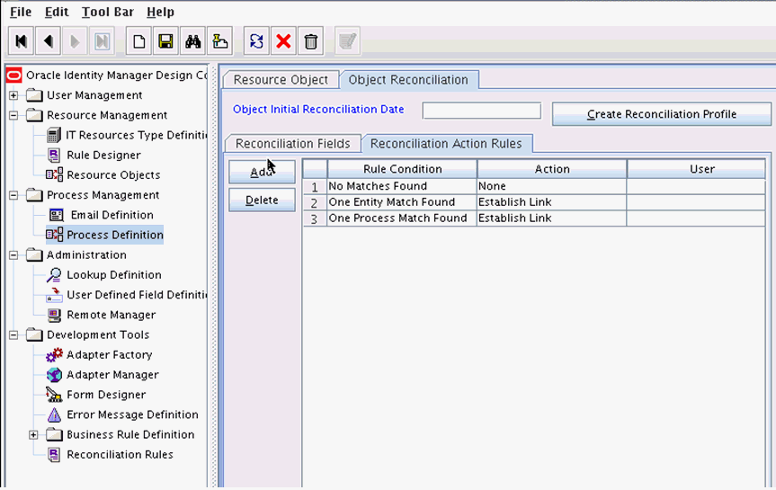

6.2.4.3 Setting a Reconciliation Action Rule
A Reconciliation Action Rule defines the behavior of reconciliation. In this procedure, define the expected action when a match is found. This procedure assumes you are logged into the Oracle Identity Manager Design Console.
6.2.4.4 Creating Reconciliation Mapping
The reconciliation mapping has to be done in the process definition. This is to map the supported reconciliation fields (from resource object) to the process form fields. This mapping is needed only for configuring target reconciliation.
To create the reconciliation mapping:
6.2.4.5 Field Flags Used in the Reconciliation Attributes Map
For reconciliation attributes mapping, the following field flags can be appended to the code key:
TRUSTED: This must be specified in the Recon Attribute Map for the field that represents the status of the account. This flag must be specified only for trusted reconciliation. If this is specified, then the status of the account is either Active or Disabled. Otherwise, the status is either Enabled or Disabled. For example, the code key for a field with label Status whose value needs to be either Active/Disabled must look similar to Status[TRUSTED].
DATE: In Recon Attribute Map, this must be specified for fields whose type need to be considered as Date. For example, the code key for a field with label Today whose value needs to be displayed in the date format must look similar to Today[DATE].
6.3 Provisioning a Flat File Account
Provisioning a Flat File account involves creating an IT resource of type Flat File with IT resource and Lookup.FlatFile.Configuration parameters.
The flat file connector is ready to work. So the user needs to log in to Oracle Identity Manager and create an IT resource (target) using the following procedure.
Create IT resource of type "Flat File".
Provide the IT resource parameters as appropriate.
Provide the configuration parameters in Lookup.FlatFile.Configuration as appropriate.
