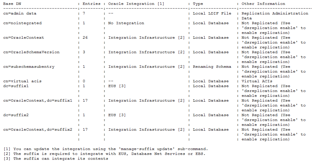

17.2.2 Creating a Non-Integrated Suffix Using manage-suffix
You can create a non-integrated suffix using the manage-suffix command. In the following examples, a new suffix is created in different DB and using a different network group than in the previous examples. The new suffix is not configured for integration with an Oracle product.
17.2.2.1 Creating a Non-Integrated Suffix Using the Non-Interactive CLI Mode
You can create a non-integrated suffix using the non-interactive CLI mode by running the manage-suffix create command with the following arguments:
$ manage-suffix create \
--baseDN cn=nointegrated \
--entries base-entry \
--integration no-integration \
--networkGroup network-group2 \
--workflowElement userRoot2 \
--dbPath config/db \
--hostname host1.local \
--port 4444 \
--bindDN cn=Directory\ Manager \
--bindPasswordFile ****** \
--trustAll \
--no-prompt17.2.2.2 Creating a Non-Integrated Suffix Using the Interactive CLI Mode
You can create a non-integrated suffix using the interactive CLI mode by running the manage-suffix create command with the following arguments:
$ manage-suffix -h localhost -p 4444 -D "cn=directory manager" -j pwd-file -X --advanced
Reading Configuration ..... Done.
What do you want to do?
1) Create Suffixes
2) Delete Suffixes
3) Update Suffixes
4) List the Suffixes
q) quit
Enter choice [1]:
Provide the DNs of the suffixes to be created. Leave empty when you have

17.2.3 Viewing Suffix Information
Use the manage-suffix list command to view information about local, configured suffixes. Use the --advanced option when you want to view information about internal suffixes with advanced configurations.
For example, use the --advanced option when you want to view internal suffixes used to configure integration among Oracle Unified Directory and other Oracle products.
You can run manage-suffix list in non-interactive or interactive CLI mode. For a complete list of options and usage, run the following command:
$ manage-suffix list --help
This section contains the following examples:
17.2.3.1 Displaying Suffix Information Using Default Options
You can display the suffix information using default manage-suffix options.
Run the manage-suffix command as follows:
$ manage-suffix -h localhost -p 4444 -D "cn=directory manager" -j pwd-file -X -n
17.2.3.2 Displaying a Set of Suffixes
To display only a set of suffixes, use the --baseDN argument to specify which suffixes must be displayed. If no --baseDN argument is provided, all suffixes are displayed. You can also use the --advanced argument to display the internal suffixes.
The --listDataToDisplay argument is an informative argument that lists and describes the different allowed values for the argument --dataToDisplay.
Use the --dataToDisplay argument to specify which information is displayed.
The example in this section provides information for only suffix dc=suffix2 and only the network group and workflow element are displayed.
$ manage-suffix list --baseDN dc=suffix2 -X --dataToDisplay network-group --dataToDisplay workflow-element -j pwd-file -X -n Reading Configuration ..... Done. Base DN : Wfe [1] : N.G. [2] ------------:-----------:--------------- dc=suffix2 : userRoot : network-group [1] The name of the configuration entity (workflow element) containing the data. If the data of the data is not stored locally, it returns the name of the first workflow element associated with the suffix [2] The name of the network groups that expose the contents of this suffix

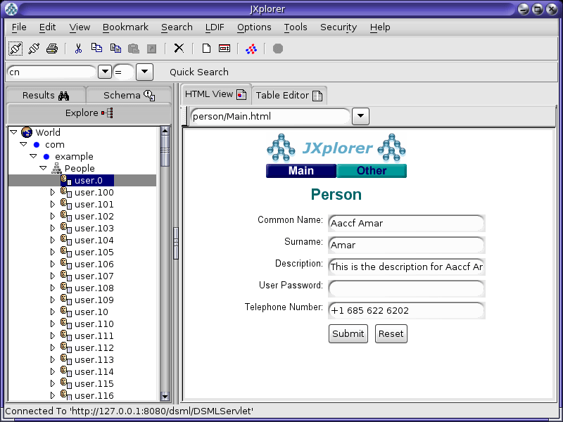

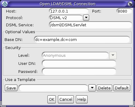

17.6.2.1 Confirming the DSML Gateway Deployment Using JXplorer
The JXplorer tool is a Java-based LDAP browser that can be used to browse, search, and edit the contents of an Oracle Unified Directory instance. This tool can communicate using both LDAP and DSML. Although JXplorer's DSML support does not allow authentication (and therefore is restricted to the set of operations available to anonymous users), it is still possible to use it to verify that the DSML gateway is functioning as expected.
You can download JXplorer, and the accompanying documentation, at jxplorer.org.
To confirm a DSML gateway using JXplorer, follow these steps:
