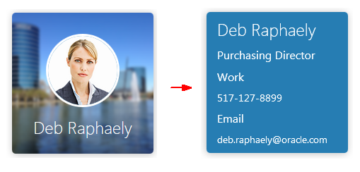

The following image shows a simple Oracle JET composite component named demo-card that displays contact cards with the contact’s name and image if available. When the user selects the card, the content flips to show additional detail about the contact.

    The demo-card example defines properties for the composite component and the contact’s full name, employee image, title, work number, and email address. The required properties are highlighted in bold.

    This basic demo-card example only defines properties for the composite component. You can also add metadata that defines methods and events as shown in the cookbook’s Composite Component - Events example. The metadata lists the name of the method or event and supported parameters.

  6. In the composite component’s root folder, add the View definition to composite-name-view.html, creating the file if needed.
    The View for the demo-card composite component is shown below. Any property defined in the component’s metadata is accessed using the $properties property of the View binding context.
    <div tabindex="0" role="group" class="demo-card-flip-container"
      on-click="[[flipCard]]" on-keypress="[[flipCard]]" :aria-label="[[$properties.name + ' Press Enter for
    more info.']]">
      <div class="demo-card-front-side">
        <oj-avatar class="demo-card-avatar" role="img" size="lg" initials="[[initials]]"
    src="[[$properties.avatar]]" :aria-label="[['Avatar of ' + $properties.name]]">
        </oj-avatar>
        <h2>
          <oj-bind-text value="[[$properties.name]]"></oj-bind-text>
        </h2>
      </div>
      <div class="demo-card-back-side">
        <div class="demo-card-inner-back-side">
          <h2>
          </h2>
          <h5>
            <oj-bind-text value="[[$properties.workTitle]]"></oj-bind-text>
          </h5>
          <oj-bind-if test="[[$properties.workNumber != null]]">
            <h5>Work</h5>
            <span class="demo-card-text"><oj-bind-text value="[[workFormatted]]"></oj-bind-text></span>
          </oj-bind-if>
          <oj-bind-if test="[[$properties.email != null]]">
            <h5>Email</h5>
            <span class="demo-card-text"><oj-bind-text value="[[$properties.email]]"></oj-bind-text></span>
          </oj-bind-if>
        </div>
      </div>
    </div>
    For accessibility, the View’s role is defined as group, with aria-label specified for the contact’s name. In general, follow the same accessibility guidelines for the composite View markup that you would anywhere else within the application.
