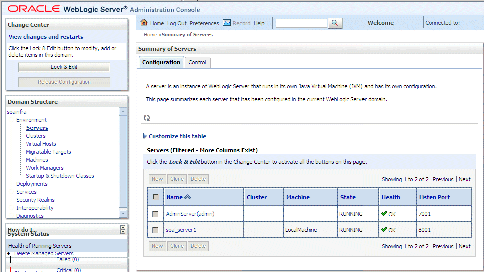

Finding Port Information
You can find port number information in the following ways:
  • From Oracle WebLogic Server Administration Console
    1. Log in to the console.
    2. In the Domain Structure pane, shown in Figure 2-2, expand Environment and click Servers.
      Figure 2-2 Domain Structure Nodes in Oracle WebLogic Server Administration Console
      Description of Figure 2-2 follows
      Description of "Figure 2-2 Domain Structure Nodes in Oracle WebLogic Server Administration Console"
    3. Note the Listen Port column for your server.

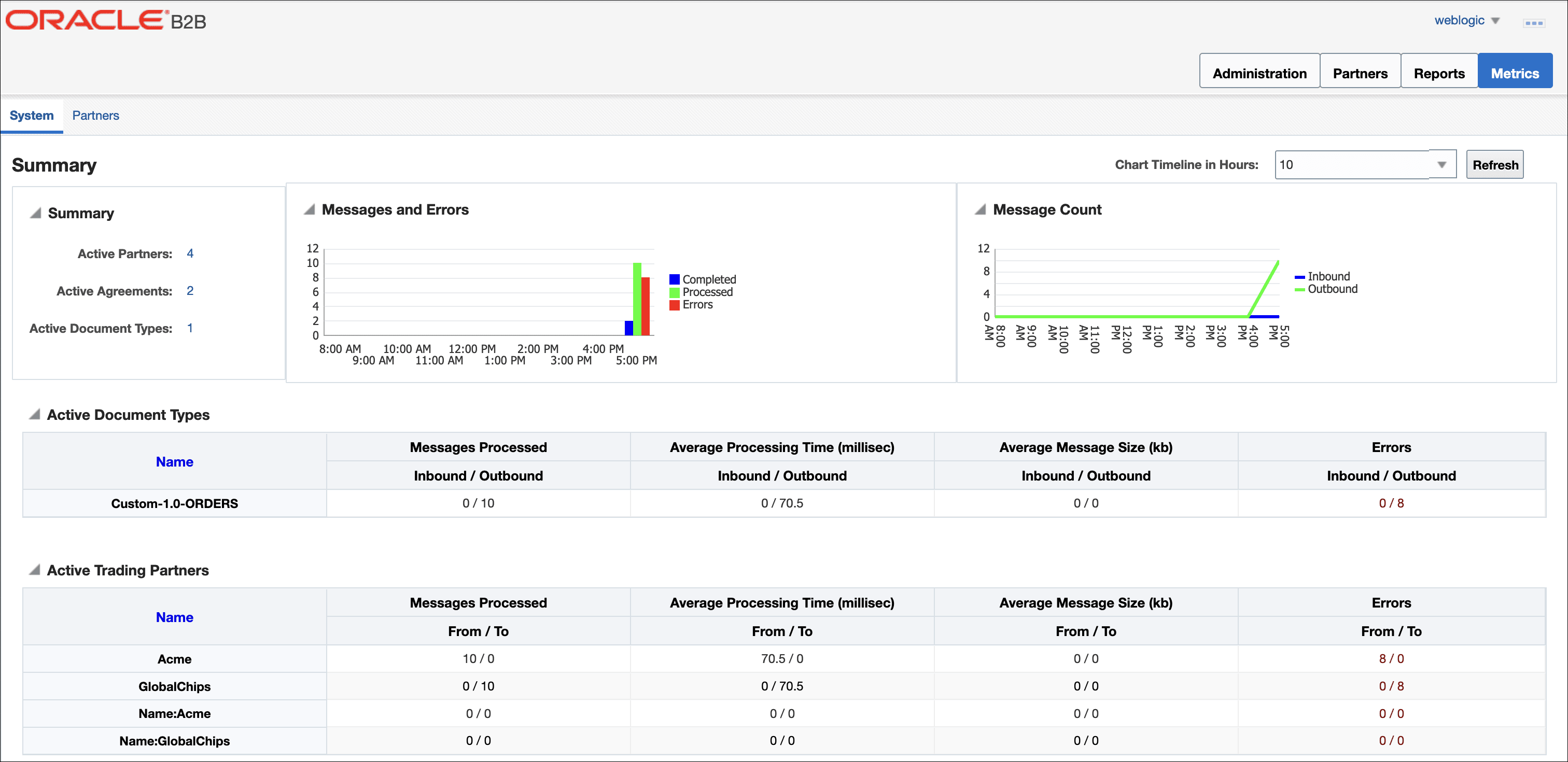

Metrics
Use the tabs of the Metrics page, shown in Figure 2-5, to see information about deployed agreements, such as lists of the active document types and trading partners, and runtime status, such as error messages and message counts.
For more information, see Using B2B Metrics.

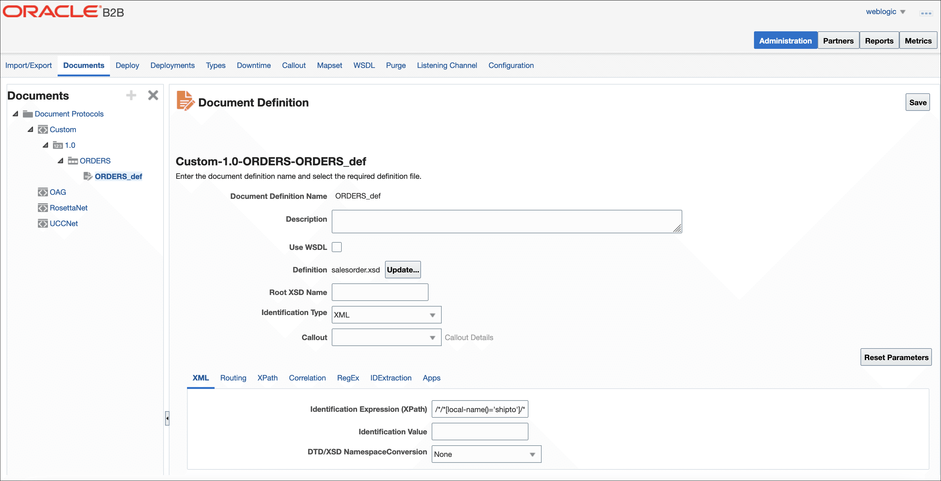

Step 2: Create document definitions
Using the Administration > Document tab of Oracle B2B, shown in Figure 2-7, select from a list of document protocols, and then provide a document protocol version name, a document type name, and a document definition name. (For a Custom document, rather than selecting from the list of document protocols, you add a custom protocol name to the list in the Document Protocols folder.)
Figure 2-7 Creating a Document Definition
After selecting guideline files (if needed) you created in Step 1, you have created the document definition.
For more information, see Creating Document Definitions.

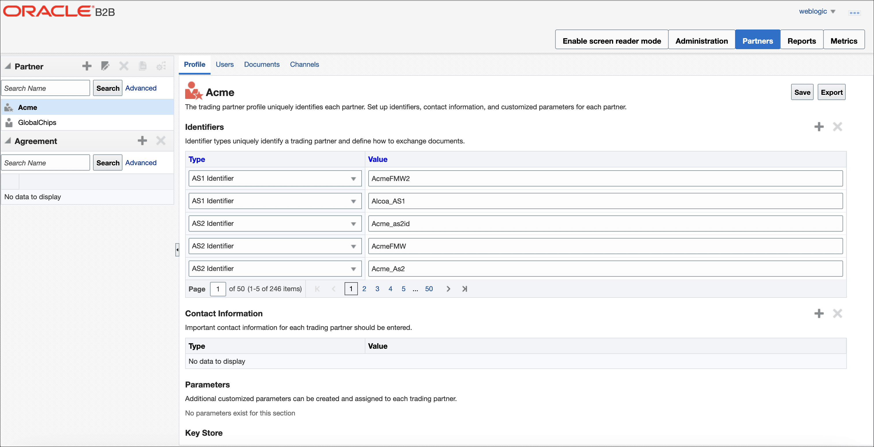

Step 3: Configure trading partners
Using the tabs of the Partners page of Oracle B2B, add or update trading partner names, add identifiers and optional contact information, view parameters, add documents and delivery channels, and add key store information.
Figure 2-8 Configuring Trading Partners
For more information, see Configuring Trading Partners .

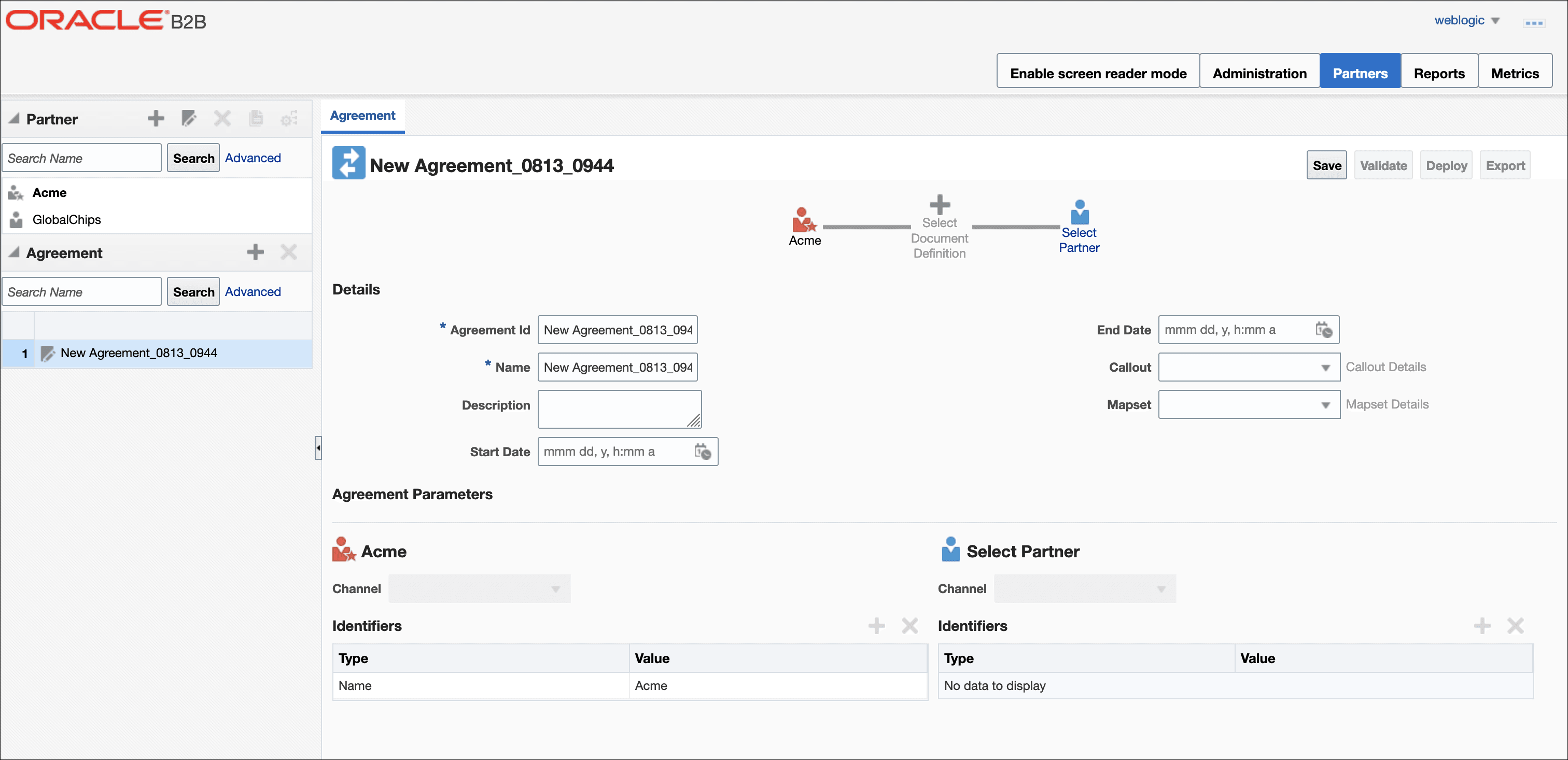

Step 4: Create agreements
Using the Partners > Agreement tab of Oracle B2B, shown in Figure 2-9, create an agreement that specifies the trading partners involved and associates the document definitions, channels, and identifiers with the agreement.
Figure 2-9 Creating a Trading Partner Agreement
For more information, see Creating and Deploying Trading Partner Agreements.

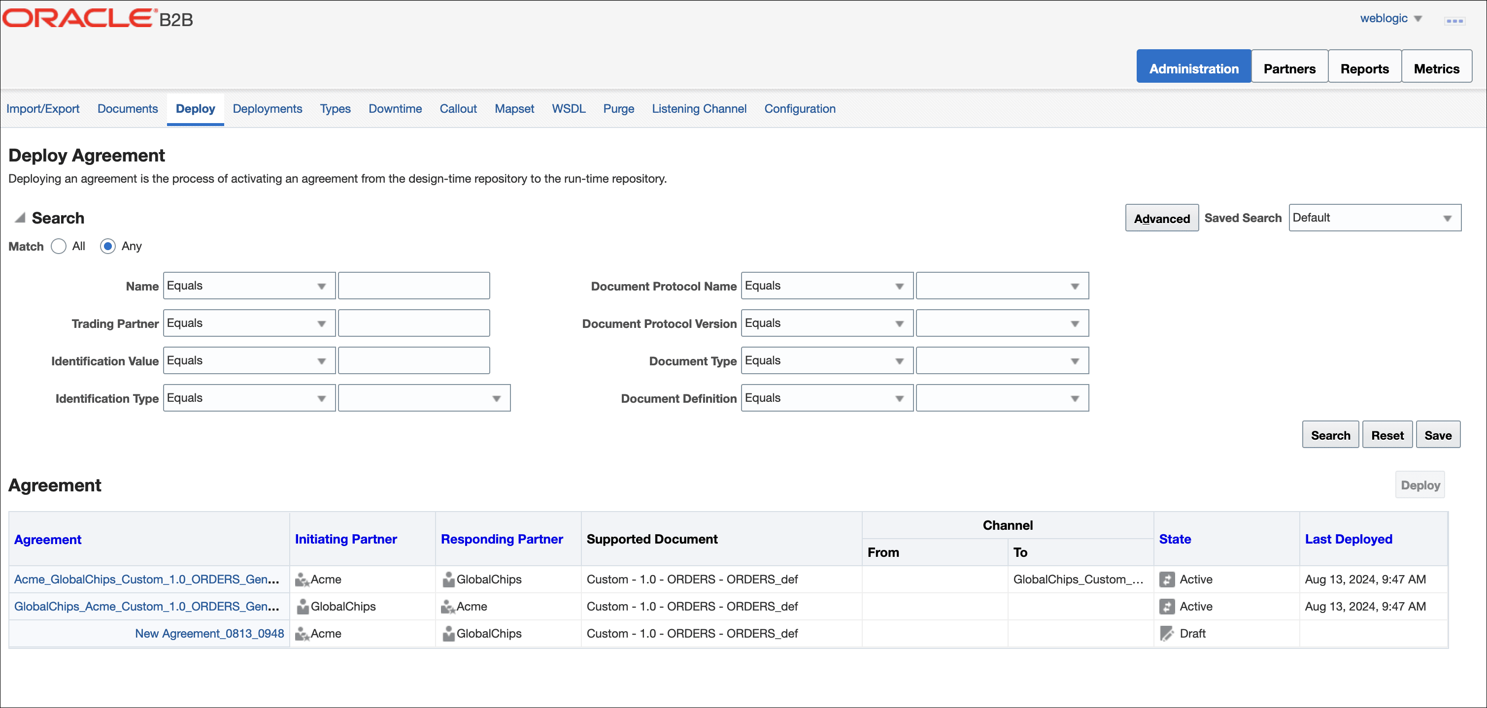

Step 5: Deploy agreements
Using the Administration > Deploy tab of Oracle B2B, shown in Figure 2-10, search for and deploy agreements.
Figure 2-10 Searching for and Deploying Agreements

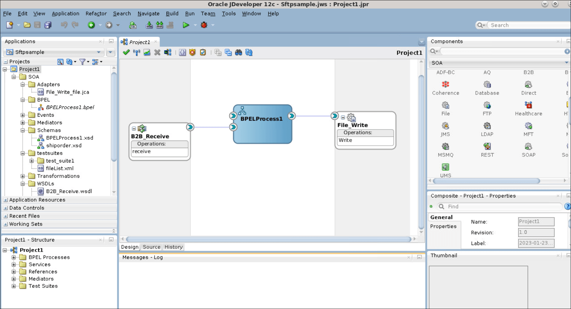

Using Oracle B2B in the Oracle JDeveloper Environment
By using an Oracle B2B binding component in a SOA composite application, you can create an end-to-end business process, such as sending a purchase order generated by a back-end application to a trading partner. Binding components establish the connection between a SOA composite application and the external world.
The B2B Configuration Wizard in Oracle JDeveloper enables you to add B2B binding components to a SOA composite application as follows:
  • B2B is used as a service (inbound) to receive messages from trading partners and deliver them to SOA composite applications. Oracle B2B is the entry point to the SOA composite application.
  • B2B is used as a reference (outbound) to send messages from the SOA composite application to partners.
As you follow the steps in the B2B Configuration Wizard, you are prompted to select a document definition created in Oracle B2B. Or, you can launch Oracle B2B from the wizard to create a document definition. This is the payload, or message, that you are receiving from trading partners or sending to trading partners.

  9. On the Document Definition page, expand the tree to select a document definition. If you select a document definition with multiple root elements, then select a root element to use and click OK.
    Other options are described below.
    Table 2-5 Document Definition Page Options
    Option Description
    Search
    Enter a definition name. Partial strings are matched if you type the beginning of the definition name. Partial strings with wildcards cannot be used.
    Refresh
    Retrieves the document definition list from the B2B server. Refresh after a search to see all document definitions.
    B2B Configuration
    Opens a browser to Oracle B2B, using the connection specified on the Application Server Connection page. In Oracle B2B, you can create a document definition, include it in an agreement, and deploy the agreement. Then return to this dialog, click Refresh, and select the new document definition.
    Use Routing ID
    Selects all document definitions that use a document routing ID. For more information, see Using Document Routing IDs.

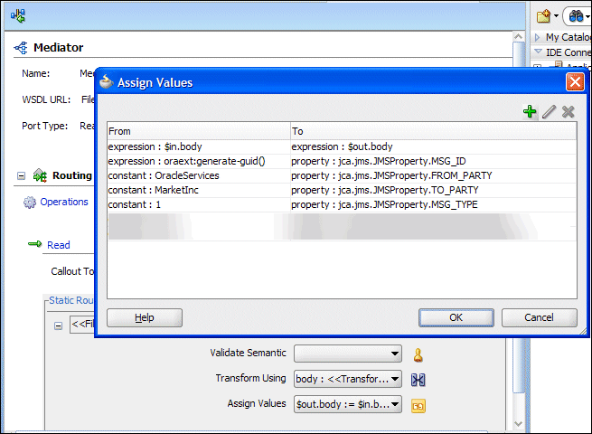

If you select the JMS integration type, then you must use JMS properties prefixed with jca.jms.JMSProperty, as in jca.jms.JMSProperty.property_name. (In contrast, when you select the Default or AQ integration types in the B2B Configuration Wizard, message properties such as MSG_ID, INREPLYTO_MSG_ID, FROM_PARTY, TO_PARTY, ACTION_NAME, MSG_TYPE, DOCTYPE_NAME, and DOCTYPE_REVISION can be used in the SOA composite application without any changes.)
Table 2-7 lists the JMS properties to use with the Oracle JCA Adapter for JMS.
Table 2-7 JMS Adapter Properties
Property Name Property Name When Used with the Oracle JCA Adapter for JMS
MSG_ID jca.jms.JMSProperty.MSG_ID
INREPLYTO_MSG_ID jca.jms.JMSProperty.INREPLYTO_MSG_ID
FROM_PARTY jca.jms.JMSProperty.FROM_PARTY
TO_PARTY jca.jms.JMSProperty.TO_PARTY
ACTION_NAME jca.jms.JMSProperty.ACTION_NAME
MSG_TYPE jca.jms.JMSProperty.MSG_TYPE
DOCTYPE_NAME jca.jms.JMSProperty.DOCTYPE_NAME
DOCTYPE_REVISION jca.jms.JMSProperty.DOCTYPE_REVISION
ATTACHMENT jca.jms.JMSProperty.ATTACHMENT
A2A jca.jms.JMSProperty.A2A
For JMS message correlation, set the property A2A=true. If MSG_ID is provided from the back-end application, then MSG_ID is set as JMS Correlation ID in the B2B output, otherwise the JMS Message ID is set to JMS Correlation ID in the B2B output.
For example, these sender properties and values are added in the Assign Values dialog of the Mediator component for an outbound composite, as shown in Figure 2-11.
Figure 2-11 Adding JCA JMS Properties in the Assign Values Dialog
