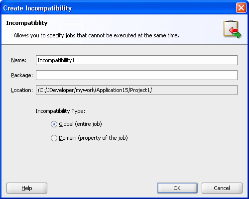

Under Items, select Incompatibility and click OK. This displays the Create Incompatibility window, as shown in Figure 18-1.
Use the Create Incompatibility dialog to specify the following:
In the Name field, enter a name for the incompatibility or accept the default name.
In the Package field, enter a package name for the incompatibility.
The Location field displays the full path of the directory where the incompatibility file is stored.
In the Incompatibility Type field, select Global. and click OK.

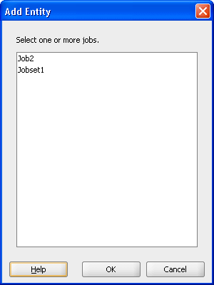

In the Entities area, click Add to add entities. This displays the Add Entity dialog, as shown in Figure 18-2.
Figure 18-2 Incompatibility Add Entity Window
Description of "Figure 18-2 Incompatibility Add Entity Window" -
Select one or more entities for the incompatibility and click OK. The Incompatibility Editor displays.

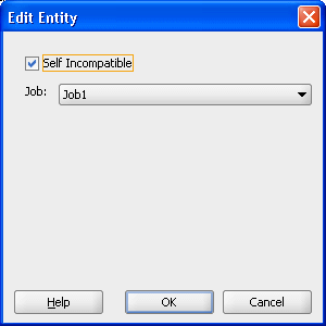

To specify a self incompatibility or to change the entity, double-click the entity in the Entities area. This displays the Edit Entity dialog as shown in Figure 18-3.
Figure 18-3 Edit Entity Window for Global Incompatibility
Description of "Figure 18-3 Edit Entity Window for Global Incompatibility" -
To specify self incompatibility, select Self Incompatible.

Under Items, select Incompatibility and click OK. This displays the Create Incompatibility window.
In the Package field, optionally enter a package name for the incompatibility.
In the Incompatibility Type field, select Domain, as shown in Figure 18-4.
Click OK. This creates the incompatibility and displays the Incompatibility Editor.

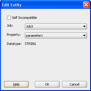

To specify a self incompatibility or modify an entity or its properties, under the Entities field, double-click an entity.
The Edit Entity window displays, as shown in Figure 18-5.
Figure 18-5 Incompatibility Edit Entity Window
Description of "Figure 18-5 Incompatibility Edit Entity Window" -
