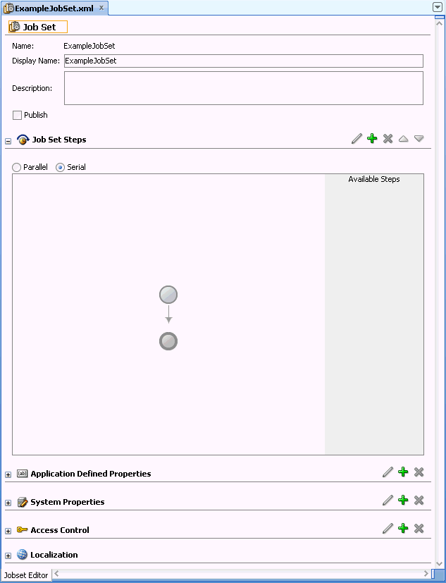

Click OK. This creates the job set and displays the Job Set Definition page, as shown in Figure 17-1.
Figure 17-1 Job Set Editor with Serial Job Set
In the Job Set Editor pane, in the Description field enter a description for the job set.
In the Job Set Steps area, select the Parallel or Serial radio button to specify parallel or serial execution mode for the job set.
In the Job Set Editor pane add the job set steps. For more information on adding job set steps, see How to Define Serial Job Set Steps or How to Define Parallel Job Set Steps.
In the Application Defined Properties area, click Add to add properties associated with the job set. You use these to represent an application-specific or step-specific application defined property for the job set. For more information on using application defined properties, see Introduction to Using Parameters and System Properties. For more information, see What You Need to Know About Job Set Level Parameter Materialization.
In the System Properties area, click Add to add system properties associated with the job set. For more information on using system properties, see Using System Properties.
In the Access Control area, click Add to modify the list of roles that have access to this metadata, along with their access levels. For more information on defining access, see Oracle Enterprise Scheduler Security .
In the Localization area, enter the following information for localizing this job set:
Resource Bundle Base Name -- The base name for the resource bundle that specifies internationalized values.
Display Name Resource Key -- The resource key that specifies the display name value in the resource bundle.
Description Resource Key -- The resource key that specifies the description text in the resource bundle.
Save the job set.

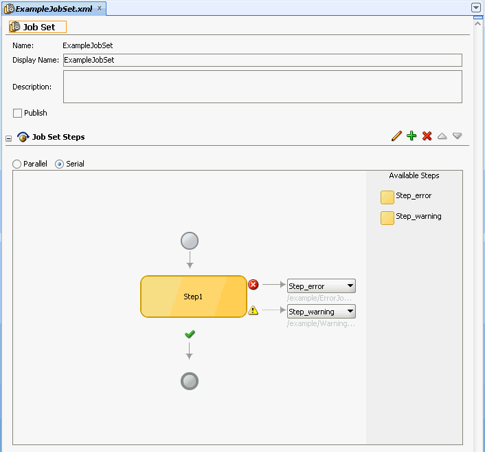

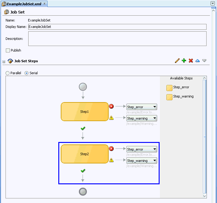

To define serial job set steps you select the serial execution mode and then add job set steps. Job set steps are created from the available job definitions and job sets defined in the current project. You define serial job set steps when you specify a step ID and a job definition child job set definition associated with the step. You also define links from a job set step terminal states to specify the next step. Table 17-2 lists the possible terminal states that you can specify using JDeveloper.
Table 17-2 Job Set Serial Execution Step Terminal States
| Terminal State | Description |
Oracle JDeveloper indicates this state with a check mark button. This path represents a child step or child job set was successfully processed by the system. |
Oracle JDeveloper indicates this step with a warning button. A child step or child job set resulted in a warning. |
Oracle JDeveloper indicates this step with an error button. Some aspect of the request to run the child step or child job set processing resulted in an error. |
To add serial job set steps:

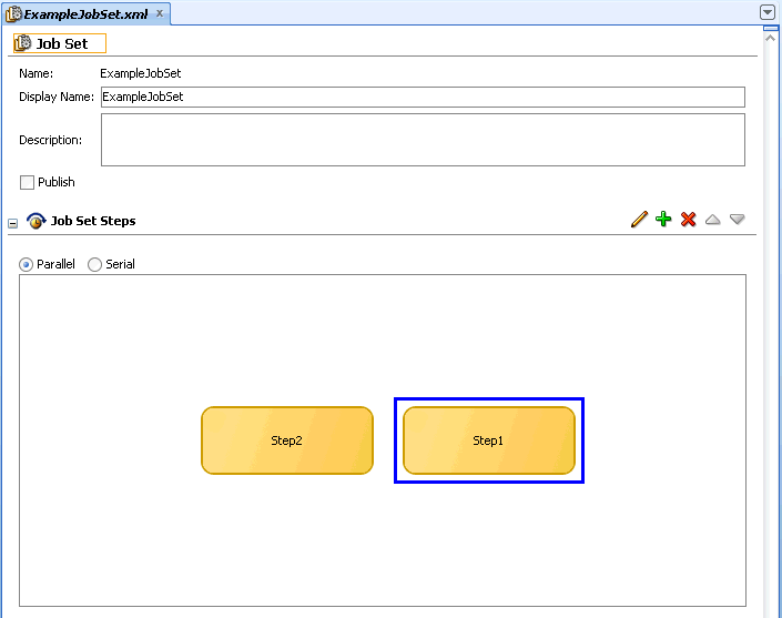

You can add parallel job set steps to a job set.
To add parallel job set steps:

When you define a parallel job set you specify a set of job set steps that run together. A parallel job set only contains steps, and does not contain links between steps, as all the steps execute together and do not depend on each other or upon the order in which each step runs.

What You Need to Know About Serial Job Sets
When you define a serial job set, the associated XML document includes job set steps and links. Oracle Enterprise Scheduler enforces the following limitations for serial job set definitions:

When there is no job set link defined for a terminal state of a step, it implies that the job set should stop if the step ends with the unspecified terminal state. For example if there is no link defined for a step
Job_Dfor the stateWARNING, and if the stepJob_Dends up with the state ofWARNING, the job set stops execution.
Each job set step can be defined to use any of the available job definitions or job sets, and multiple steps may use the same job definition or job set.
