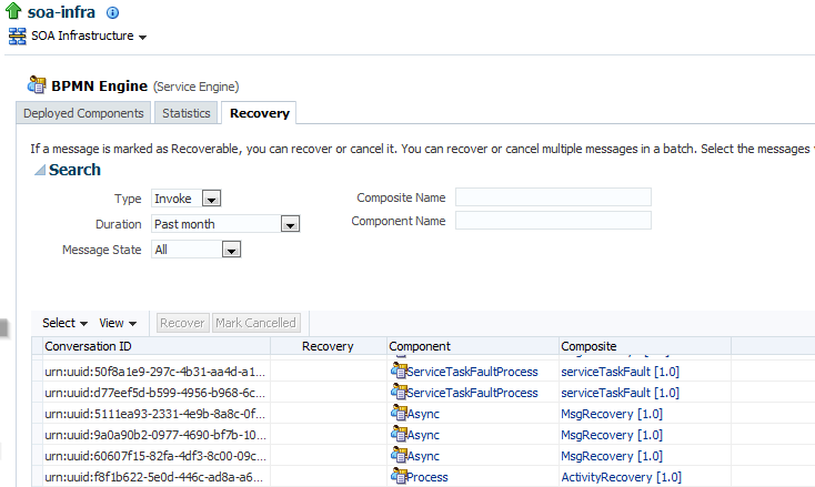

Click Recovery.
The Recovery page displays the following details:
A utility for searching for a specific message failure by specifying criteria and clicking Search. Click the Help icon for details.
Message failure in the service engine, including the conversation ID, whether you can recover from the message failure, the service component and composite application in which the failure occurred, and the time at which the fault occurred.
Select a fault in the table.
Select one of the following options:
Action Description Recover
Retries the message in which the fault occurred.
If an asynchronous BPMN process encounters a transaction rollback scenario because of any underlying exception error, it rolls back to the last dehydration activity. If this is a new instance, and a receive activity was the first dehydration activity, the BPMN process service engine creates a recoverable invoke. When you click Recover to recover the invoke, the service engine creates a new instance. This instance may run to completion with no exception error. However, you continue to see the older instance identified as faulted.
Mark Cancelled
Marks the message so it is never delivered.
Once a message is submitted for recovery, the BPMN process service engine may take time to complete the action. This typically takes less than several seconds. During this time, the message remains visible in the Recovery page. Duplicate attempts to recover the same message in that period are ignored. Refresh the page every few seconds to receive the latest recovery status.

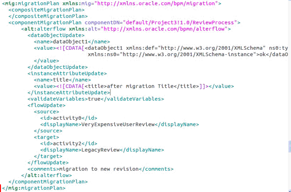

Manual migration using a migration plan (Oracle BPM only): This is for nontrivial changes between revisions. The migration plan describes how to perform the migration.

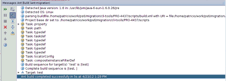

Migrating Instances with the ant Script
You must create an ant script to perform a migration. The script must import the $Middleware_Home/soa/bin/ant-flow-instance-migration.xml script.
You can get help to create your ant script with the following command:
ant -f $Middleware_Home/soa/bin/ant-flow-instance-migration.xml help

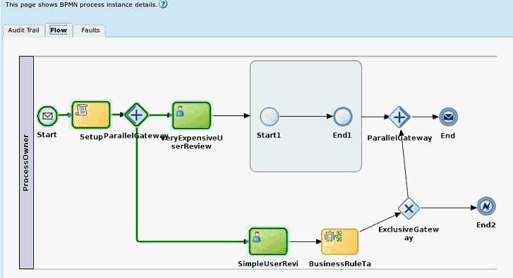

This section provides an example of migrating a revision instance of the ReviewProcess composite that includes Oracle BPM. Because a human workflow approval task is removed in this example, a migration plan is required.

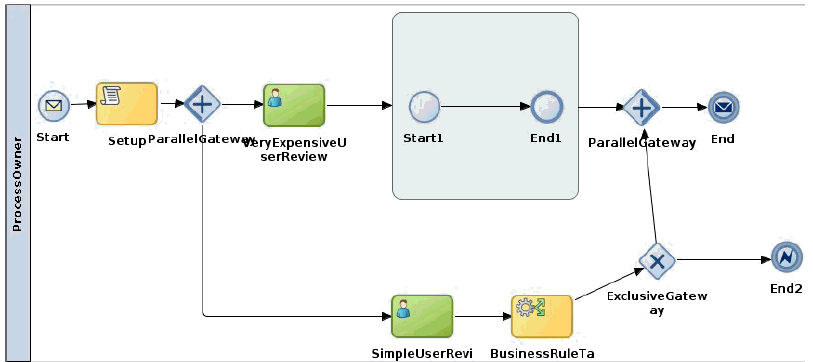

Figure 37-1 shows the instance flow for revision 1.0 of the composite. There are two human tasks in this revision of the composite, including VeryExpensiveUserReview, which is a time-consuming, user approval task.
Figure 37-1 Oracle BPM Instance Flow for Revision 1.0
Description of "Figure 37-1 Oracle BPM Instance Flow for Revision 1.0"

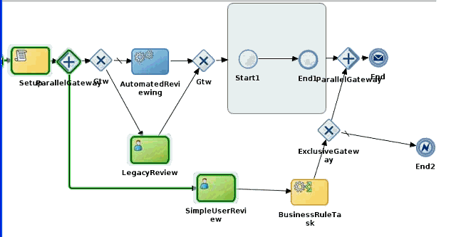

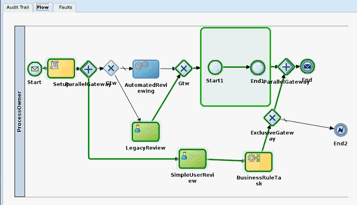

Figure 37-3 shows the improved instance flow for revision 2.0 of the composite application.
The time-consuming VeryExpensiveUserReview human approval task has been removed. Instead, an automatic review with a service task is used. The service task delegates the review approval to an external web service.
Figure 37-3 Oracle BPM Instance Flow for Revision 2.0
Description of "Figure 37-3 Oracle BPM Instance Flow for Revision 2.0"
