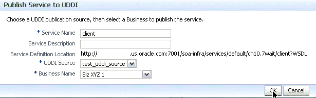

In the Service table, select a service to publish to the UDDI registry.
From the Actions list, select Publish To UDDI.
The Publish Service to UDDI dialog appears.
Enter the following information:
Field Description Service Name
Displays the name of the selected service.
Service Description
Enter an optional description of the selected service.
System Definition Location
Displays the WSDL URL to publish to the UDDI registry. For example:
http://myhost.mycompany.com:7001/soa-infra/services/default/HelloWorld/client?WSDL
UDDI Source
Select the UDDI publishing source from which to register the service.
Business Name
Select a business to publish the service. This is the name of the data structure in the UDDI registry. It is assumed that the business has already been registered in the UDDI registry.
When complete, the Publish Service to UDDI dialog looks similar to the following:
Click OK.

How to Publish WSDLs to UDDI for Multiple Partitions
The following limitations exist for publishing WSDL services from Oracle Enterprise Manager Fusion Middleware Control.
You cannot publish the same service with the same target namespace from different SOA partitions or from different hosts.
There is no option for entering your own service key.
Instead, use the Registry Console to publish the same WSDL service deployed to different partitions to OSR.
To publish WSDLs to UDDI for multiple partitions:
