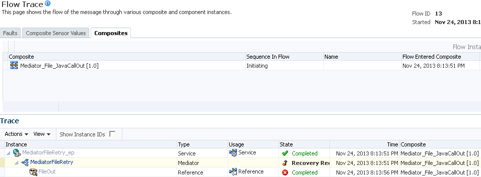

The Flow Trace page consists of two sections. Depending on which tab is selected, the top section shows the Faults, Composite Sensor Values, Composites, or Resequencer (if an Oracle Mediator resequencer is included in the composite) tabs of the selected flow trace. The bottom section shows the business flow trace.

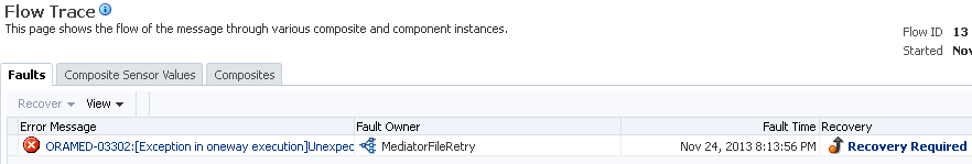

The Faults tab of the Flow Trace page displays the following details:

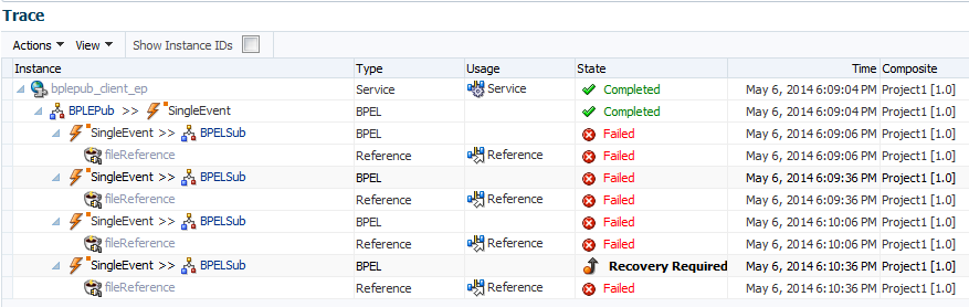

A Faults table that displays the error message, component that handled the fault, time of the fault, and recovery status (for example, unrecoverable, recovery required, and so on). To display additional columns in the table, select View > Columns. If you change the columns in the Flow Instances page, they are also changed in the Faults table of the Flow Trace page.

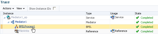

A Trace table that displays the sequence of the message flow through the services, service components, and references that comprise SOA composite applications. Regardless of the tab that you select on the Flow Trace page (Faults, Composite Sensor Values, Composites or Resequencer (if an Oracle Mediator resequencer is included in the composite), the Trace section is always displayed. To display additional columns in the table, select View > Columns. To view the flow trace in XML format, select the Actions list.
If the Audit Level is set to Off, trace details are not captured and the trace table is not displayed. However, instance details for some components are captured. For those components, a flat list of instance details is displayed. This list only has instance details for some components and may not have all components that participated in the flow.
Midprocess receive activities that are triggered by events are displayed in the flow trace. Midprocess receive activities can co-relate multiple flow IDs. The flow trace on the correlating BPEL node can display all the flow IDs that are correlated by that node.

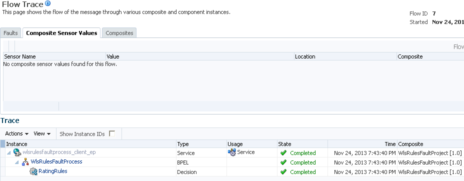

Viewing Composite Sensor Values in the Flow Trace
You can view details about composite sensors included in the flow trace of the business flow instance. Composite sensors provide a method for implementing trackable fields on messages. Composite sensors can be added to service and reference binding components and service components that have subscribed to business events during design time in Oracle JDeveloper.
To view composite sensor values in the flow trace:

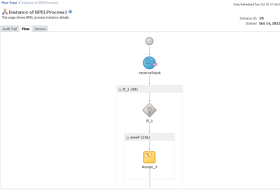

Viewing the Audit Trail and Process Flow in the Flow Trace
You can view the audit trail and process flow in the flow trace of the business flow instance. The audit trail and flow trace provide a graphical representation of the audit trail data. The audit trail displays execution details about the activities in the BPEL process. The process flow displays the flow of the payload through the process.
To view the audit trail and process flow in the flow trace:

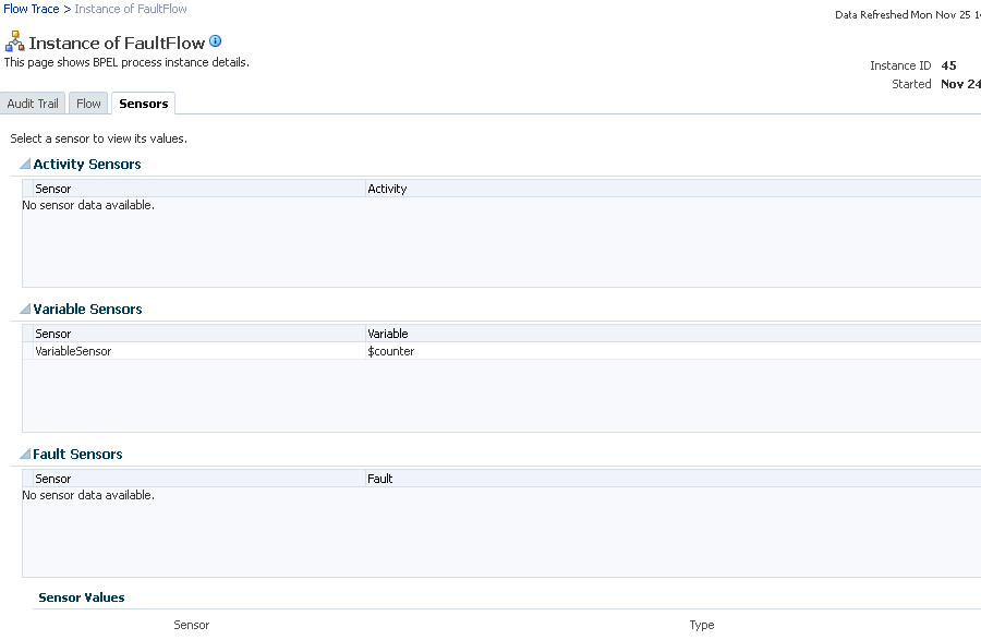

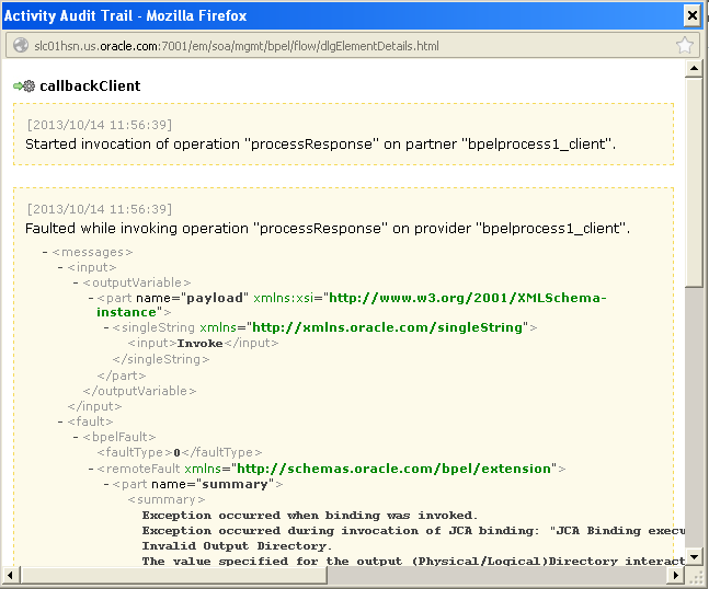

Monitoring Fault, Activity, and Variable Sensors in the Flow Trace
You can view the fault, activity, and variable sensor data in a BPEL process service component. You design sensors in BPEL processes in Oracle JDeveloper. Sensors enable you to monitor BPEL process activities, variables, and faults during runtime.
To monitor fault, activity, and variable sensor data in BPEL processes:

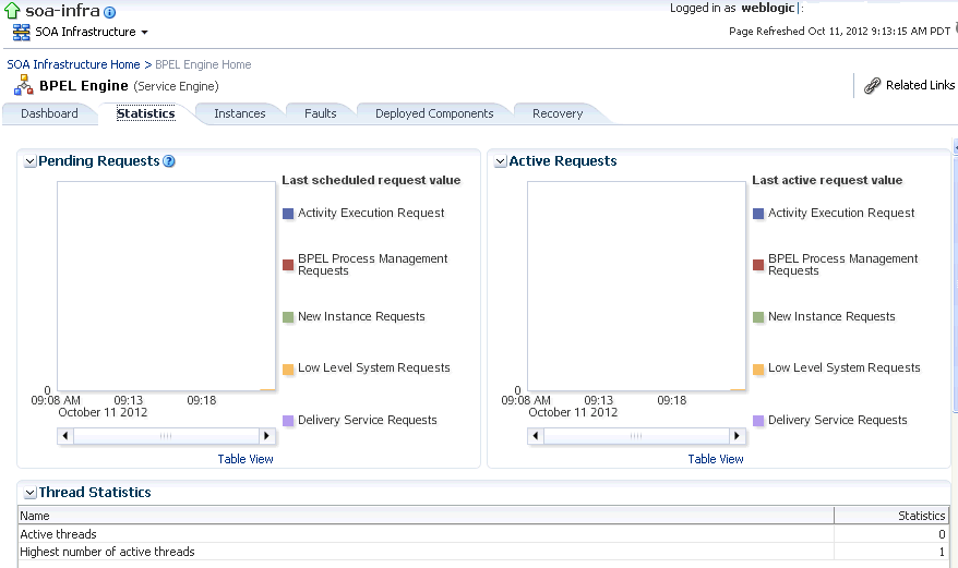

Click Statistics.
The Pending Requests and Active Requests sections of the Statistics page display the following details. Click the Help icon for additional information.
Pending requests in the service engine
Active requests in the service engine

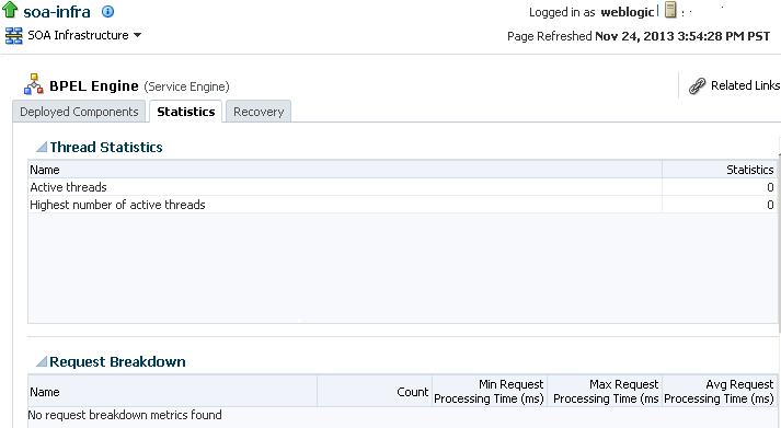

The Thread Statistics and Request Breakdown parts of the Statistics page display details about the number of active threads and the count and minimum, maximum, and average request processing times in the service engine.
For more information about BPEL process tuning and performance, see Tuning Performance.

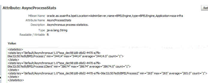

Viewing Low Level Request Breakdown Table Details

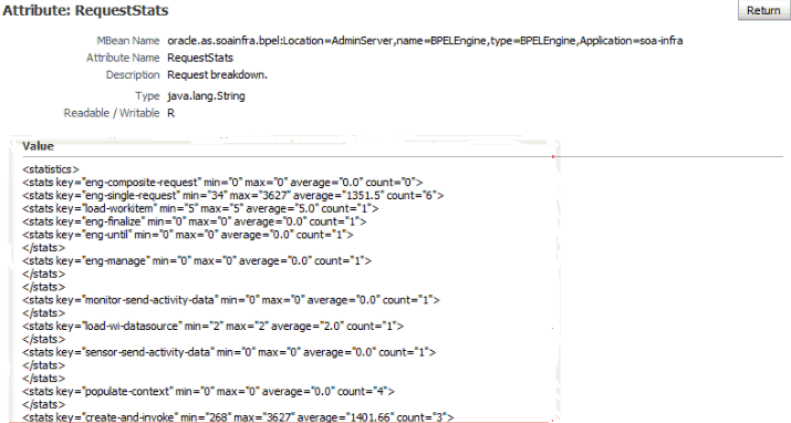

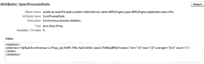

You can configure the Request Breakdown part of the Statistics page to display lower level details about the time a request spends in various service engine layers during processing. You may need to scroll down the Statistics page to view this part.
Configure the StatsLastN property under the More BPEL Configuration Properties link on the BPEL Service Engine Properties page. By default, this property is set to -1. You can set this property to a more appropriate value (for example, 1000). This property provides information that helps you analyze and isolate areas that may become potential trouble spots.
For information about accessing and configuring this property, see Configuring BPEL Process Service Engine Properties.
The information that is displayed on the Request Breakdown part of the Statistics page after configuring the StatsLastN property is also displayed with the following System MBean Browser properties:
AsyncProcessStats: Provides low level asynchronous process statistics.
SyncProcessStats: Provides low level synchronous process statistics.
RequestStats: Provides a low level request breakdown.
For information about accessing these properties, see Viewing Statistics About the Time a Request Spends in the BPEL Process Service Engine.
You can display lower level details about the time a request spends in various service engine layers during processing with several System MBean Browser properties.
For information on configuring this information with the StatsLastN property on the BPEL Service Engine Properties page, see Configuring BPEL Process Service Engine Properties.
