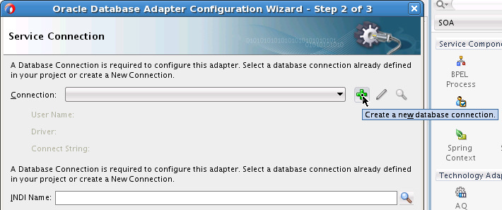

To invoke the Adapter Configuration wizard, the database adapter is dragged from the Components window into the External References swimlane of the SOA Composite Editor. This action invokes the Adapter Configuration Wizard for configuring the database adapter.
Configuring the Database Adapter with the Adapter Configuration Wizard
The following database adapter configuration tasks are performed during execution of the Adapter Configuration Wizard.
The option to create a connection to the database in which the credit card information is stored is selected, as shown in Figure 3-3. This enables the database adapter to access the database and retrieve the appropriate credit card information.
The Select database option is chosen to create a database query, as shown in Figure 3-4.
The appropriate credit card information table is imported from the database, as shown in Figure 3-5.

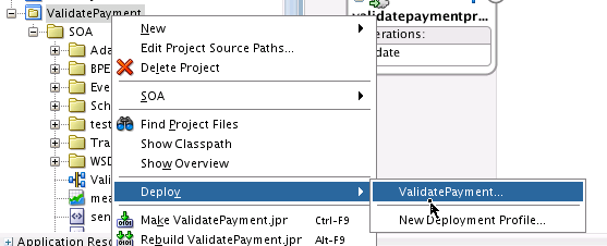

Company X deploys the validatePayment composite in Oracle JDeveloper, as shown in Figure 3-17.
Figure 3-17 validatePayment Composite Deployment
Description of "Figure 3-17 validatePayment Composite Deployment"
During the deployment process, the composite is deployed to the server on which an application server connection was created in Configuring the Database Adapter with the Adapter Configuration Wizard. Figure 3-18 provides details.
Figure 3-18 Deployment to the Application Server
Description of "Figure 3-18 Deployment to the Application Server"

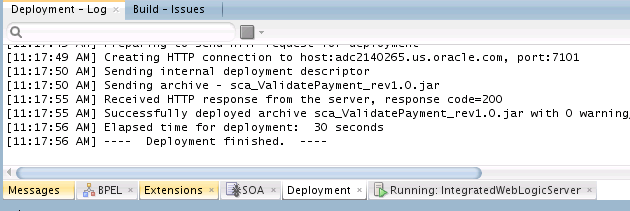

If there are no compilation errors, the build is successful and deployment starts. Figure 3-19 provides details.
Figure 3-19 Deployment Success Message in Oracle JDeveloper Log Window
Description of "Figure 3-19 Deployment Success Message in Oracle JDeveloper Log Window"

Deploying and Testing
After application design is complete, Company X deploys and tests the application end-to-end by right-clicking the ValidatePS proxy and selecting Run. Figure 3-28 provides details.
The Test Console is displayed from which you can select a payload for testing. A sample payload is generated for you. Figure 3-29 provides details.
Company X tests with a sample authorize payment file, as shown in the following example:
<ns1:PaymentInfo xmlns:ns1="http://www.oracle.com/soasample"> <ns1:CardPaymentType>0</ns1:CardPaymentType> <ns1:CardNum>1234123412341234</ns1:CardNum> <ns1:ExpireDate>0316</ns1:ExpireDate> <ns1:CardName>AMEX</ns1:CardName> <ns1:BillingAddress> <ns1:FirstName>Joe</ns1:FirstName> <ns1:LastName>Smith</ns1:LastName> <ns1:AddressLine>555 Beverly Lane</ns1:AddressLine> <ns1:City>Hollywood</ns1:City> <ns1:State>CA</ns1:State> <ns1:ZipCode>12345</ns1:ZipCode> <ns1:PhoneNumber>5127691108</ns1:PhoneNumber> </ns1:BillingAddress> <ns1:AuthorizationAmount>100</ns1:AuthorizationAmount> </ns1:PaymentInfo>
After importing the sample file, Company X clicks Execute.
Credit validation design and testing is now complete.
