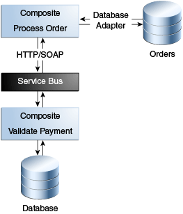

Figure 4-1 provides an overview of how this business solution is implemented.
Subsequent sections of this chapter provide more specific details about how the components in Table 4-1 are used to address the order processing business challenge.

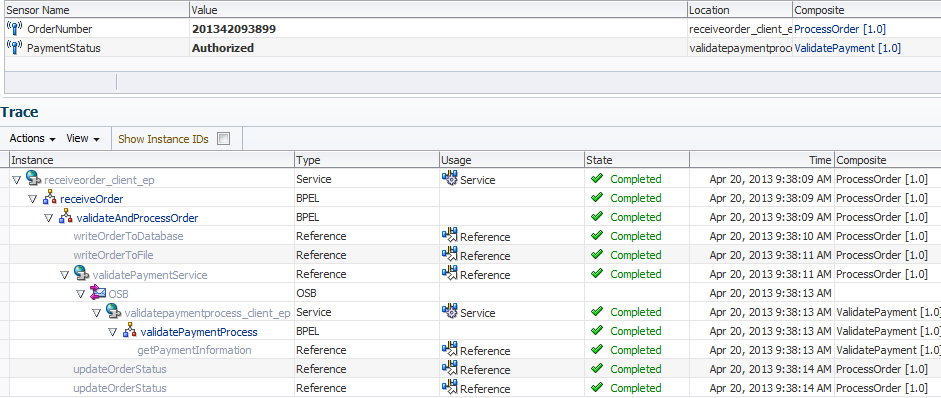

Company X deploys and creates a business flow instance of the project. In the Flow Trace page in Oracle Enterprise Manager Fusion Middleware Control, the two composite sensor names and values are displayed. Payment has been authorized, and the project is sent to the order fulfillment system. Figure 4-19 provides details.
Figure 4-19 Composite Sensor Names and Values on Flow Trace Page
Description of "Figure 4-19 Composite Sensor Names and Values on Flow Trace Page"
The audit trail indicates that the order is marked as Authorized and ReadyForShip. Figure 4-20 provides details.
