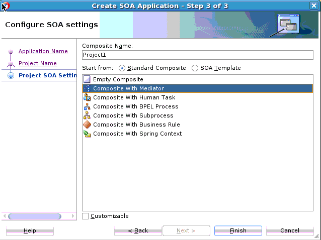

Create and Name the SOA application and project using the Create SOA Application wizard.
When you reach the Configure SOA Settings page, select Composite with Mediator in the Composite Template list, as shown in Figure 19-1.
Figure 19-1 Composite with Mediator Selection in Create SOA Project Wizard
Description of "Figure 19-1 Composite with Mediator Selection in Create SOA Project Wizard" -
Click Finish.
