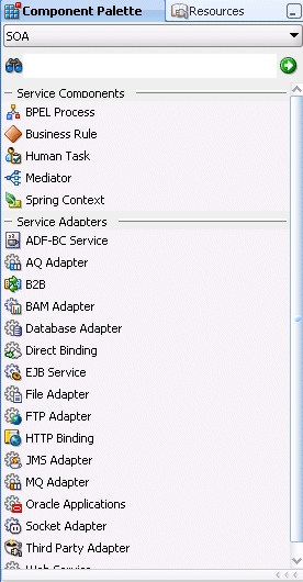

Drag and drop a Mediator from the Components window (shown in Figure 19-2) to the Components section of the editor.
Alternatively, right-click a blank area in the Components section of the editor. Select Insert > Mediator from the context menu that appears.
Tip:
The Components window is to the right of the SOA Composite Editor.
Figure 19-2 Components Window with a Mediator Service Component
Description of "Figure 19-2 Components Window with a Mediator Service Component"The Create Mediator dialog appears.
