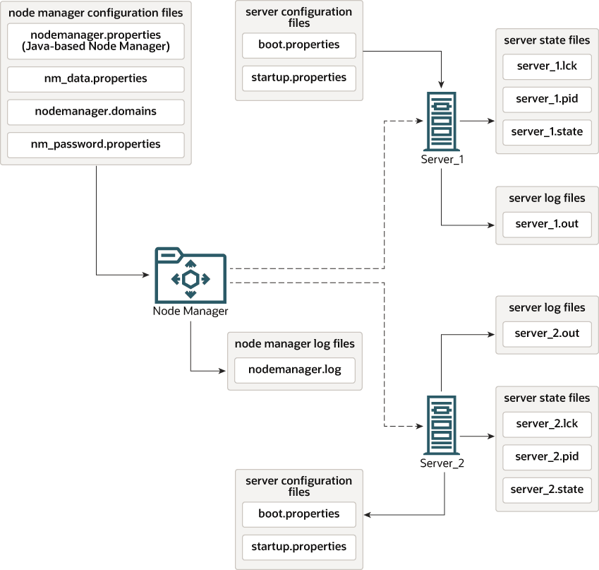

If Node Manager fails or is explicitly shut down, then upon restart, it determines the server instances that were under its control when it exited. Node Manager can restart any failed server instances as needed.
It is advisable to run Node Manager as an operating system service so that it restarts automatically when its host machine restarts.Monitor Servers and View Log Data
Node Manager creates a log file for a Node Manager process and a log file of server output for each server instance it controls. See Log Files.

Java-based Node Manager runs within a Java Virtual Machine (JVM) process. Oracle recommends that you run it as a Windows service on Windows platforms and as an operating system service on UNIX platforms, allowing it to restart automatically when the system is rebooted. You can configure Java-based Node Manager using the Configuration Wizard or WLST offline.
This implementation of Node Manager determines its configuration from the nodemanager.properties
file. See Reviewing nodemanager.properties.
Java-based Node Manager provides a more fine-grained security model, and the administrator credentials for accessing Node Manager are separate from those of the domain administrator. See Configuring Java-based Node Manager Security.

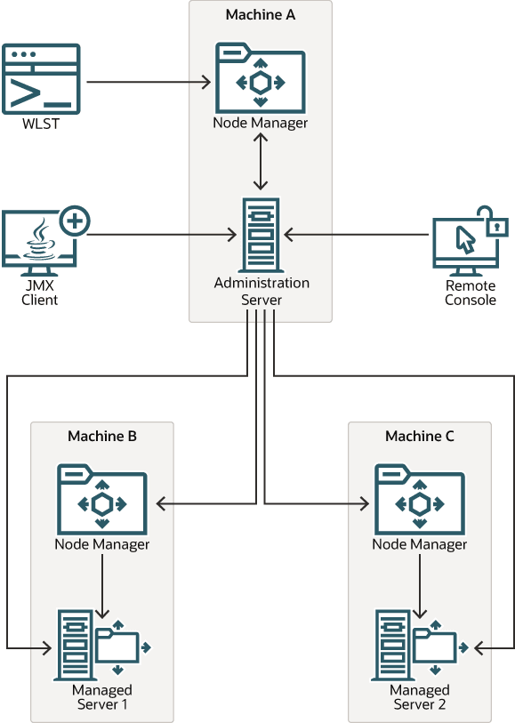

The following sections provide a big picture diagram of Node Manager's role in the Oracle WebLogic Server environment, as well as illustrations and descriptions of the processes Node Manager uses to communicate with server instances:
Diagram of Node Manager and Servers
Figure 1-1 illustrates the relationship between Node Manager, its clients, and the server instances it controls.
In this diagram, Machine A hosts the Administration Server, and Machine B and Machine C host Managed Servers. Each machine contains a Node Manager instance. Using Node Manager, you can start, monitor, and restart the Administration Server in Machine A. By using the Administration Server as a Node Manager client, you can start or stop Managed Servers in Machine B and Machine C.
You can use the WebLogic Remote Console, WLST, or a JMX client to access Node Manager. You can use WLST commands to start, stop, and monitor a server instance when WLST is connected directly to the Node Manager instance or when WLST is connected to the Administration Server. When using the WebLogic Remote Console, you access Node Manager using the Administration Server. You can also use a JMX client to communicate with the Administration Server.
Figure 1-1 Node Manager in the Oracle WebLogic Server Environment
Description of "Figure 1-1 Node Manager in the Oracle WebLogic Server Environment"

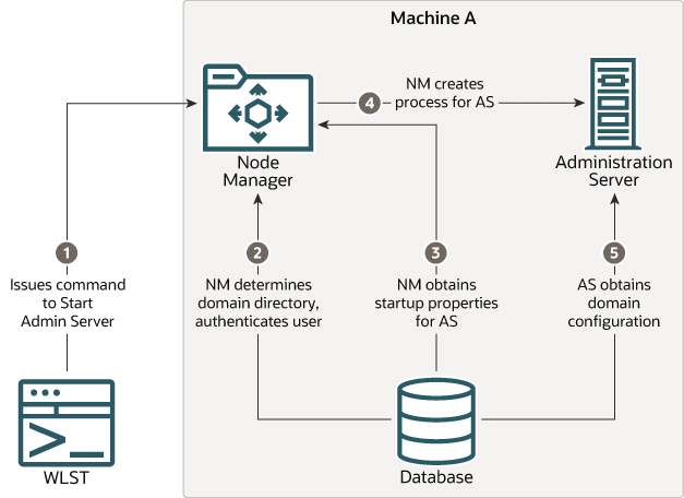

How Node Manager Starts an Administration Server
Figure 1-2 illustrates the process of starting an Administration Server with Node Manager.
This section assumes that you have installed the Administration Server and created its domain directory using the Configuration Wizard.
Node Manager is running on Machine A, which hosts the Administration Server. The standalone Node Manager client is remote.

- An authorized user issues the WLST offline command
nmConnect
to connect to a Node Manager (NM) process on the machine that hosts the Administration Server (AS). ThenmConnect
command provides a Node Manager user name and password that are used to authenticate the user with Node Manager.Note:
If a Node Manager instance is the script-based implementation, the user can connect using the SSH client.Then, the user issues the
nmStart
command and provides the credentials for starting the Administration Server. For example:prps = makePropertiesObject(Username=username;Password=password") nmStart("AdminServer",props=prps)
Aboot.properties
file is generated if the user has already started the Administration Server and provided credentials.The
nmStart
command identifies the server instance to start. - Node Manager looks up the domain directory in
nodemanager.domains
, and authenticates the user credentials using a local file that contains the encrypted user name and password. - Node Manager obtains the startup properties for the Administration Server.
The
nmStart
command can optionally pass properties that are used to start the Managed Server. When these properties are passed, they overwrite any previously stored properties that Node Manager may have used. If no properties are passed with thenmStart
command, then Node Manager uses the values in thestartup.properties
file that have been persisted from a previous startup or from using thenmGenBootStartupProps
WLST command. - Node Manager creates the Administration Server process.
- The Administration Server obtains the domain configuration from its
config
directory.
After the Administration Server starts, you can update the user credentials and
startup properties by using the WLST nmGenBootStartupProps
online command.
Alternatively, when the Administration Server and Node Manager are running, you can update the user credentials and startup properties in the WebLogic Remote Console. To update, in the Edit Tree, go to Environment, then AdminServer. On the Advanced tab, select the Node Manager subtab. The Administration Server then pushes the updates to the running Node Manager and Node Manager writes the information to the disk.

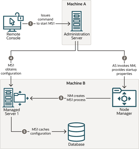

How Node Manager Starts a Managed Server
Figure 1-3 illustrates the process of starting a Managed Server with Node Manager by using the WebLogic Remote Console. You can also use WLST or a JMX client to connect to the Administration Server.
Node Manager is running on Machine B, which hosts Managed Server 1. The Administration Server for the domain is running on Machine A.
- From the WebLogic Remote Console, the user issues a start command for Managed Server 1 (MS1).
- The Administration Server (AS) issues a start command for Managed Server 1 to Node Manager (NM) on the Machine B, providing the remote start properties configured for Managed Server 1. See Configuring Remote Startup Arguments.
- Node Manager starts the Managed Server 1 in the domain directory.
- Managed Server 1 contacts the Administration Server to check for updates to its configuration information.
- If there are outstanding changes to the domain configuration, Managed Server 1 updates its local cache of configuration data.

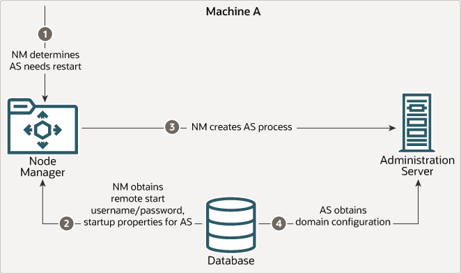

How Node Manager Restarts an Administration Server
Figure 1-4 illustrates the process of restarting an Administration Server with Node Manager.
Node Manager is running on the machine that hosts the Administration Server. The Administration Server, which was initially started with Node Manager, has exited. The Administration Server's AutoRestart

- Node Manager (NM) determines from the Administration Server (AS) process exit code that it requires a restart.
- Node Manager obtains the user name and password for starting the Administration
Server from the
boot.properties
file, and the server startup properties from theserver_name
/data/nodemanager/startup.properties
file. - Node Manager starts the Administration Server.
- The Administration Server reads its configuration data and starts up.

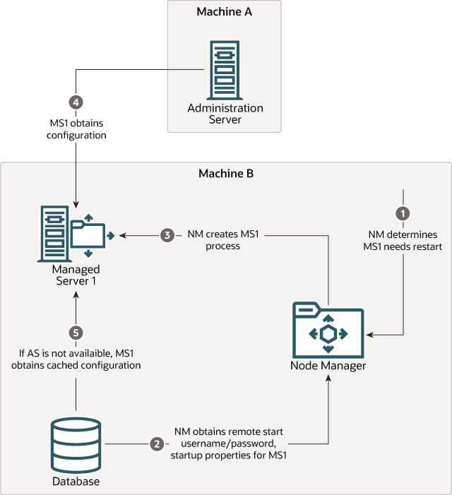

How Node Manager Restarts a Managed Server
Figure 1-5 illustrates the process of restarting a Managed Server with Node Manager.
Node Manager is running on Machine B, which hosts Managed Server 1. Managed Server 1, which was initially started with Node Manager, has exited. Managed Server 1's AutoRestart

- Node Manager (NM) determines from the Managed Server 1 (MS1) process exit code that it requires restart.
- Node Manager obtains the user name and password for starting Managed Server 1 from
the
boot.properties
file, and the server startup properties from thestartup.properties
file. These server-specific files are located in theserver_name
/data/nodemanager/
directory for Managed Server 1. - Node Manager starts Managed Server 1.
Node Manager waitsRestartDelaySeconds
after a server instance fails, before attempting to restart it. - Managed Server 1 attempts to contact the Administration Server (AS) to check for
updates to its configuration data. If it contacts the Administration Server and
obtains the updated configuration data, Managed Server 1 updates its local cache of
the
config
directory. - If Managed Server 1 fails to contact the Administration Server, and if the Managed
Server Independence mode (MSI) is enabled, Managed Server 1 uses its locally cached
configuration data.
The Managed Server Independence (MSI) mode is enabled by default. The MSI mode is also enabled when:- an
admin_url
is not provided, whereadmin_url
specifies the listen address (host name, IP address, or DNS name) and port number of the domain's Administration Server. - an
admin_url
is provided, but the Administration Server cannot be reached for any reason.
The MSI mode can be temporary as the Managed Server intermittently attempts to reconnect to the Administration Server.
- an

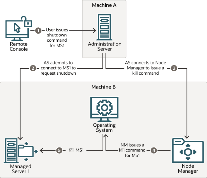

How Node Manager Shuts Down a Server Instance
Figure 1-6 illustrates the communications involved in shutting down a Managed Server that is under Node Manager control. Depending on the state and availability of the Managed Server, Node Manager might need to forcefully shut down the Managed Server. Node Manager cannot gracefully shut down a Managed Server.
Figure 1-6 Shutting Down a Server Instance Under Node Manager Control
Description of "Figure 1-6 Shutting Down a Server Instance Under Node Manager Control"
Through the WebLogic Remote Console, an authorized user issues a shutdown command for Managed Server 1 (MS1).
The Administration Server (AS) attempts to connect to Managed Server 1 and issues the shutdown command directly to Managed Server 1. If the Administration Server successfully contacts Managed Server 1, Managed Server 1 performs the shutdown sequence described in Shutting Down Instances of Oracle WebLogic Server in Administering Server Startup and Shutdown for Oracle WebLogic Server. For the Managed Server to gracefully shut down itself, it must be connected to the Administration Server.
If, in the previous step, the Administration Server fails to contact Managed Server 1, the Administration Server connects to Node Manager (NM) to issue a kill command for Managed Server 1.
Node Manager issues a request to the operating system to kill Managed Server 1.
The operating system ends the Managed Server 1 process.

In managing multiple server instances, Node Manager uses multiple configuration files and outputs log files to multiple directories.
These files are shown in Figure 1-7.
Figure 1-7 Node Manager Configuration and Logging Environment
Description of "Figure 1-7 Node Manager Configuration and Logging Environment"
The following sections describe Node Manager configuration and log files:
Configuration Files
Except where noted, configuration files apply to both Java-based and script-based Node Manager.
Node Manager includes the following configuration files:
This is the configuration file used by the Java-based implementation of Node Manager. See Reviewing nodemanager.properties.
By default, this file is located in
NodeManagerHome
, typically,
ORACLE_HOME
\user_projects\domains\
domain_name
\nodemanager
where ORACLE_HOME
is the location you specified as
the Oracle Home when you installed Oracle WebLogic Server.
nodemanager.domains
This file contains mappings between the names of domains managed by Node Manager and their corresponding directories. See Configuring nodemanager.domains File.
For the Java-based Node Manager, this file is located in
NodeManagerHome
, typically,
ORACLE_HOME\user_projects\domains\domain_name\nodemanager
For the script-based Node Manager, this file's default
NodeManagerHome
location is
WL_HOME/common/nodemanager
, where
WL_HOME
is the location in which you
installed Oracle WebLogic Server, for example,
ORACLE_HOME/wlserver
nm_password.properties
This file stores the Node Manager user name and password. See Specifying Node Manager User Name and Password.
This file is located in
DOMAIN_HOME
/config/nodemanager
, where
DOMAIN_HOME
is the location of the WebLogic domain,
typically, ORACLE_HOME\user_projects\domains\domain_name
boot.properties
Node Manager uses this file to specify user credentials when starting a server instance.
This file is located in DOMAIN_HOME
/servers/
server_name
/data/nodemanager
startup.properties
Each Managed Server instance has its own startup.properties
file
with properties that control how Node Manager starts up and controls the server
instance. Node Manager automatically creates this file by using the properties passed to
Node Manager when the Administration Server was last used to start the server instance.
This allows a Node Manager client or startup scripts to restart a Managed Server by
using the same properties that was last used by the Administration Server.
For script-based Node Manager,startup.properties
file is not
automatically created.
See Setting Server Startup Properties. These properties correspond to the server startup attributes contained in ServerStartMBean
and the health monitoring attributes in ServerStartMBean
DOMAIN_HOME
/servers/
server_name
/data/nodemanager
server_name.addr
server_name
.addr
stores the IP address added when a server instance starts or is migrated. This file is generated after the server IP address is successfully brought online during migration. server_name
.addr
is deleted when the IP address is brought offline. The server IP address is used to validate remove requests to prevent addresses being erroneously removed while shutting down the server instance.
/servers/
server_name
/data/nodemanager
server_name.lck
server_name
.lck
is generated by each server instance and contains an internally used lock ID.
/servers/
server_name
/data/nodemanager
server_name.pid
server_name
.pid
is generated by each server instance and contains the process ID of the server instance. Node Manager checks the process ID generated by the server instance during crash recovery.
/servers/
server_name
/data/nodemanager
server_name.state
server_name
.state
is generated by the server instance and contains the server instance's current state. Node Manager monitors the contents of this file to determine the current state of the server instance.
Do not delete or alter this file. Without this file Node Manager cannot determine the current state of the server instance.
/servers/
server_name
/data/nodemanager
Log Files
Use Node Manager and Oracle WebLogic Server log files to help troubleshoot problems in starting or stopping individual Managed Servers.
Table 1-1 Node Manager Log File Locations
Log File | Location |
Node Manager Log File |
