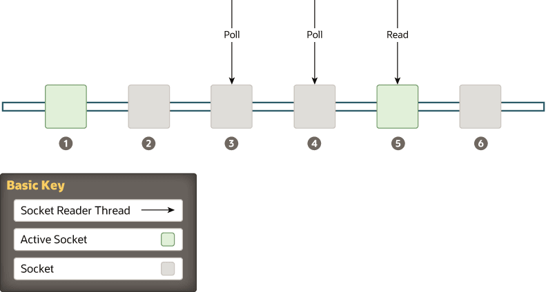

Although the pure-Java implementation of socket reader threads is a reliable and portable method of peer-to-peer communication, it does not provide the optimal performance for heavy-duty socket usage in a WebLogic Server cluster. With pure-Java socket readers, threads must actively poll all opened sockets to determine if they contain data to read. In other words, socket reader threads are always "busy" polling sockets, even if the sockets have no data to read. This unnecessary overhead can reduce performance.
The performance issue is magnified when a server instance has more open sockets than the socket reader threads. Each reader thread must poll more than one open socket. When the socket reader encounters an inactive socket, it waits for a timeout before servicing another. During this timeout period, an active socket may go unread while the socket reader polls inactive sockets, as shown in Figure 5-1.
Figure 5-1 Pure-Java Socket Reader Threads Poll Inactive Sockets
Description of "Figure 5-1 Pure-Java Socket Reader Threads Poll Inactive Sockets"
For optimal socket performance, configure the WebLogic Server host machine to use the native socket reader implementation for your operating system, rather than the pure-Java implementation. Native socket readers use far more efficient techniques to determine if there is data to read on a socket. With a native socket reader implementation, reader threads do not need to poll inactive sockets. They service only active sockets, and they are immediately notified (via an interrupt) when a given socket becomes active.
Applets cannot use native socket reader implementations, and therefore have limited efficiency in socket communication.
For instructions on how to configure the WebLogic Server host machine to use the native socket reader implementation for your operating system, see Configure Native IP Sockets Readers on Machines that Host Server Instances.

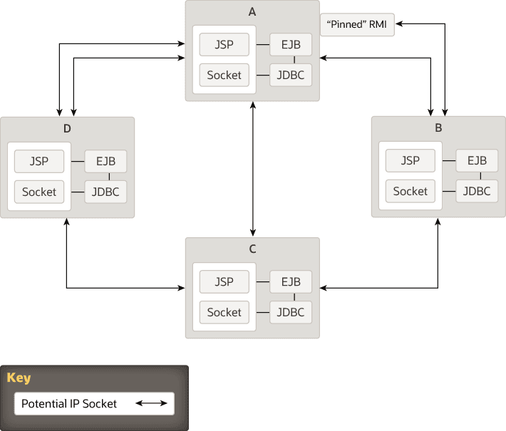

Determining Potential Socket Usage
Each WebLogic Server instance can potentially open a socket for every other server instance in the cluster. However, the actual maximum number of sockets used at a given time depends on the configuration of your cluster. In practice, clustered systems generally do not open a socket for every other server instance, because objects are deployed homogeneously—to each server instance in the cluster.
If your cluster uses in-memory HTTP session state replication, and you deploy objects homogeneously, each server instance potentially opens a maximum of only two sockets, as shown in Figure 5-2.
Figure 5-2 Homogeneous Deployment Minimizes Socket Requirements
Description of "Figure 5-2 Homogeneous Deployment Minimizes Socket Requirements"
The two sockets in this example are used to replicate HTTP session states between primary and secondary server instances. Sockets are not required for accessing clustered objects, due to the collocation optimizations that WebLogic Server uses to access those objects. (These optimizations are described in Optimization for Collocated Objects.) In this configuration, the default socket reader thread configuration is sufficient.
Deployment of "pinned" services (services that are active on only one server instance at a time) can increase socket usage, because server instances may need to open additional sockets to access the pinned object. (This potential can only be released if a remote server instance actually accesses the pinned object.) Figure 5-3 shows the potential effect of deploying a non-clustered RMI object to Server A.
Figure 5-3 Non-Clustered Objects Increase Potential Socket Requirements
Description of "Figure 5-3 Non-Clustered Objects Increase Potential Socket Requirements"
In this example, each server instance can potentially open a maximum of three sockets at a given time, to accommodate HTTP session state replication and to access the pinned RMI object on Server A.
Additional sockets may also be required for servlet clusters in a multitier cluster architecture, as described in Configuration Notes for Multitier Architecture.
