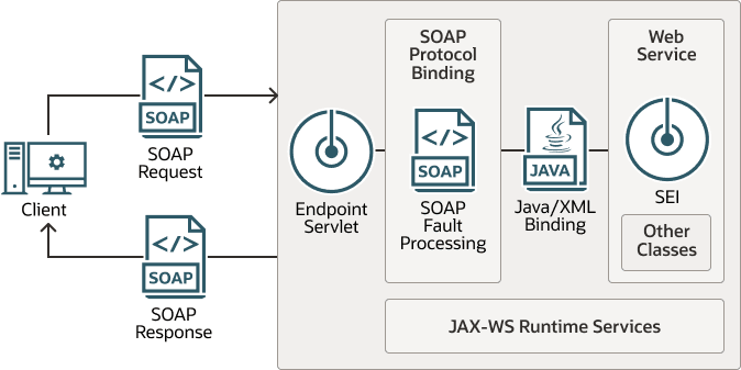

As illustrated in Figure 19-1, JAX-WS handles SOAP fault processing during SOAP protocol binding. The SOAP binding maps exceptions to SOAP fault messages.
Figure 19-1 How SOAP Faults Are Processed
Description of Figure 19-1 follows
Description of "Figure 19-1 How SOAP Faults Are Processed"
