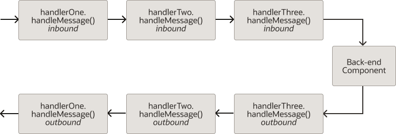

Server-side Handler Execution
When invoking a web service, WebLogic Server executes handlers as follows:
- The inbound methods for handlers in the handler chain are all executed in the order specified by the JWS annotation. Any of these inbound methods might change the SOAP message request.
- When the last handler in the handler chain executes, WebLogic Server invokes the back-end component that implements the web service, passing it the final SOAP message request.
- When the back-end component has finished executing, the outbound methods of the handlers in the handler chain are executed in the reverse order specified by the JWS annotation. Any of these outbound methods might change the SOAP message response.
- When the first handler in the handler chain executes, WebLogic Server returns the final SOAP message response to the client application that invoked the web service.
For example, assume that you are going to use the @HandlerChain JWS annotation in your JWS file to specify an external configuration file, and the configuration file defines a handler chain called SimpleChain that contains three handlers, as shown in the following sample:

The following graphic shows the order in which WebLogic Server executes the inbound and outbound methods of each handler.
Figure 18-1 Order of Execution of Handler Methods
Description of "Figure 18-1 Order of Execution of Handler Methods"
