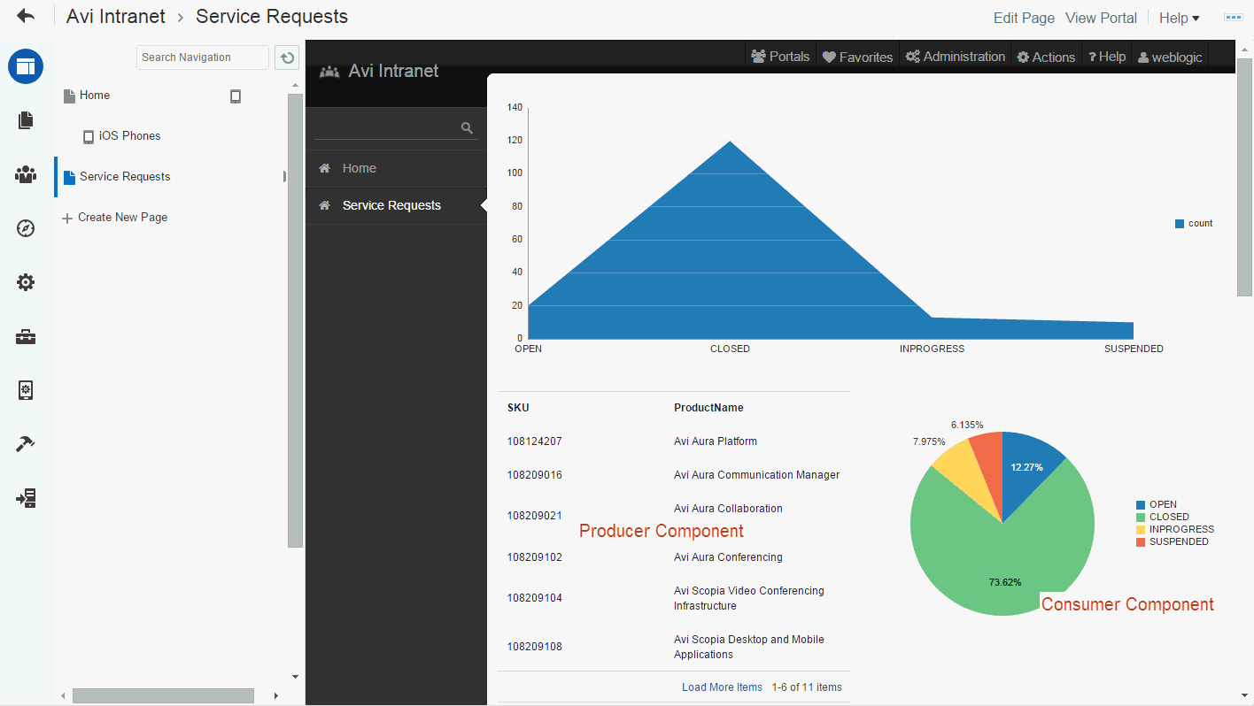

  1. Navigate to the page containing the producer component(s), and open it in the page editor (see Opening a Page in the Page Editor). Figure 13-1 illustrates a Data Visualization task flow producer component (list) and consumer component (pie chart) in the sample AviIntranet portal.
    Figure: Producer and Consumer Components

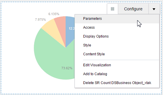

  3. Click the View Actions menu icon on the consumer task flow or portlet, and select Parameters. Figure: View Actions Menu on a Consumer Task Flow
    Description of image follows
