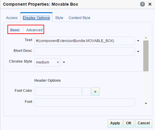

showDetailFrame Component Display Options
The Display Options associated with showDetailFrame are common to many components and are listed in Table 10-1 with one exception: the showDetailFrame layout component does not expose the property Allow Child Selection. Refer to Table 10-1 for recommendations related to Allow Resize on the showDetailFrame component.
Though it is not obvious in the page editor, the showDetailFrame component is usually wrapped around task flows. Consequently, the Display Options dialog for task flows, and any other component wrapped in a showDetailFrame, share the same Display Options properties.
When you display the properties of a showDetailFrame component in Structure view (Setting Component Properties in Structure View). the Display Options are presented on two subtabs: Basic and Advanced (Figure 12-3).
Figure: Basic and Advanced Display Options for showDetailFrame Around Movable Box Component
Description of image follows
