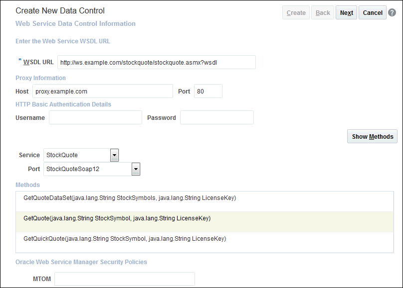

Click Show Methods to establish a connection to the web service using the specified WSDL and display the methods available for the web service.
From the Service drop-down list, select the service to use for the data control.
From the Port drop-down list, select one of the available ports.
The Methods field displays the methods available for the specified web service.
All methods under the selected port are added to the data control. These methods are later available for selection in the resource catalog.
Figure: Adding Web Service Methods to a Data Control
